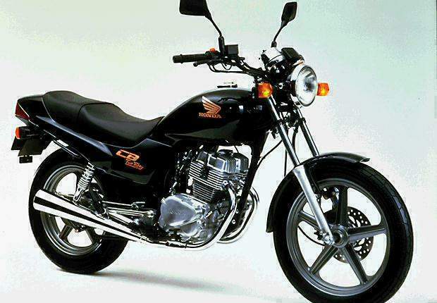

I've been having a look at my frame, and thinking of ways of cleaning it up a bit.
This is what I have (stock image of a 91, mine is a 98 and a bit rough around the edges)
Here's what I'm thinking.
Cut and loop as indicated by my fantastic paint skills. I would have a steel rear guard and new front guard made up. Indicators replaced with short flat black bullet style.

For now I plan on using the original tank, its not that ugly and with the original seat pan it would have a reasonable amount of flowing lines to it.
Here is one done Cafe style using the original tank but an aftermarket seat. I'm hoping for a more flowing look with the seat, and I plan on making covers over the battery/airbox until I get myself a second motor to rebuild in my downtime. Then I'll do the whole pod filter, cleaned up electrics etc and probably change the tank/seat combo for a more retro look (unless I love the way the mach 1 version turns out)
Any advice/cheers/jeers would be appreciated

Pics are working....I always used to eyeball the Honda Nighthawk 250 and think to myself: "This thing would make a cool little cafe racer or street tracker if done properly. I see your vision and look forward to seeing where this goes...
i just bought a '86 450 hawk. Im not a huge fan of the way it looks, and I want to do something similar to what you're showing in your examples. The biggest thing I've noticed is that the frames aren't "flat" from front to back. Thus, you get that little dip in the middle... So, the bike just looks a little bit too "curvy" to me... I want the bottom line of my tank to go straight across to the back.. So its looking like I'm going to be finding a tank i like, and then doing a lot of fiberglass work for a seat pan.

well that's garbage........... sorry man. I have found myself looking at those tanks and figuring ways to make them work; especially as a tracker...
