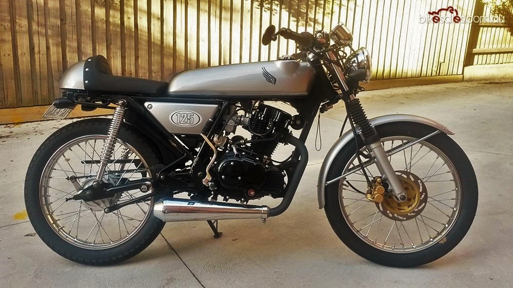

id recommend a peashooter exhaust. I love mine, performance is a bit better, but it makes the engine sound just beautiful :)

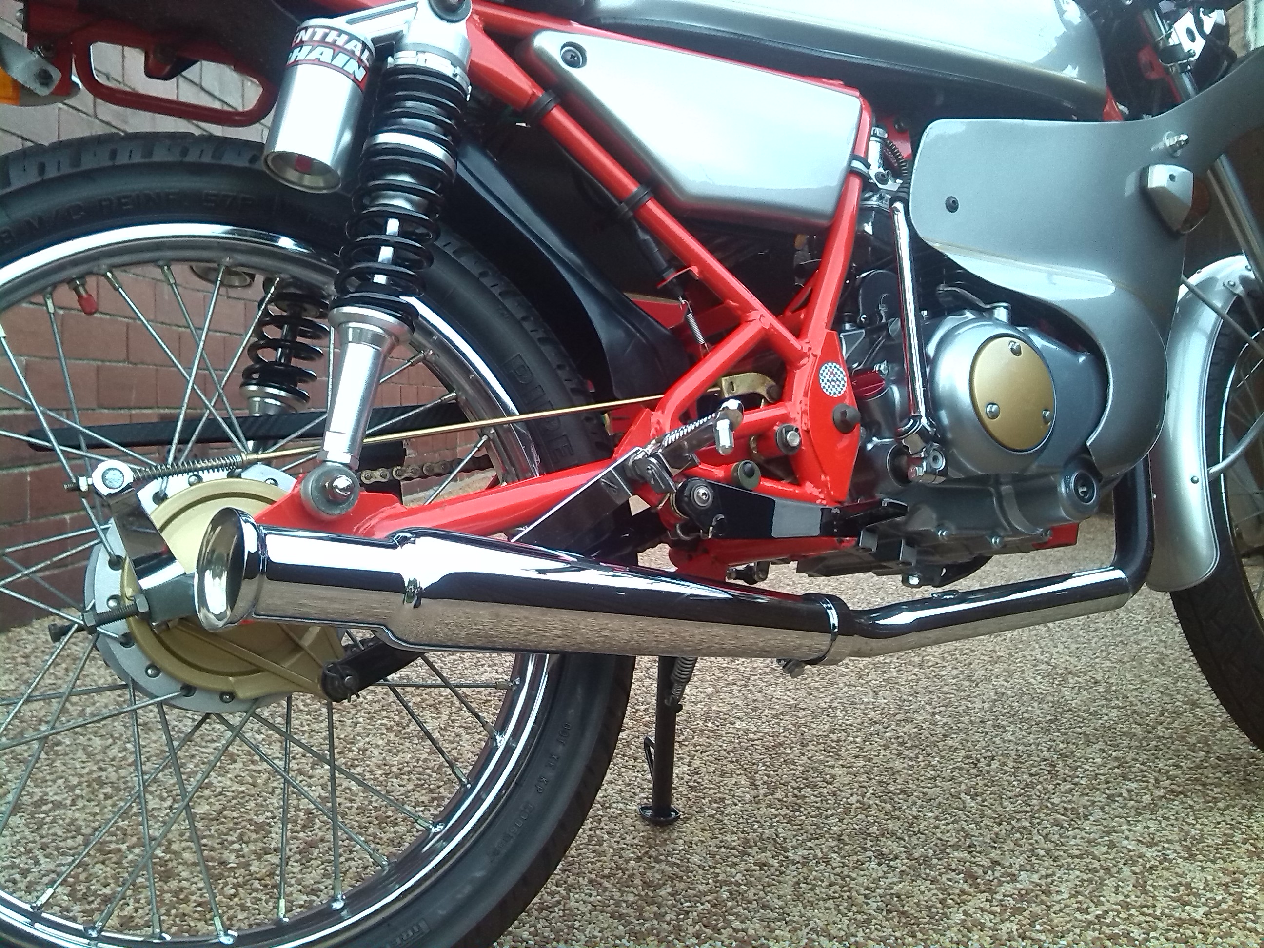

Hi again, not posted anything for ages. So, I've got around to fitting a new silencer to my Ace and thought I'd show what it's like.
The one I have gone for is a Tulip type. It does come with what they call a baffle, but it makes very little difference at all.
So what I have done is to modify the baffle to be adjustable. I will post photos of this later as I have just fitted it and wanted to try it.
The chrome pipe between the silencer and down pipe is an old down pipe of some chopper that my mate had kicking about, it is a good push fit onto the standard pipe.
Thank, Tad.
PS, I tried to add a video of it running but file was to big. So I have put it on Facebook page of Skyteam Ace 125,250 and 50cc if interested.

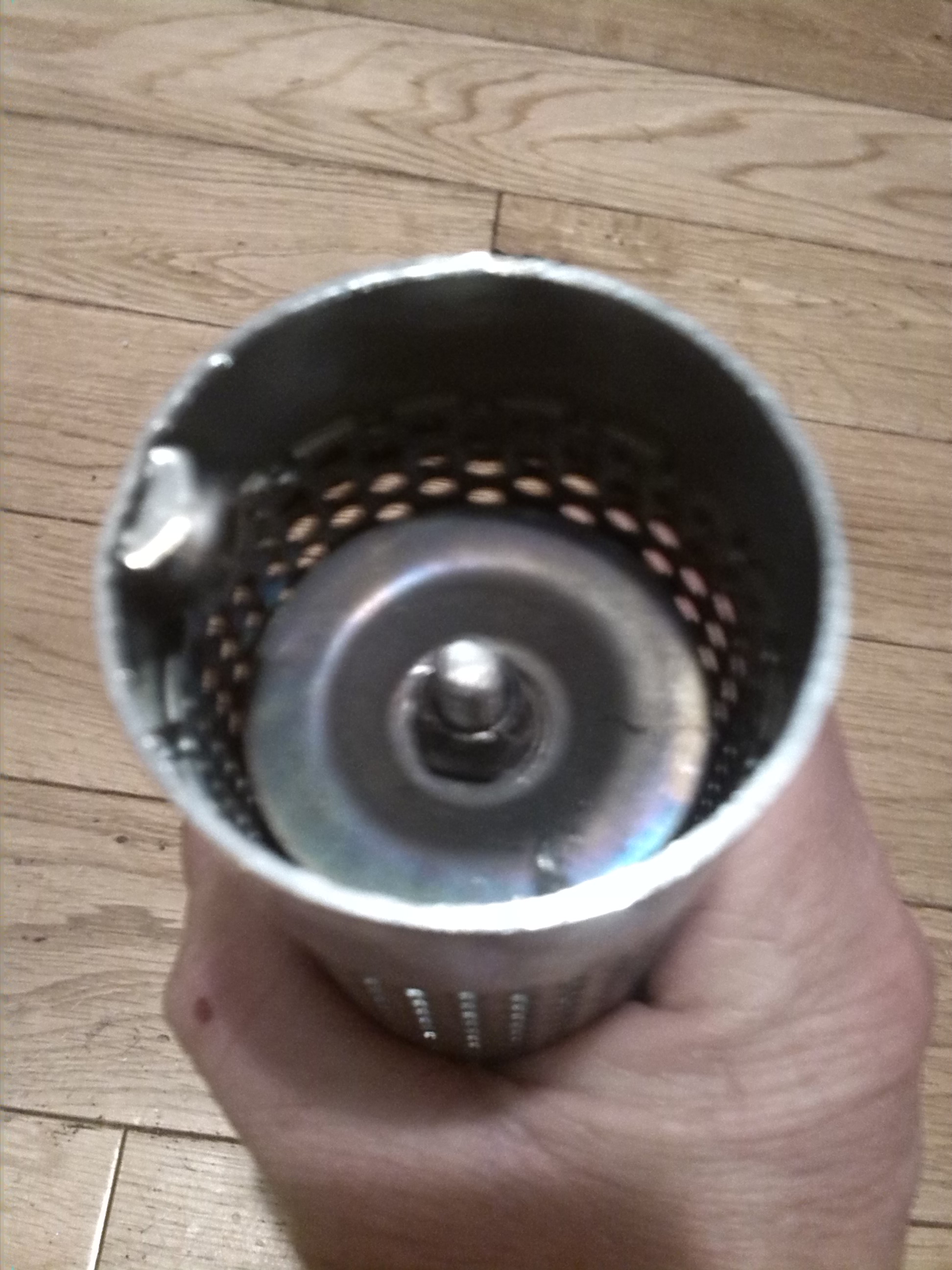

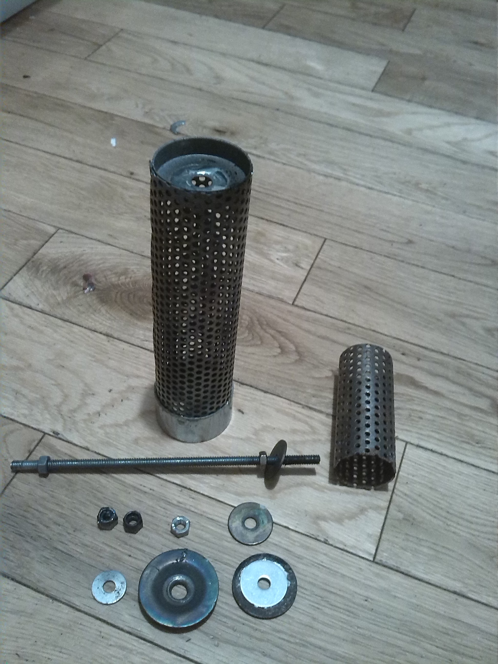

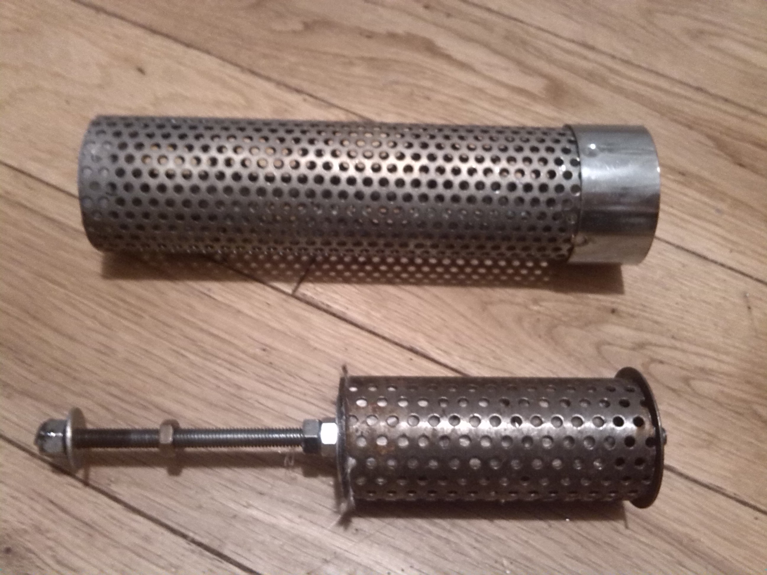

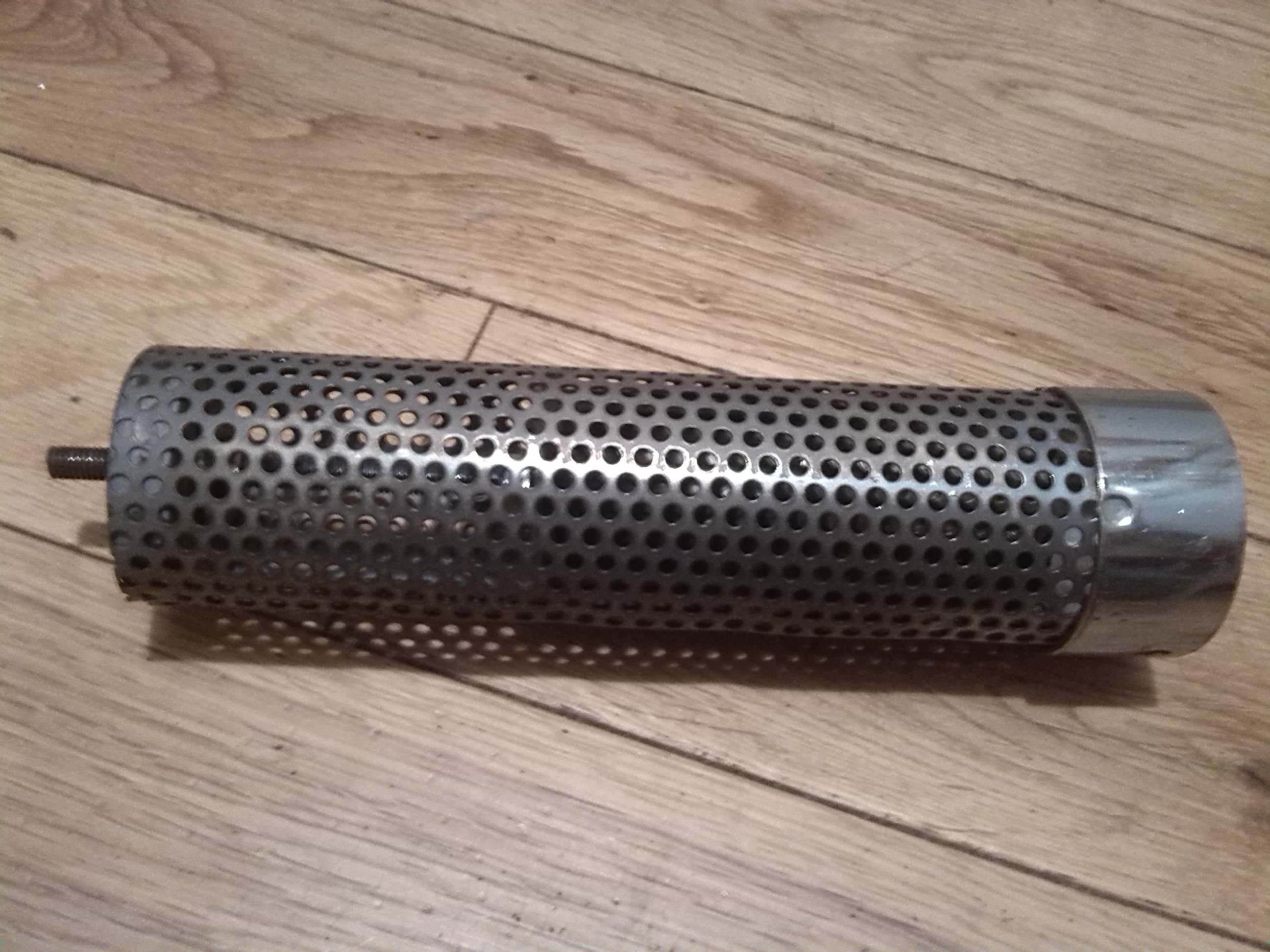

Here is the adjustable baffle that I have made. The photos show what parts I used, Main baffle that came with silencer, 6mm threaded rod, small length of baffle tube (smaller than main baffle), wadding and a selection of 6mm nuts and washers.
When the inner baffle is assembled with wadding wired in, it can then be inserted into main baffle and adjusted back and forth with lock nut at closed end. This has to be done with main baffle removed from exhaust
The exhaust is a lot better on the ear now and can easily removed and altered to suit.
