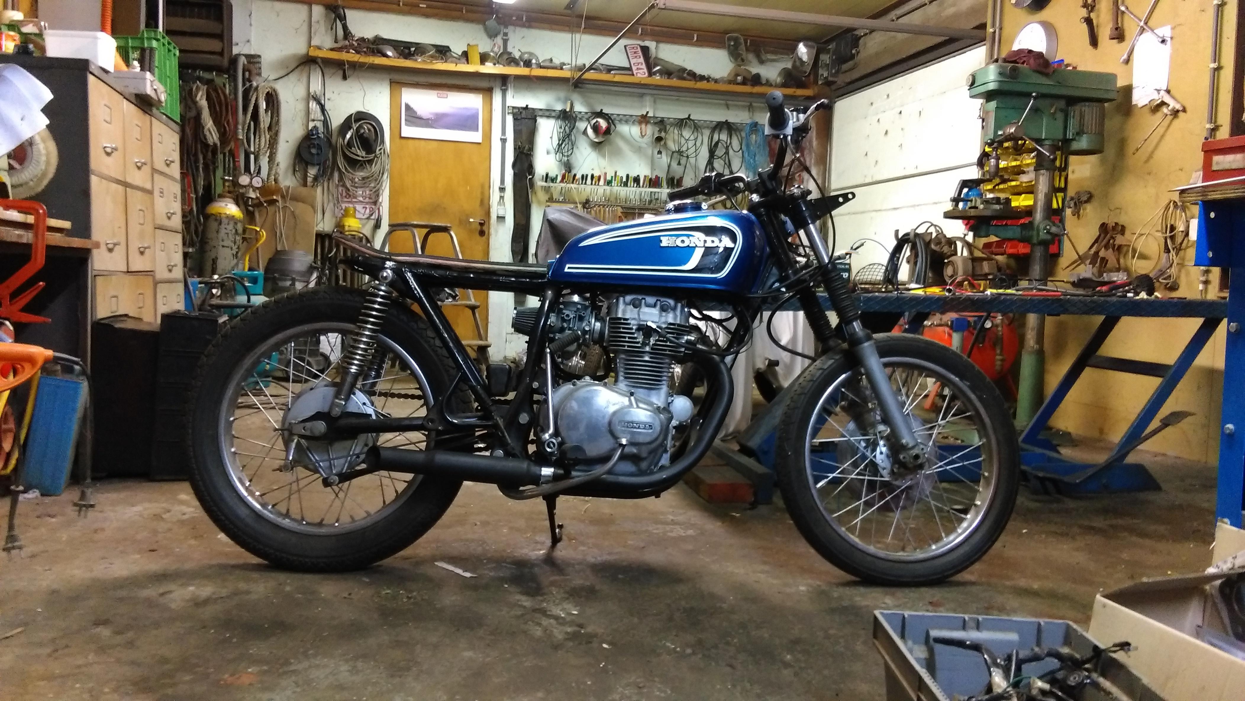

CB360 after a little week, now facing the electrics and wiring. Any of you guys have advice?

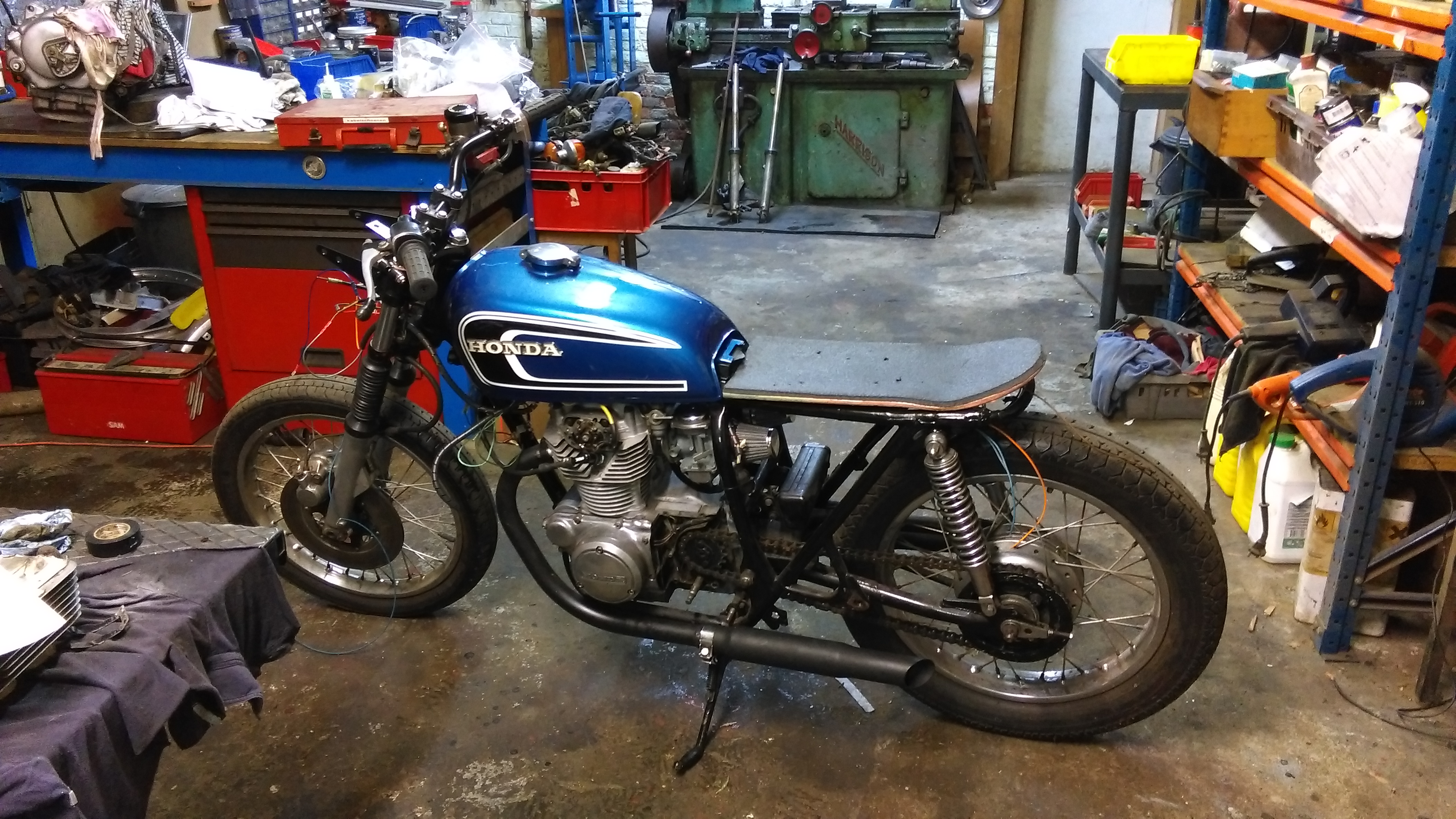

new slash cut mufflers installed, wiring is getting fixed and installed some "cat eye" indicators

My advise, re-install air boxes/filters, front & rear fenders, original mufflers.  Give her a proper tune up and ride.

Buy a sparck moto loom and rock on mang.
+1, along w a sprackmoto R/R.
Remove the improperly fitted gators.
Download and read Workshop manual
Clean up & service OR replace.
all brake pads
wheel bearings
stem bearings
forks, fork seals and fresh oil
tires, tubes, strips, spokes, straighten and balance wheels
control switches, throttle sleeve and all cables
swing arm bushings
Replace rear shocks w better than oem, proper for the bike.
chain/sprockets
check compression
adjust cam chain tensioner, valves, engine oil, spark plugs, points, clutch
clean carbs and inspect all internal parts, insulators/gaskets
exhaust leaks
clean tank/tap
repair/replace air filters, rubber parts assoc w filter boxes
electric starter
test charging and ignition system.
Paint it the color of your choice.   ;)

Nah man, ain't gonna work for me :) already installed pod airfilters now searching for the right jets.
