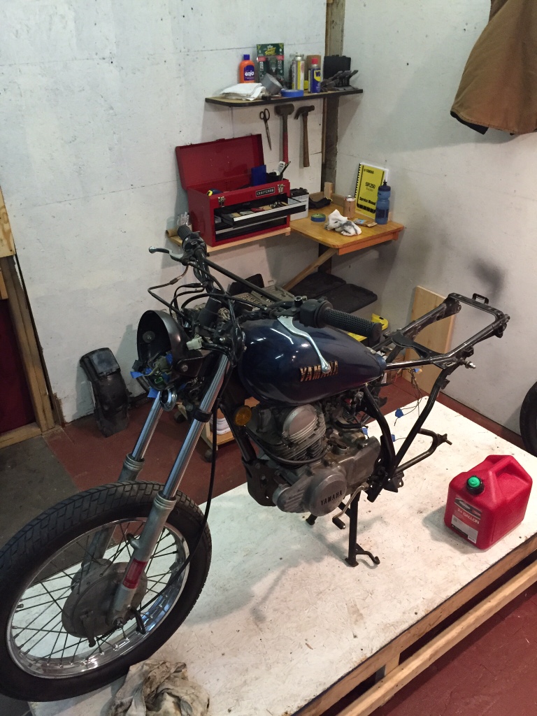

Here she is the day I brought her home.
I removed the sissy bar, engine guard, and swapped handlebars and this is the way I rode it until bringing it in for the winter.

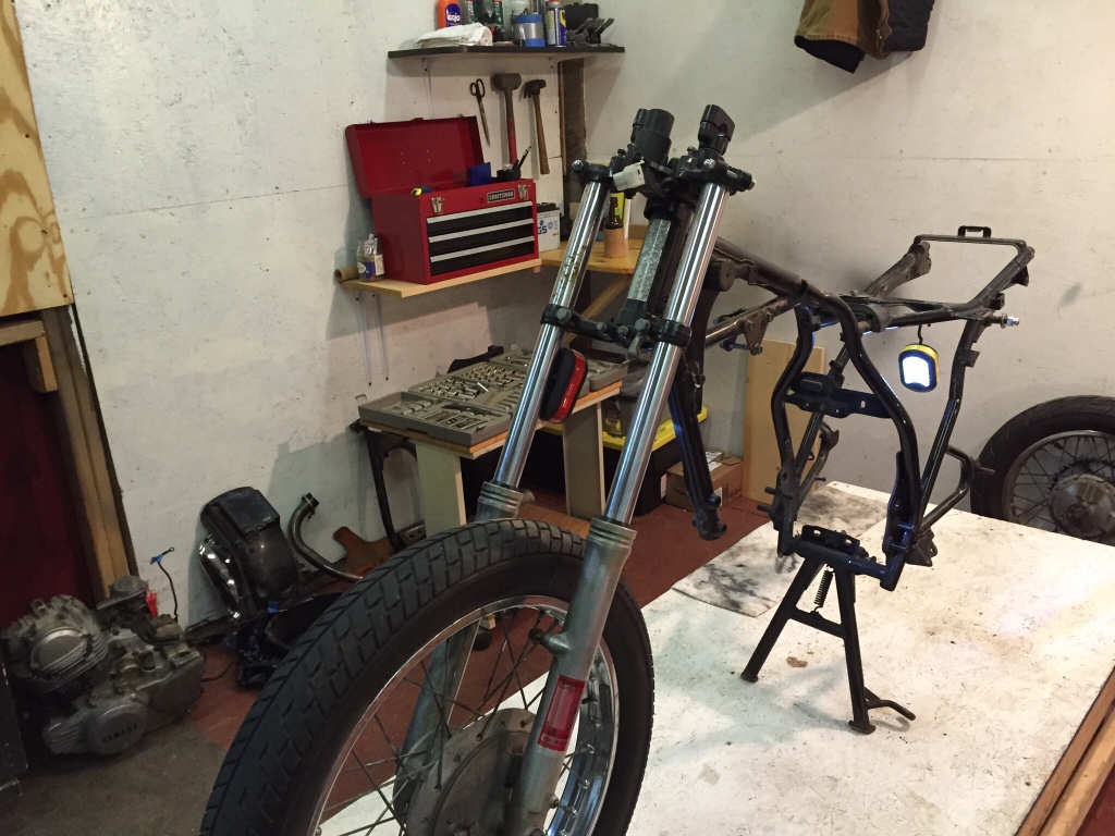

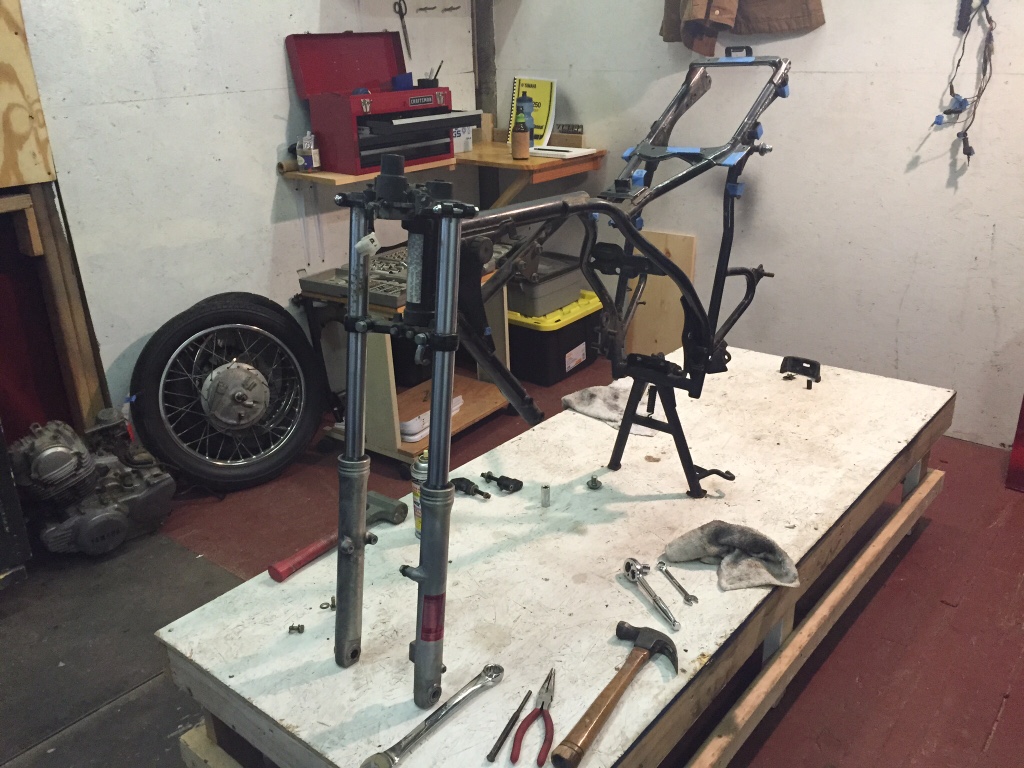

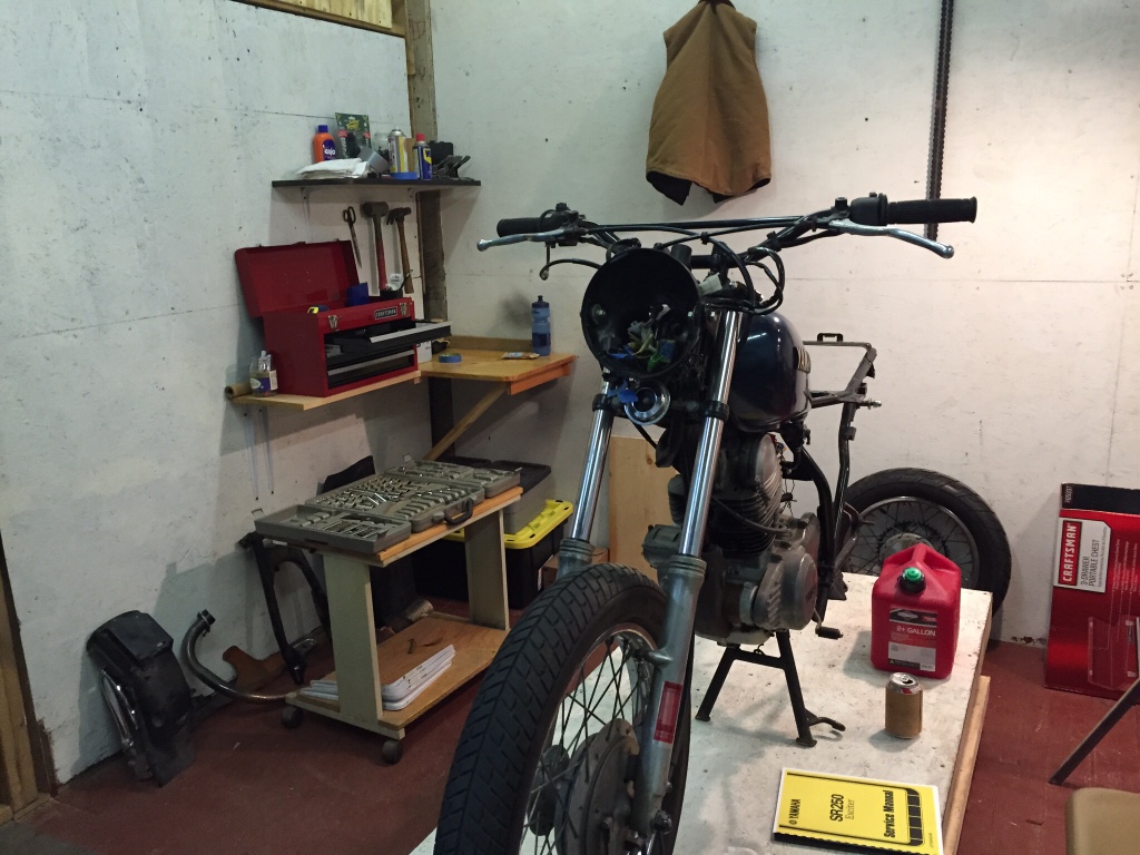

I'm renting a corner of my friend's shop for the winter. I put together a bench and have set up a little workstation. It's a humble space but it's serving me well so far.
Some photos of the initial tear down.

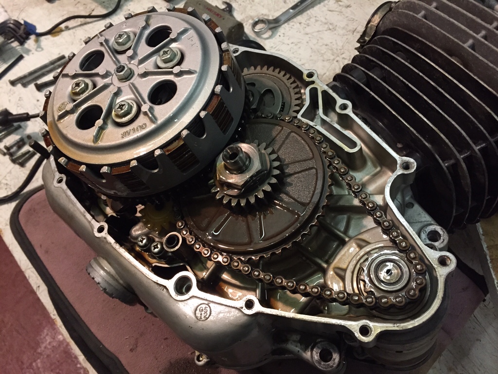

The first thing I did was peep around at the engine.
For the most part things look pretty good to me. Cam chain and valves seem clean. Although I guess I ought to measure the cam chain. No sediment in the right side. The left side at the drive sprocket was of course all gunked up so I gave that a thorough cleaning.
As I mentioned before the bike ran well so I don't have any major plans for the engine at this point. I would like to find a spare motor to mess around with and sort of pimp out. That way I can get the bike up and running with this engine and then just do a swap when the time comes.

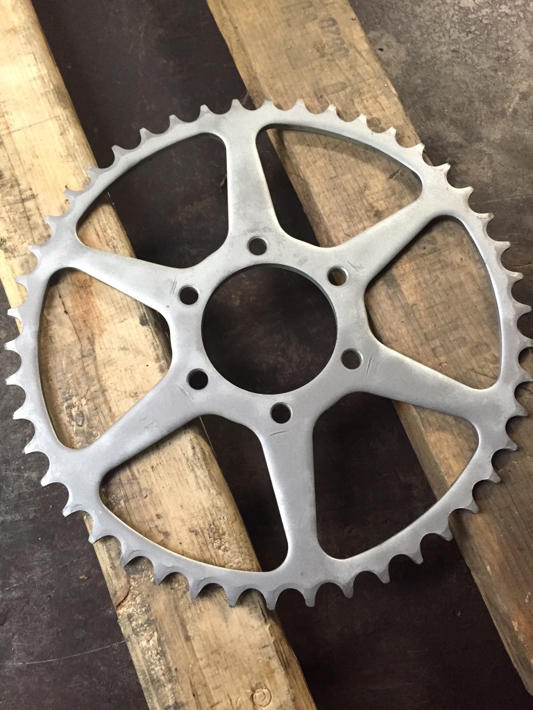

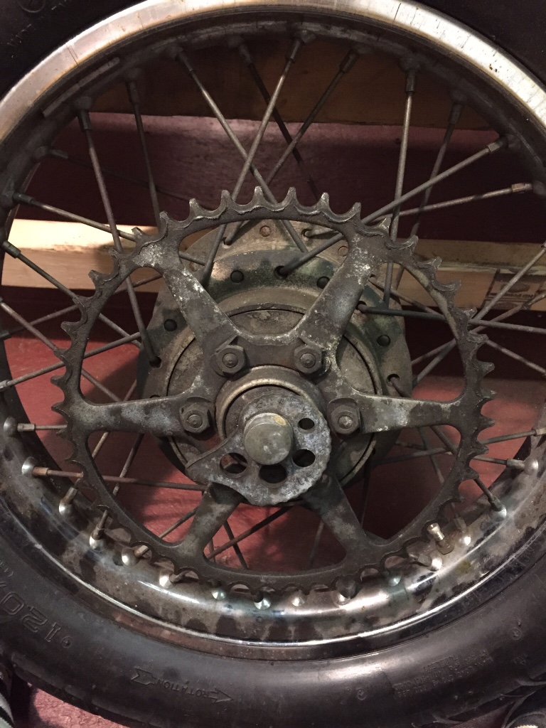

My current task at hand is cleaning and painting everything. I blasted the rear sprocket in a media blaster we have at work. I've since blasted a bunch of other small parts and they're coming out great.

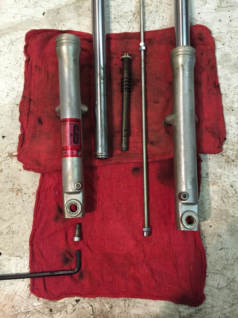

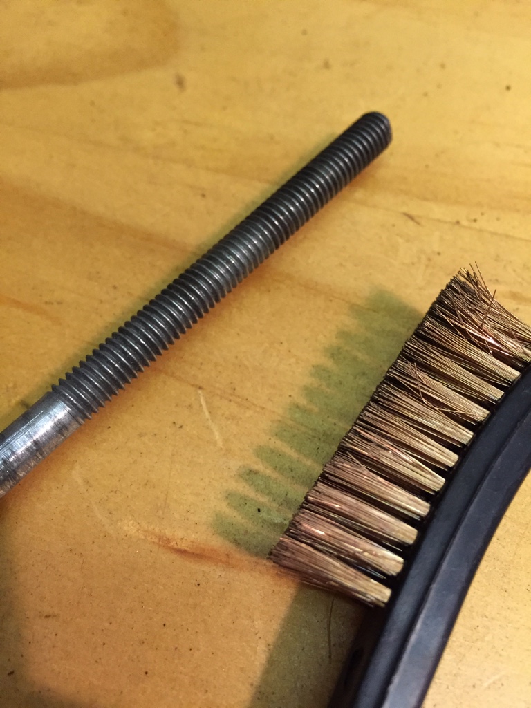

My first bit of learning that could benefit a noob like me. Disassembling the forks. This is an area where the service manual failed me. Before removing the spring caps, loosen the 8mm bolt at the bottom of the fork legs! This bolt threads into the bottom of the damper, and removing it is what allows the tubes to separate. The damper has a 12 point 14mm female socket in the top of it. This is what you need to hold in place to remove the 8mm bolt. However it is about 18 inches inside the fork legs, and who has a 14mm Allen key that long? By loosening the bottom bolts before removing the spring caps, the springs create enough tension on the damper to allow you to get that first *crack*. In my case I had removed the springs first and the bottom bolts just spun along with the damper inside. So my solution was to make a tool with threaded rod and nuts. The damper is a 14mm, but if you've shopped one of the big American hardware stores you know metric is hard to find. So I got 4 3/8" nuts and a two foot threaded rod. Put two nuts (hehe) at one end of the rod and firmly tighten them against each other. Slide the rod into a fork leg and put the other two nuts just above the tube. Tighten them against each other. Now you need to grind the bottom nut because 3/8" is slightly larger than 14mm. I ground mine carefully on a bench grinder. Now you have a tool to hold the damper on place so you can loosen the bottom bolt.
PS - Removing the spring caps on these forks is a real PITA too. I didn't get any pictures of that but I will try to remember to do that on reassembly.
