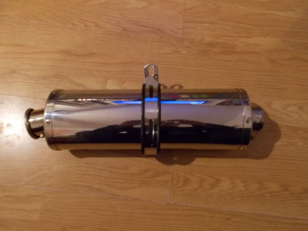

Polished the supplied silencer.  It was an easy win, and a good place to start...

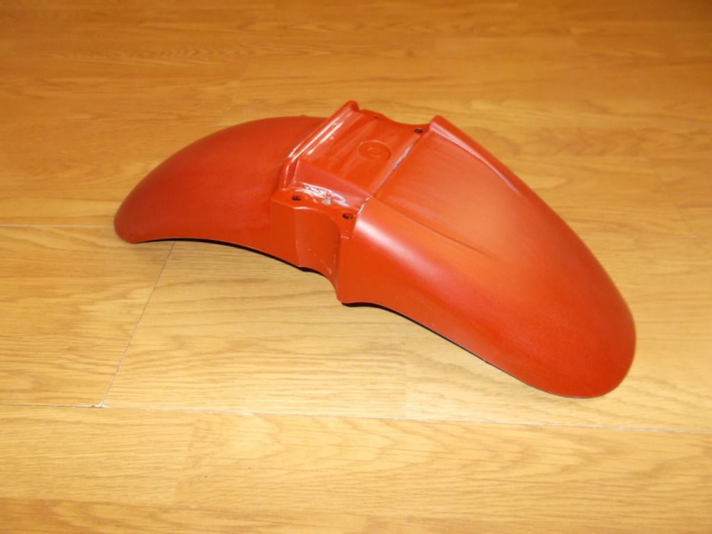

Front mudgard/fender bobbed about an inch off either end, and prepped for paint.  Can't bob such things too much over here of when one goes for the MOT (annual government roadworthiness inspection) the tester gets angry and is liable to foam at the mouth and not offer you a cup of tea while you wait...

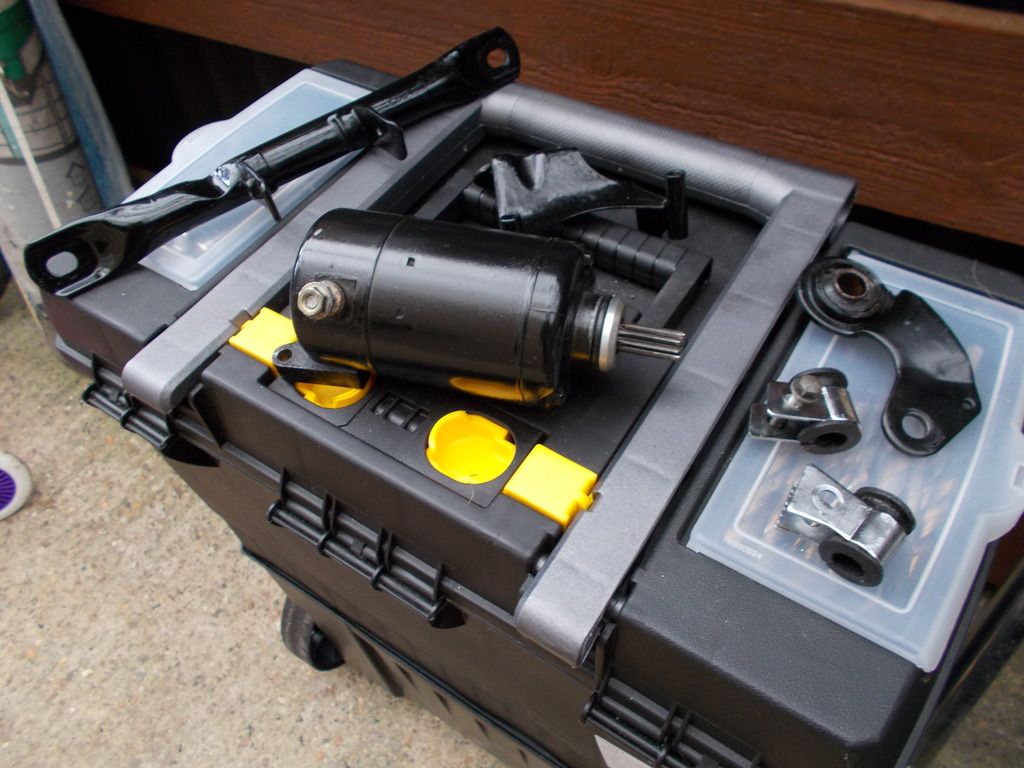

Next I broke out a can of gloss Hammerite smooth, roughly equivalent to your Rustoleum, and attacked the starter, fuel tank stay, and exhaust collector hanger...
Then did the same to some engine mount spacers, clip ons and clutch lever...
