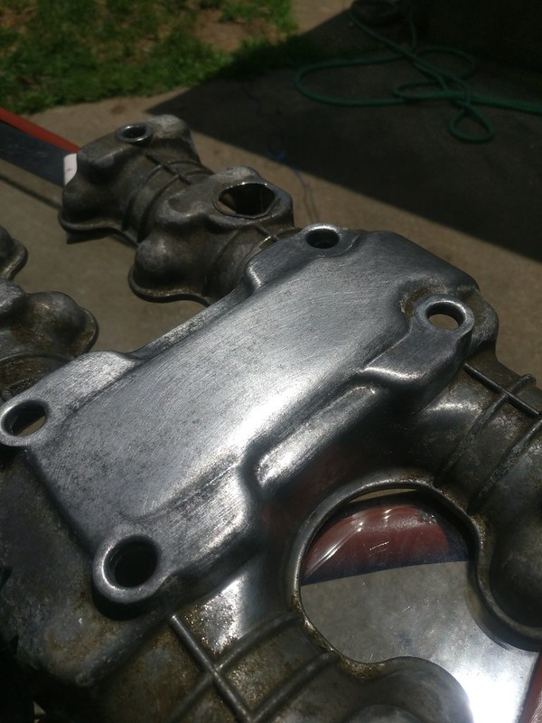

Motor is out. Started cleaning today. I think the 3M pads I got are a little too abrasive. Planning on painting the motor anyhow so not too worried.

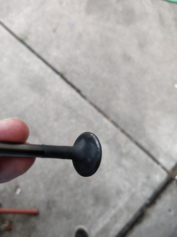

Valves are out. I'm new to rebuilding, but I think the valves are in fair shape. I need to clean them up, especially the exhaust valves. Photo of the intake valve is after about 3 minutes with a hand held wore brush.
Exhaust
Intake

Still searching for an easy way to clean up all the parts for paint. No access to a soda blaster and simple green seems about as effective as plain water.
Take the top end apart, spray it with purple power, and blast it at a car wash. Bottom end will have to be washed by hand, unless you are splitting cases.
Heard purple power is too caustic for aluminum? How long should it sit? Will it remove corrosion or is scrubbing/blasting the only way.
