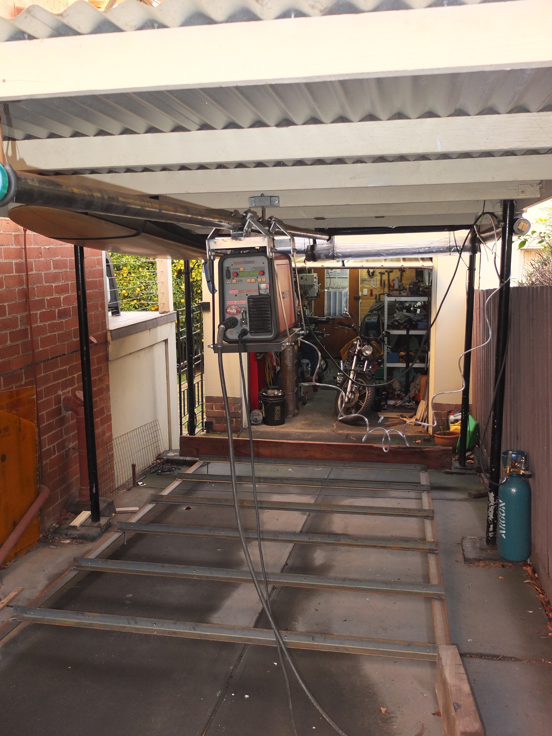

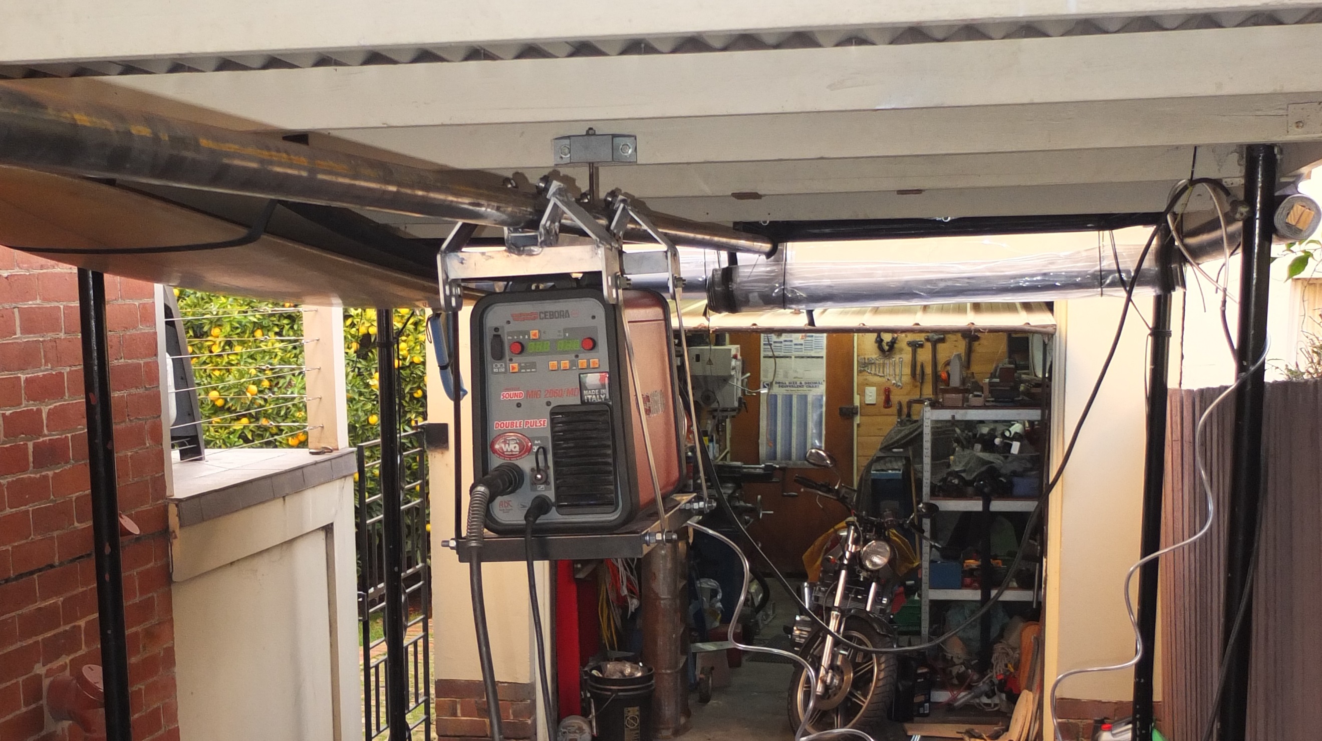

The Cebora Synchronous Double Pulse welder is being suspended on a 60mm tube rail 5m long. I made up a carriage with 4 ball bearings as rollers. By using the rail system I can easily weld anywhere on the hull with the standard 4m mig gun. The other option is $1000 push/pull gun.

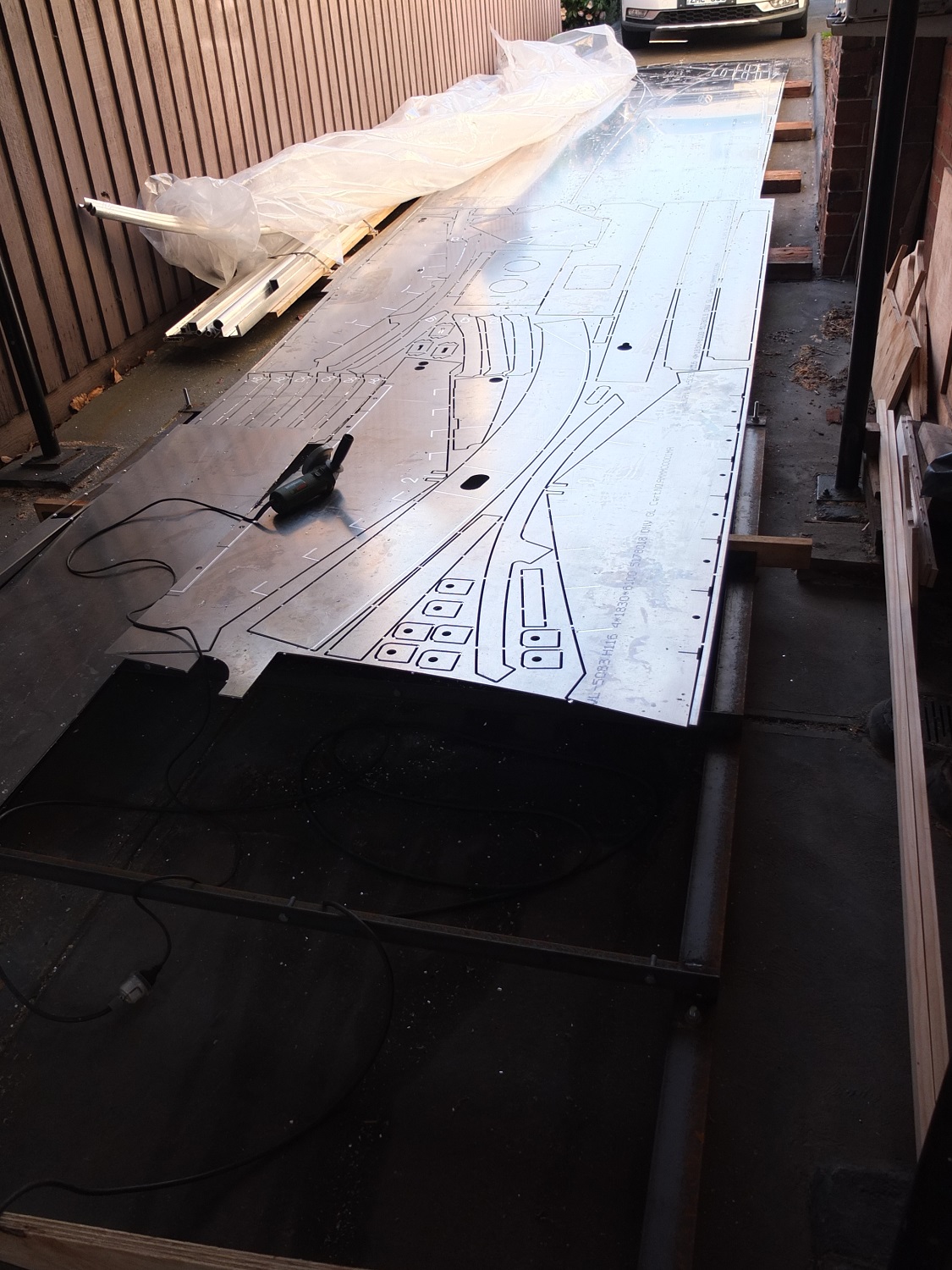

The kit arrives next week, all the plates are partially cut out of 6m sheets of 5083 aluminium using a NC router.

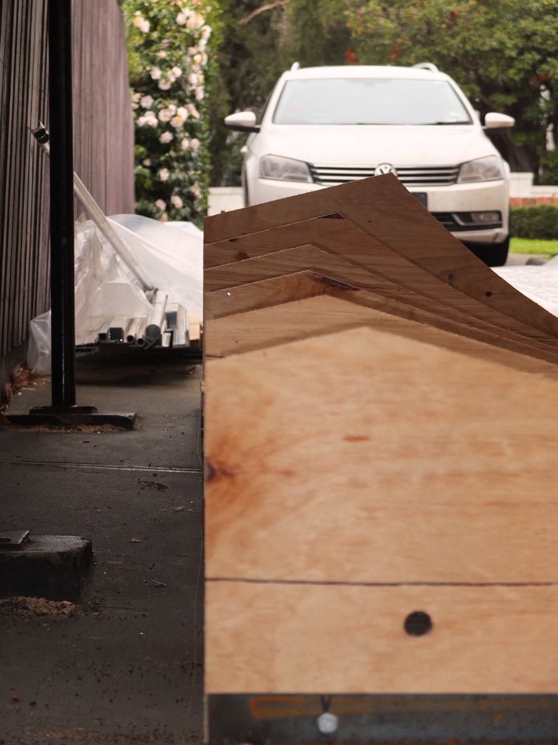

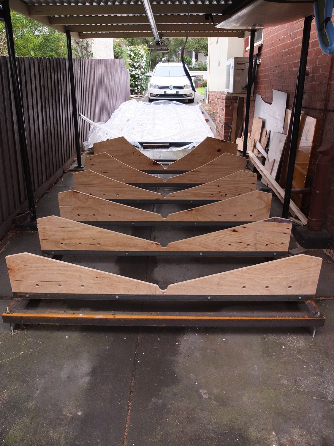

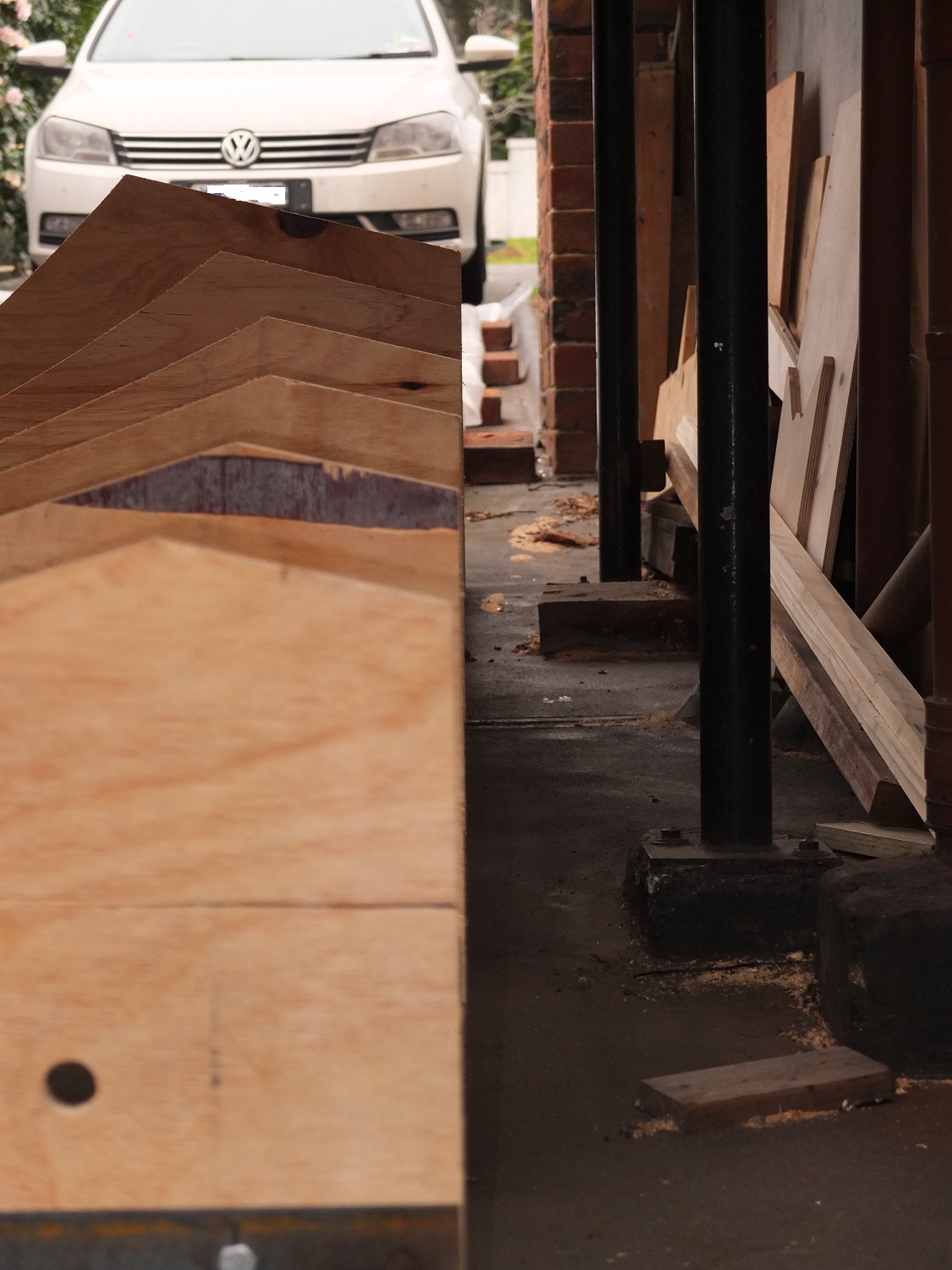

The weather was not kind to me this weekend, Saturday afternoon was a right off, wild, wet and windy. Managed to setup the plywood forms onto their stations. Made sure that they went on square by measuring the diagonals. They have lined up well, edge to edge and through the dowel holes. The photo through the dowel holes shows them all lined up through all six stations.
Sunday was spent cutting the pieces out of the 6,100mm X 2440mm alloy sheets. Each piece has its profile cut by a NC router, but there are small tabs every 400mm holding the piece in the sheet for delivery. Took all day to cut out all the parts and then clean up the edges.

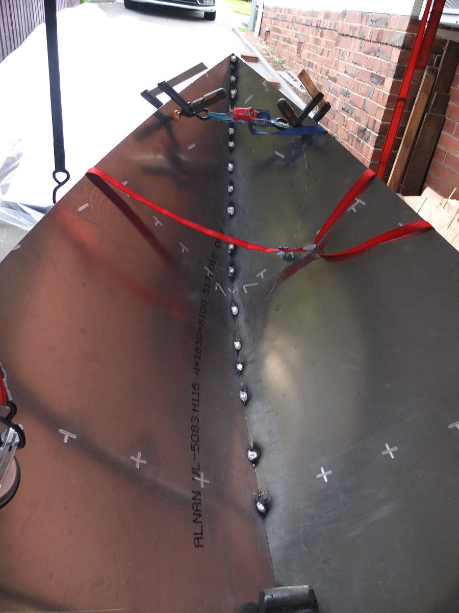

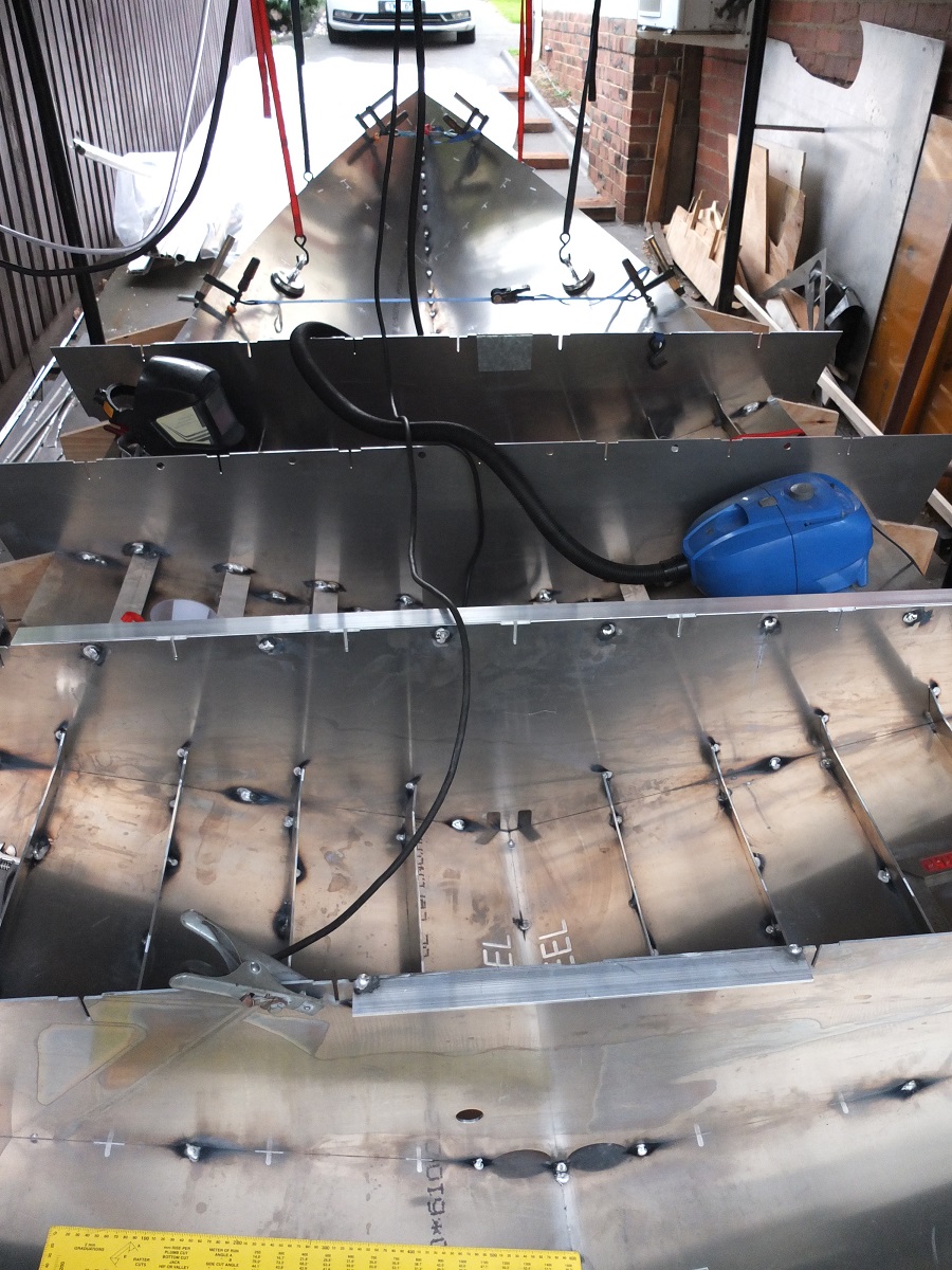

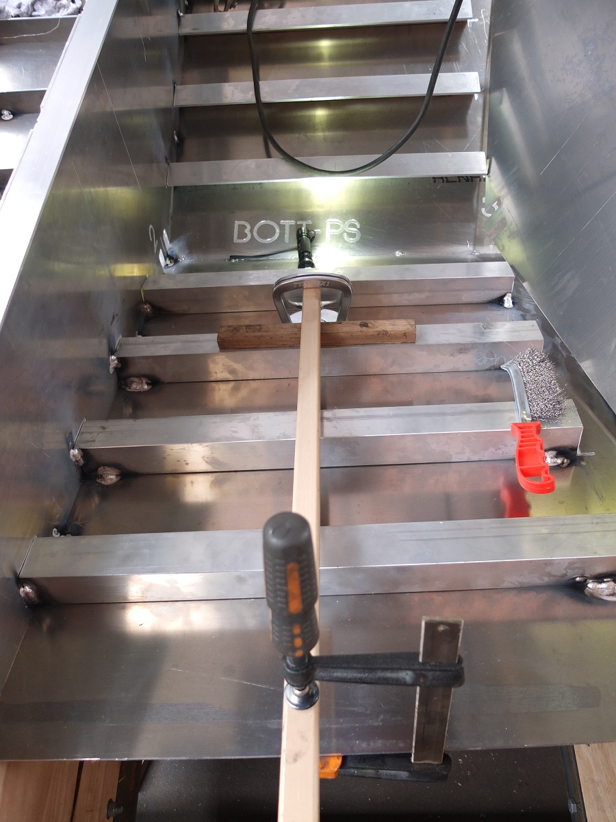

Pretty happy with the progress from the weekend. I have learnt to appreciate ratchet straps, basically pulled it into shape with ratchet straps before stitching it with the MIG. Amazing how accurate the NC cut panels go together.

I am glad I spent the extra cash to get a very good quality Sychronous Pulse MIG welder. It enables a novice to do this. I do check the penetration of the weld set up, by welding off cuts and cutting sections.

Progress was frustrating. I though I would do the right thing and blow out the torch liner to make sure the feed was smooth. All I did was block it up solid. Guess that is one of the risks of buying second hand and not knowing how it had previously been maintained. In the end I just went and got a new liner, there was no way I could remove the blockage.
It took me a while to feed the new liner into the torch. I tried from both ends, and was successful by feeding in from the torch end.
I ended up tacking in 2 bays of stringers and frame #5. What I did get done, went together very well. The scribe marks are all lining up. Weather is not forecast to be any better tomorrow, see how we go.
