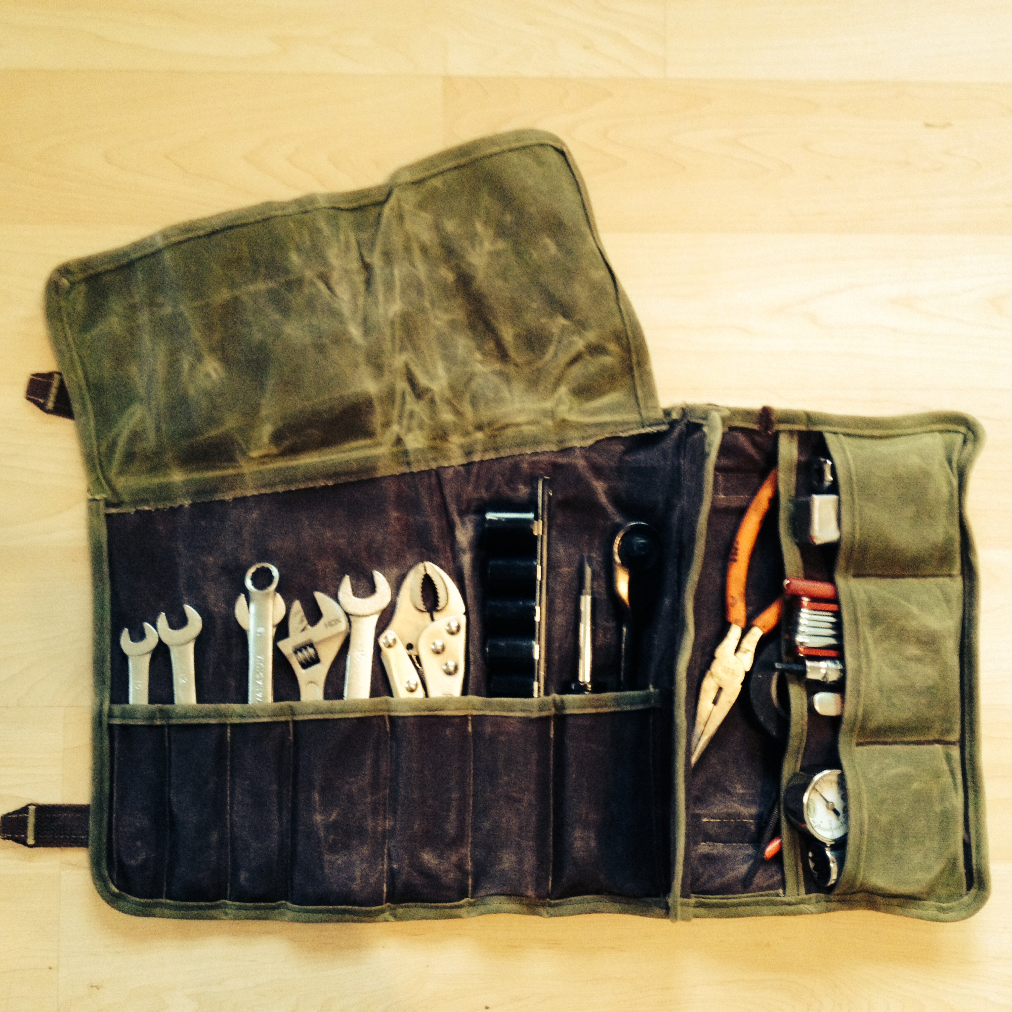

I've Been working on some designs for shop aprons and tool rolls, here's a finished sample of one of the aprons.
All of the hardware is solid brass, the canvas and webbing (strap) are 100% cotton, has an upper pocket that will accommodate most cell phones (including iPod 4 and 5) or your safety glasses, a large lower pocket will fit an iPad / tablet, there are two mini pockets for small items like nuts and bolts, the upper straps are crossed to keep them off your neck, lower back strap has a brass clasp that attaches to a D-ring.
I'd definitely love to hear your constructive criticism, features you'd like to see...
