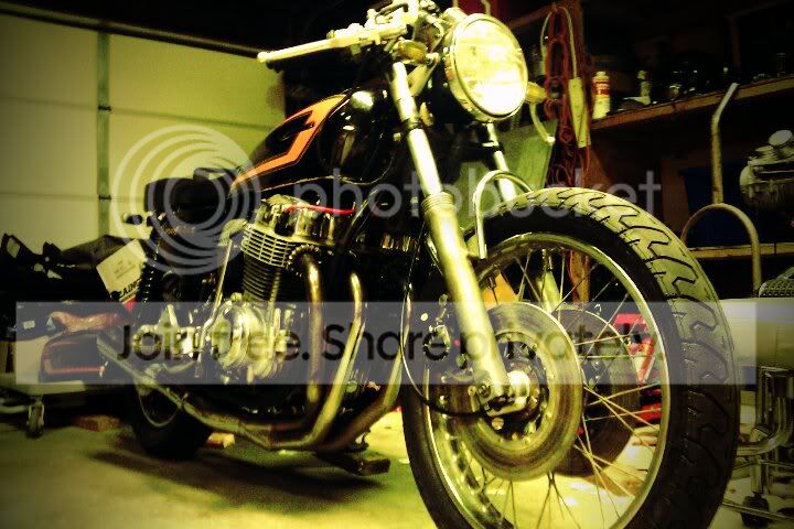

Heres how it sits now, (pretty much)

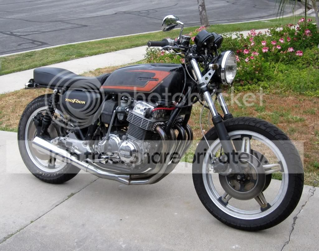

Before
After
A step in the right direction. More to come.

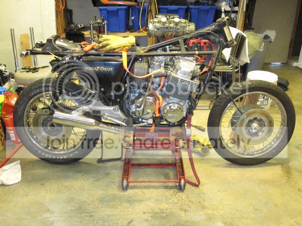

Made a little progress today, while the baby and wife were napping.
May I ask how you installed a spoke wheel with the rear disc brakes? I was thinking of doing the same with my '78
You need to find a 75-76 cb750f rear wheel, its an 18" rim, same width and with a disc. If you use the sprocket carrier from your wheel, you dont need to modify any spacers. I found and installed a 77GL1000 front end with wheel and all. Start searching Craigslist buddy ;)

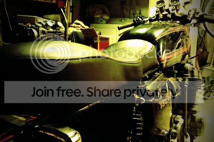

What do you guys think?
I raised the fork legs in the trees to see how much I need to lower the forks. Looks good to me. Its about three inches, so i'm thinking 2" internal and 1" up in the trees. This leaves me with 5" of travel under the lower tree. What do you guys think?

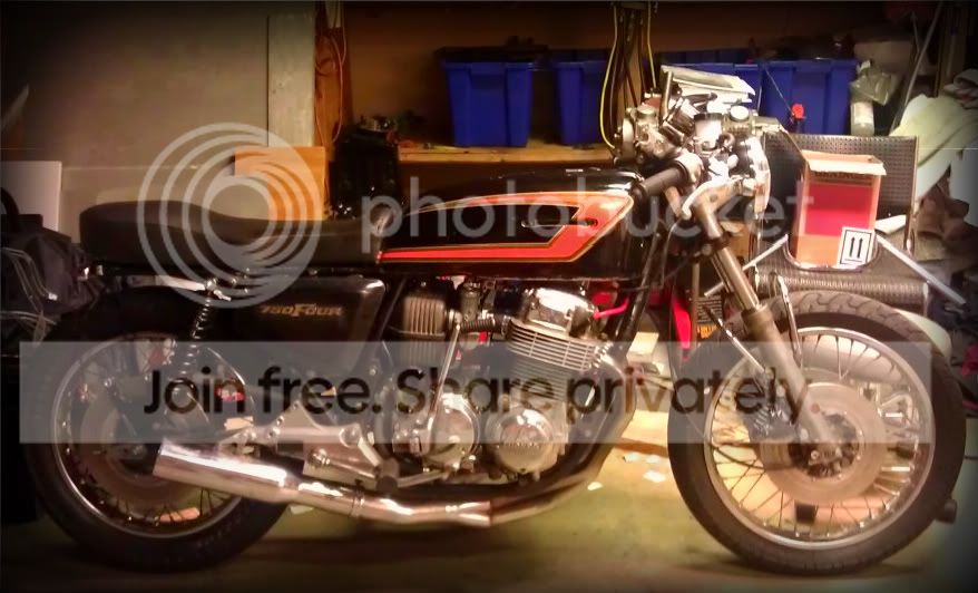

Thanks guys. I think I'll keep it, haha. The exhaust will definitely help with the looks and tuning 8)
It finally feels like I'm making some good progress.

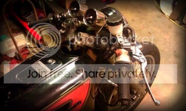

It's been a while since I posted here. I added Tomaselli Commander clip-ons and a tank with better paint. I got the bike assembled and running, then found the rear wheel was way out of true. I asked the shop that replaced the tires to check if it was true ??? . I trued the rear wheel at home and re-installed it. The rings must have finally seated, cause this thing takes off like a rocket all the way to redline. There is a slight headshake on decel, so I have a few things to check, but all in all its a blast to ride! Here are some pics.
A little update. i switched out the Cycle X ignition, for Hondaman's ignition (SOHC4), because I like the idea of being able to disconnect it and go back to point & coils operation if the unit quits on me, plus its got warranty. Tightened the head bearings. Trued my front wheel, which was way out, and found a bent spoke or two. The thing doesnt want to get trued, so i will be switching over to my GL alloy front wheel and probably re-lacing my rear hub to the GL rear rim. I dont have money for new spokes, so it's gonna be another budget build. I'm picking up a another MAC exhaust, that has the correct port mounts for the early CB750 head and is also Black, which is nice. More riding and tweaking to come.
