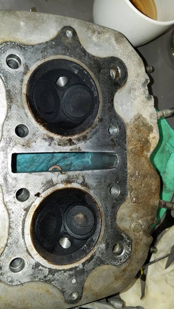

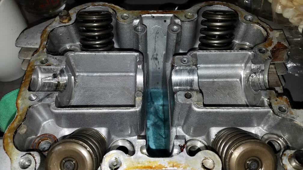

Had a small leak in the head gasket. Not hi ing mayjor. Figured mine aswell change the gaskets. All the good stuff. Well lastnight didnt end well, pulled the points and associated parts off pull the cover off. Found the cam has been digging into the cover rocker arms have some decent wear. Kept going. Pulled the head off found even more damage pulled the jugs off. One slipper is broke in 2 peices. (Front) took thebrear out shows decent wear. Never had any noise at anytime. So now im down to pistons and case in bike. Any ideas where i should go from here? Attaching pictures of everything. Any help and or suggestions would greatful
New head, cam, and rockers are in order.
If you're having trouble finding ant of those parts, you might find someone to resurface the rockers and Megacycle can redo the cam. An enterprising machinist might be able to tackle a roller bearing conversion for the head.
Would you have any recommendations as far a what bearing i should use if i can get someone to do a roller conversation? And i did find some parts on ebay. In decent shape
Cam journals can be repaired. They fill the voids and machine back in. I think you'll have it cheaper finding a head with good journals on eBay or somewhere, but it is possible to have the head repaired.
Ill definitely keep that in mind. Ive been browing ebay some look to be in good shape. Some show slight wear . At the moment slightly out of price range. Trying to sell some small toys and tools to get this project back up and running and riding again.

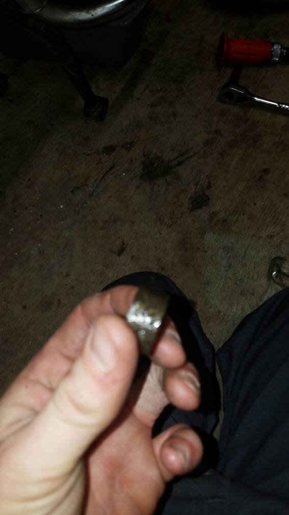

Need a little assistance. Went to pull the motor a little while ago. Figured ill put it apart. Lower case and trans. Unbolted front mount and took off rear mount. I have both side covers (case covers spoket clutch. And clutch plates all removed.) When i when to til the engine up something hit the floor. Figured a bolt. No biggy. But i looked down and its this large washer. Brown/black id say about 12mm large hole in center. Figures might have fell off from the footpeg rod. Because everything has some oil and grime on it. Test fit. Nope. Looked at tye brake lever and that area when i pulled the case covers off and took the sides out nothing fell just when i moved the motor mount. Any ideas driving me crazy tonight picture attached
Awesome had me slightly off , thought jt went throught the foot rod and fell out right side. I was close. Ha thankyou

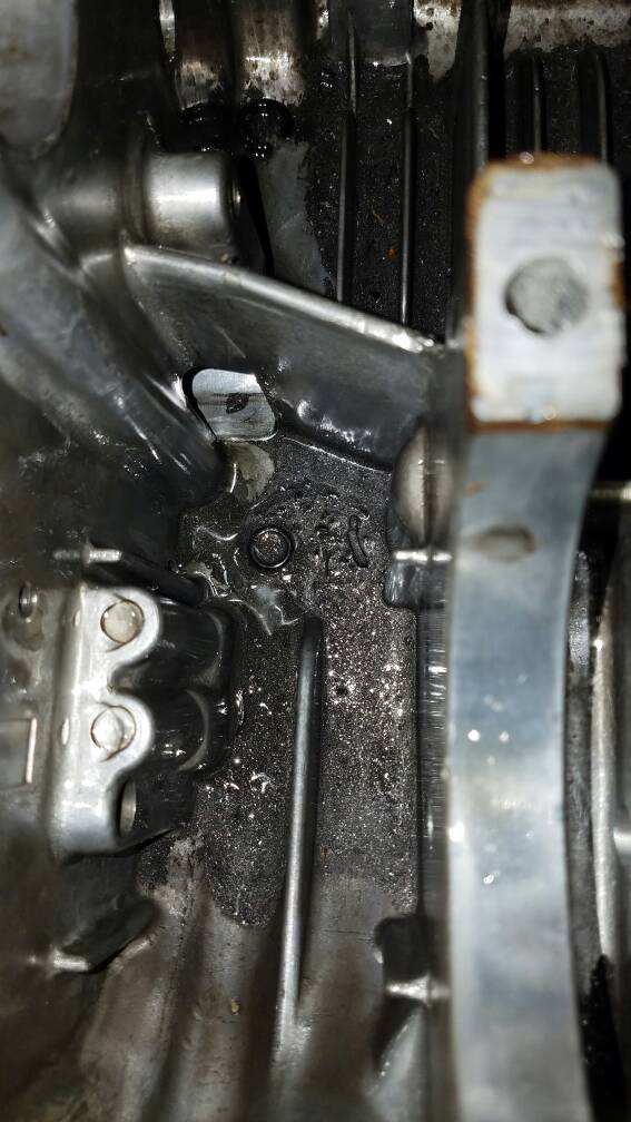

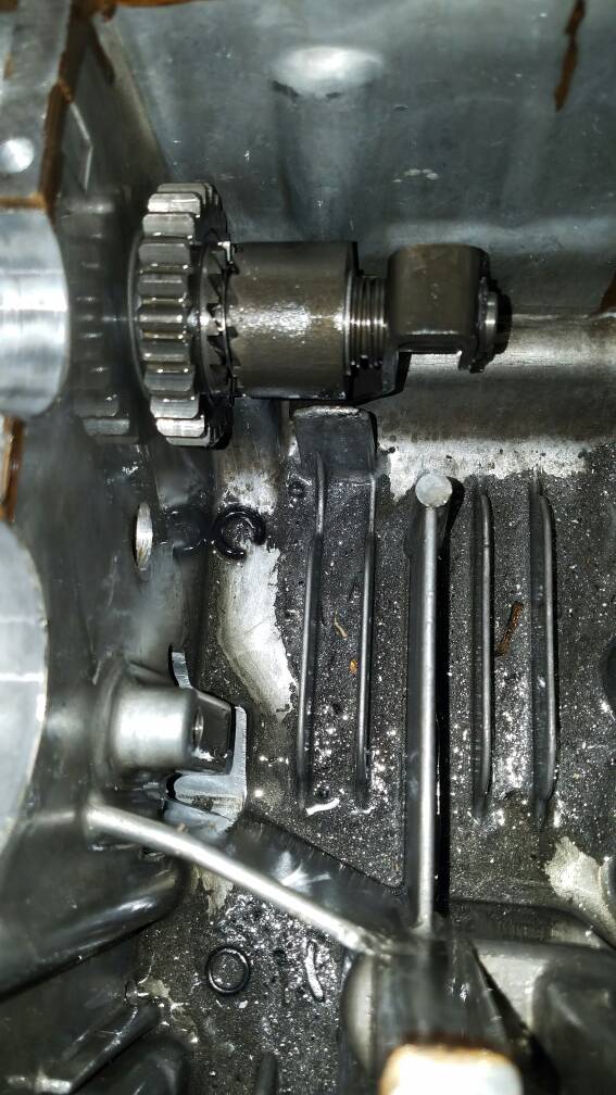

Put in some work last night took the cases apart, pulled the trans out , down to the kick start gear ( left that in) took alot of pictures.
When i split that case i found that where the tensioner rides on the motor, some ground down metal and 2 o rings in the case but not sure if from another rebuld that wasnt removerd ,and copper sealer along with a whole lot of metal sludge, but that looks like it came frok the slipper and case where they ride , i have no probelm taking it to the parts washer at work and cleaning it conpletely out. Can i reuse this or do i now need a new case top and the tentioner itself apperars to be missing a black end peice where the slipper sits?
More i tear this apart the more i wonder if its worth rebuilding?
Is the upper case worth saving or should i source one from ebay found decently cheap along with the head and rockers n cam
As long as its not worn through that upper is just fine, I think you will find quite a few 360s have that wear I know mine has it.

Orderd a head. According to cmsnl.com the rockers are the same part numbers for multiple cb360/cl36p engines and tockers show same park number for left and right and intake and exhaust. One rocker on the new one has some slight pitting. Debating buying a replacement. One ebay a sellers lists as A and another as D looks to be in good shape says no pitting. Cam on the one i bought looks good. Wont know 100% till it arrives hopefully this week. This is a picture of the rocker. Or can i do a really fine sandng to it and call it good?
You can't sand away those pits. The hard surface is only skin deep, repair or replace only... funny bit is it seems that rocker seems to chunk off on all of these on the same side same location
I understand, found a few but listings are weird listed at (a , b , c ,d), would this be a good substitute
Or i save tge money for a $80 nos rocket. Out of budget for a long while
