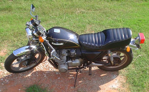

Here are some shots of the rearsets I kludged together for my KZ750. I used a ZX6 shifter and a M10-1.25x100mm bolt, some rubber hose, washers, nylon bushings, a spring from a fake Bigsby guitar vibrato tailpiece, electric drill, Dremel, various files & rotary bits, X-Acto knife, some lithium spray grease, a chop saw, a mig welder and a little Southern Engineering. (If you're not a Southerner, well, use your imagination.)

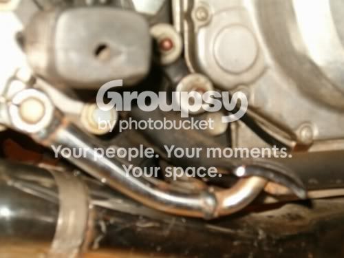

Cut about 2.5" out of the brake pedal, weld back together. The right side is now done.

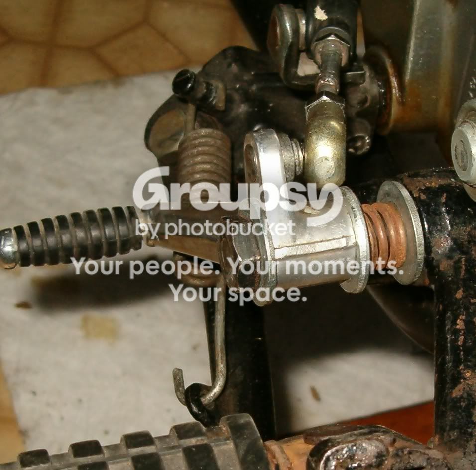

Moving to the left side, remove the upper peg mounting stud from the frame. There's a backing nut on the inner side of the frame, you'll have to remove this and you might need to use vise grips on the stud to get it out.
Cut about an inch or so out of the shift lever tie rod. Re-weld.
Cut a piece of nylon bushing to match the width of the shift lever. Put it on the M10 bolt, put the shift lever over that, then a washer, the spring, another washer, rubber hose (my peg bracket bushings were shot), the peg mounting bracket, another washer, and screw it into the frame. Back it up with the locking nut on the inner side of the frame.

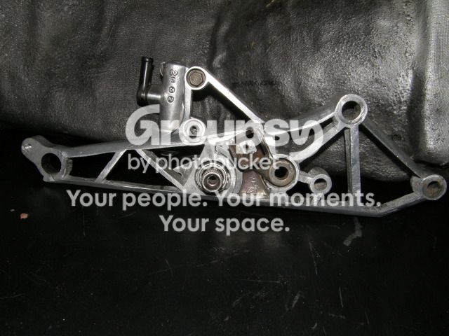

I've grabbed rear-set type brackets from the Euro-spec CB750KZ-'KC and they've got the rear-most located pedal pivot hole, and no provision for a but at the same time they're really, REALLY damn heavy! I've cut a good chunk of material off of 'em, and they're still just beefy as all get out. So I'm thinking I might "lattice" 'em, all DIY style. Only THIS time 'round, (the 3RD time IF it comes around) I'm not gonna cut & file 'em into square flat edges, but rather a smooth rounded profile like a triangulated tubular assembly - should help with "stress risers" and make 'em stronger that way.
Hopefully they'd look like the Duck Sport-Classic "Biposto" passenger/rear-set hangers, which are more or less functionally identical, but welded from tubes - and what a difference!
The standard "DIY lattice" job has square corners & sharp edges seem flimsy, & don't suit the retro-fried aesthetics I'm going for.
That's actually something I did with my old '82 CB750F Cafe project, is I did some DIY lattice plates where I relocated that pedal pivot hole, using the middle section of a spare TOP YOKE if you can believe it

WHATEVER - here's a pic or two of the relocated pivot tube on my DIY lattice plates - pre braze-welding stage only, as I lost my digital camera & laptop etc in the same fire that destroyed the bike projects. Meh - You either laugh, or you cry!
