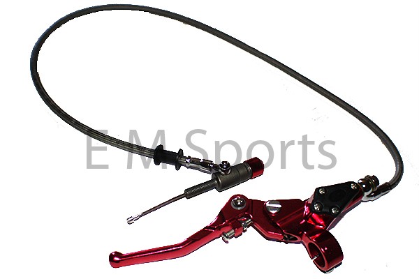

I have also been looking at replacing the clutch cable as it has some fraying to it. Whilst I was searching I came across a hydraulic conversion kit which looks like a good deal for the $50 it will be. The problem with living in Australia is you often end up paying more for postage than the item its self. I also need a new front tyre as you can see in the pictures. I have been looking at something along the lines of a Dunlop K460, I have never been a fan of dunlop though as the only two I ever had slid around more than a deer on ice.
Does any one have any opinions on hydro vs cable for the clutch setup?
Anyway here is a picture of the clutch kit I was thinking of getting.
