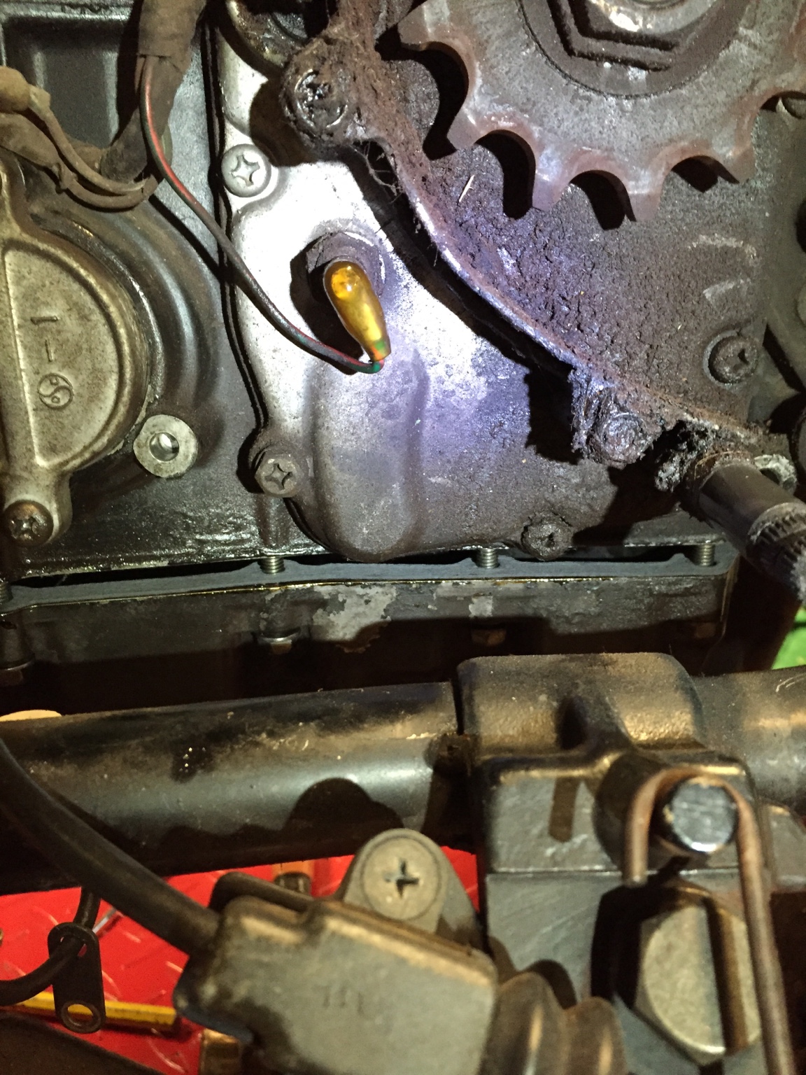

After my initial inspection and start up I knew we had issues in both air/fuel delivery and ignition woes. Further inspection revealed that the carb upgrade was done by a highly trained moron, one fuel screw 7 turns out the next 3 ? One had no juice at all so off they came and a full disassembly with chem bath. While soaking the timing cover came off and as expected we had a nice little mess.
The Deviant juice worked its magic, the timing slinger would live again.
For the pros yes it's on right, but the rotor is 180deg out :eek:

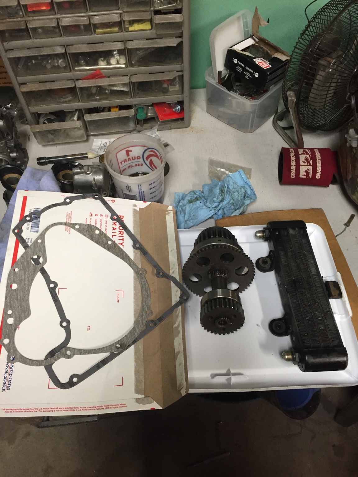

Moving onto the start issue, the covers come off the pan off and we see the damage to the workings of the clutch and start gear and even the caged needle bearing has some light rutting in the needles (never seen that 1) off to eBay for used parts and found a real decent "looking" soup to nuts shaft with all the goodies in tact.
This is not how the thing should look :eek:
Seems like a tough job, but more time consuming and dirty than hard if you follow the (factory shop manual) directions, even if your a hero all of these have little things that need a at least a glance to make sure you don't fight things both out and back in.
Look close at your parts, inside and out of all mating surfaces look for hot spots and cupping from the rollers or bearings, started to polish/sand off the ridges on my start gear and will finish it up, but will also comparison check with the eBay chunk.

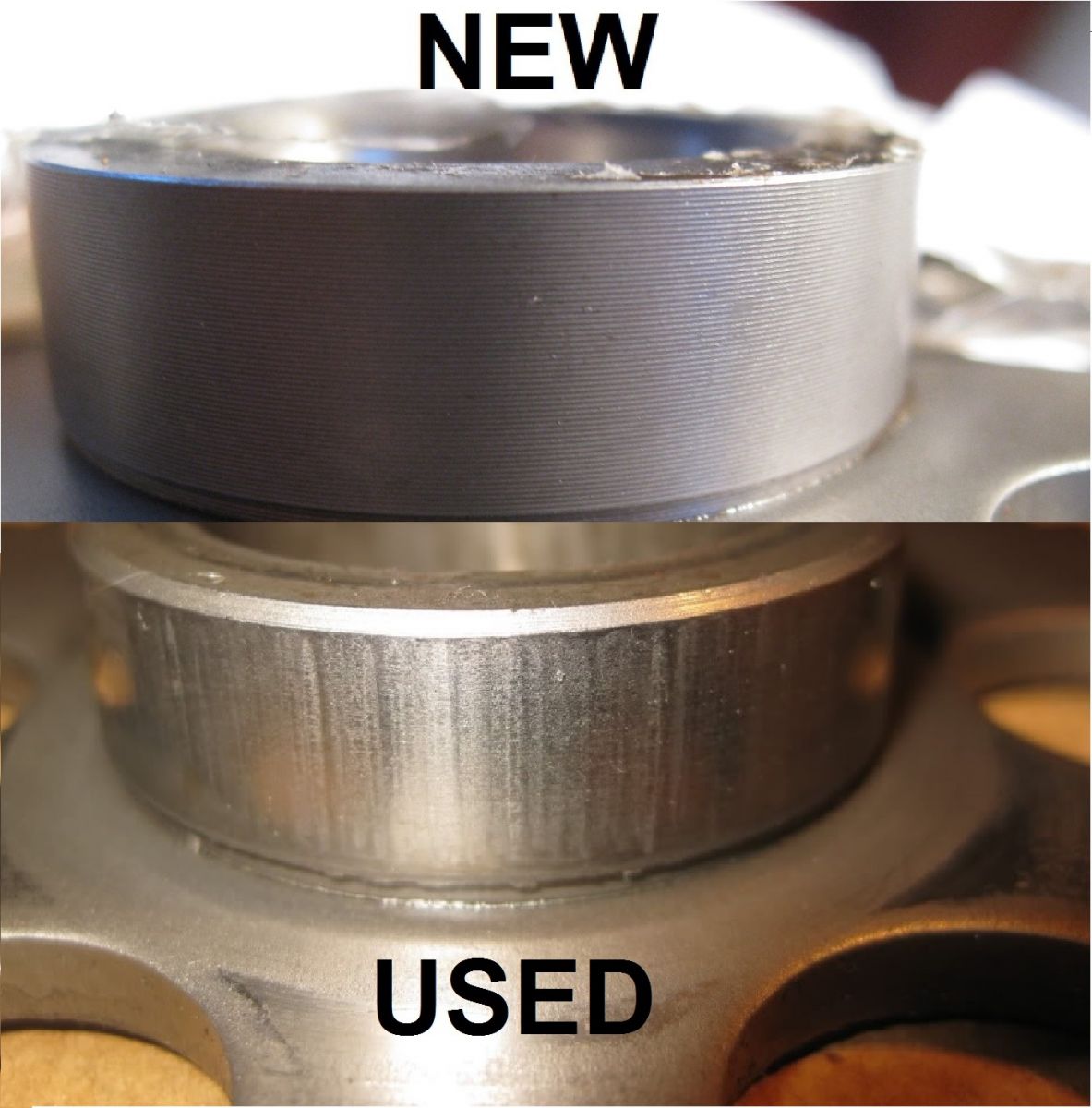

while you're in there you may want to replace the starter sprocket. I did a starter clutch rebuild on a buddies kz750E and after 6 months it started slipping again. Second time i replaced the sprocket as well and it has been going strong for years now. the flange where the clutch rollers ride has texture on a new sprocket so i think once they get worn smooth they are less effective.

Thanks Doc, I put that on my watch list. Just finished with gasket duty, good news is I'm the first one in. To me ne way :eek:
I purchased this: entire unit off eBay, seems I win some god and bad, but for $58 I will have a look, the starter gear was chewed or rutted up some, but I cleaned it up with emery which gives it some texture and like I said, I will measure them to see if either is worn more than the other.
It's just part of a rotating mass robbing power, if it were a race bike, I would put a kick start init and toss it all, the lower case has a place for it just not finish machined.
Yeah, big difference, kind of a radial grip pattern eh.
