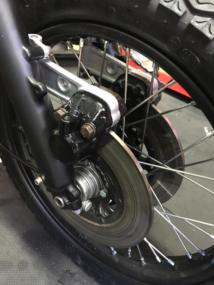

Progress!
The bike is built back up with Renthal flat bars and the cb550 front end with twin disks and the cb360 18" front wheel.
All is good!
The 18" wheel works ok, i made custom spacers to centre it and the speedo drive just fits.
I modified the calliper swing arms to lower the callipers onto the 360 disks.
Shimming the calliper arms so the calliper is parallel with the disk is critical, both vertically and horizontally, otherwide the brakes jam when bolted up.
The Renthal flat bars are lovely, look good and so much more comfortable that the clipons. I liked the look of the clipons but couldnt live with the discomfort.
Ive added a micron fork brace too.
Only a short test ride but the bike feels more stable than before, particularly in sweeping turns.
Brakes are significantly improved and still to bed in.
Overall im very pleased with the look and performance of the conversion.
Both the Renthal flat bars and the brakes/suspension have worked out well.

You're missing the screw and spring that centers the caliper(s). I'm not sure I see how they'd work correctly without it....it seems the piston would just push the caliper off the disc.
It'll work, but the fixed caliper will drag. The spring pulls it off the disc, while the other caliper retracts.
All that really happens is caliper rattles.
The main reason for keeping it in place is to prevent brake backing off too far which could be fatal on the street
The spring causes some rubbing when the pads wear unless you adjust every 500 miles or so
I do plan to make some 'bent' caliper adjusting bolts
the holes do not line up due to having to modify the swing arms to lower the callipers onto the 360 disks.
Brakes are working well, i have ebc semi sintered pads in and am pleased with them.
Handling is good, very stable in turns but maybe a tiny bit twitchy at walking pace?
Steve
If it's deep enough, you could just bolt a bracket onto stock location and use stock screw.
It doesn't need top supply a ton of torque, just enough so caliper can't back off if it gets bumped or something. Even then, as long as your not waiting until last second, you can 'pump' the brakes a couple of times to get back where you were
