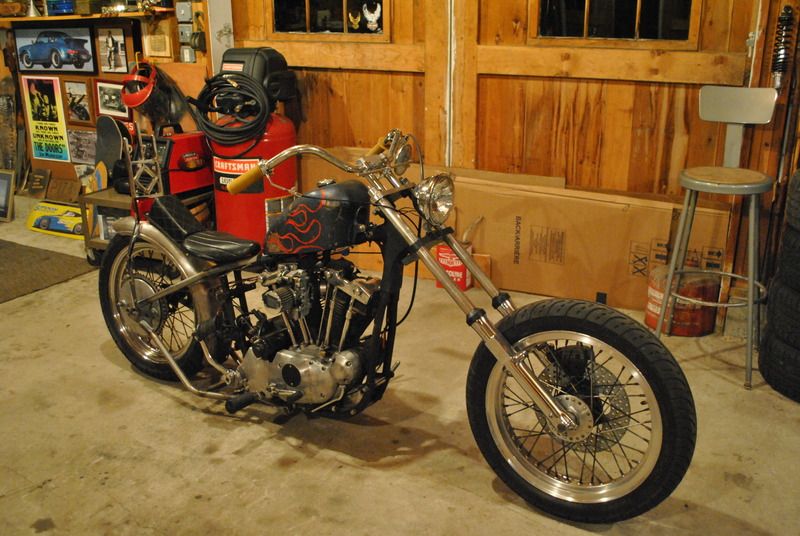

So I made it through the Holiday and bought a few parts for both bikes. The Chopper was going to have TC bros legs welded into it, but I just wasn't happy with the potential end result. So I ordered a 4" Stretch, 2" drop David Bird straight leg back half so I can actually trust the frame. I also got the diamond P Pad to throw more shapes once the frame is figured out.

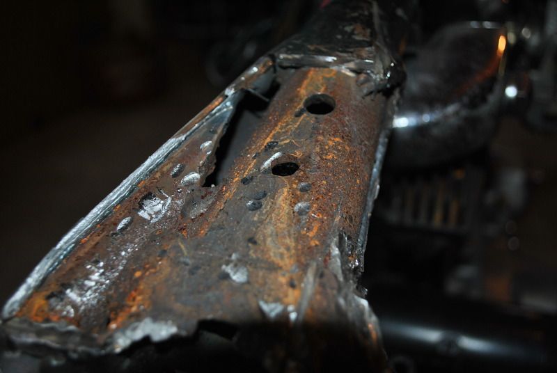

So In preparation for the David Bird section, I stripped the rear off the Chopper to start cutting off the hack job that was on there. I have it almost cut off, but my last cutoff wheel gave up on me last night so I'm done until I get some more today. I also convinced my dad that the 16" Hog wheel would work better on the rigid and the 18" can match with the "resto" on the '72 so I can get rid of the low pro Duro tire finally.
Here you can really see how they cut the upper shock mount section out and then cut the dropouts off and welded the oversized section in to the back bone. It was solid, but I wasn't about to stand behind it

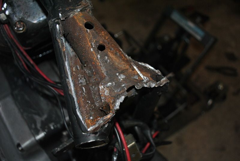

So I knew there would be horror under the gusset on the hardtail and I was not surprised to see that the coping on the dropout was about 1/2" away from the back bone.
I have a bit more finishing to do from the old welds, but most of it is done and hidden under the David Bird set up.

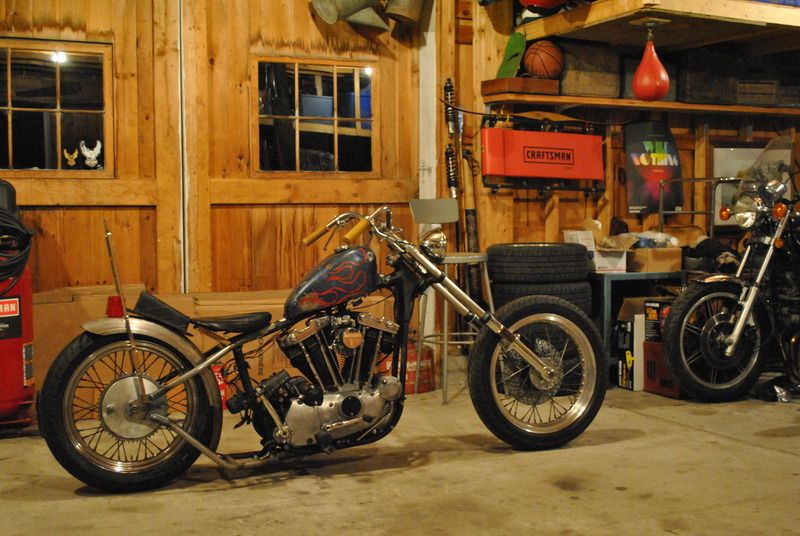

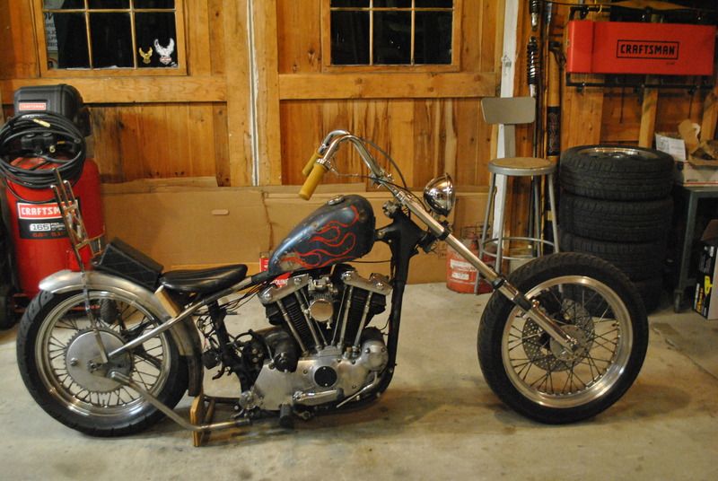

Got my Bars squared away last night. I think they are Roadking bars or something like that. The black set that came on it was the same, but wrinkle painted. I've been thinking of doing this for a while so last night I just went for it. I narrowed the black set first to make sure I liked the bends, and it was perfect. Also decided to go back to the hooded, brush alum Lucas taillight and plate mount.
Terrible picture again, but this is where I'm at. Finally liking the proportions. From end is next on the list of things to sort out.
