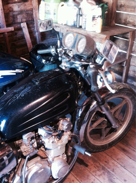

Unfortunately it handled pretty terribly with those things, so I picked up some dirt bike bars at a bike salvage place. Also found some bar end mirrors. Not totally sold on them, but they may look a little better if I shorten up the bars a bit. I recently discovered that the rear shocks that are on my bike are more than 2" shorter than stock! That explains the heavy steering, so once I get things back to stock length, I may look at going back to the clubmans, or clip-ons.
I stripped the paint off the tank, along with the bondo flame on top and the cruiser-esque profile on the sides. Also scored a '79 GS1000 parts bike with no motor, but it had the original aluminum hoop spoked wheels. Swapped out some bearings to work with the 550 axles and everything bolted up perfectly.

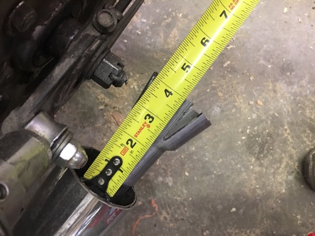

Built some baffles today on the cheap
Picked up some muffler pipe from Canadian tire, as well as the biggest couplers I could get to work with it.
First cut the couplers into quarters so that I could flare them out to match the inside diameter of the tapered tailpipe. Then crimped it together to fit snug with a muffler clamp.
Rivet together with stainless steel pop rivets
Cut end of pipe into sections and flare out so it takes a few knocks with a hammer to get it to bottom out inside the horn.
Measure the length that it sticks out past flush, and then cut that amount from the narrow end. Repeat the end cuts and flare out
Slice through with the angle grinder at 1" intervals 1/4 the circumference of the pipe. Insert a screwdriver and start bending.
 Offset by 1/2" and repeat until you have all 4 rows done
Wrap with fibreglass muffler packing and insert

Nice work on the baffle, I am going to try something similar on the XL. Does yours get held in by a screw/bolt or is that what the flared ends are for?

Yeah, I'll probably pop a bolt through on the bottom side to keep things from rattling. I may try and put in some sort of adjustable flue of sorts to adjust the back pressure if need be. Ideally I'll fabricate a plate that will go in the end just to make it look a little less bushleague as well. Just pushed things together by hand this evening as I was a little pressed for time, but desperate to hear what it would sound like. Sounded pretty good to me! It did quiet it down quite a bit from being straight piped, but definitely has a nice low growl now. Still plenty loud, but not too obnoxious.

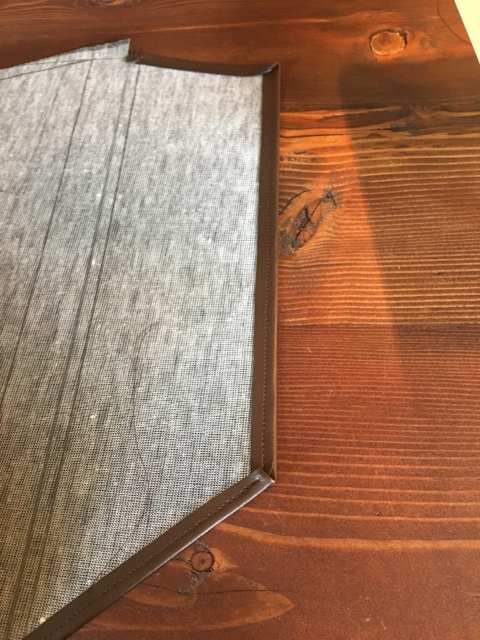

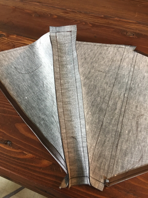

I whipped up a side cover for the bike yesterday evening. Going for something akin to federal moto's fade to black bike (pictured below). It's made of some marine vinyl I found at a discount fabric store for $10. I'll experiment with this stuff for the side cover bags and seat, and then probably upgrade to a nice leather a little later on as more cash becomes available. Thinking of going for something very similar on the seat as well.
