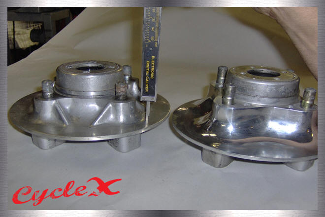

I installed the chain yesterday, but when I went to adjust and align it I noticed the sprockets were not aligned. With a straight edge across the rear sprocket there is a 1/8" gap at the front sprocket. The rear axle and spacers were replaced with the correct parts. I do not know if the stepped spacer is the correct one, but the hub flange sits flush with the hub. I found the stepped spacer in a bag-o-bolts that came with the bike.
I am not sure if the hub flange is the correct one. The wheel and hub were powder coated, but the flange was not. So that has me asking why? Why would you leave it the stock flat black when everything else is a nice shiny black powder coat? I know Honda changed the height of the flanges on different models to run wider rear tires so I wonder if the flange is not the correct one. I am fairly certain the front sprocket is the stock one.
My measurement like the pic below is 1 3/8" or 35mm.
Gap at the front sprocket.
Would it be possible for someone to measure their hub flange and let me know the measurement they get? According to the fiche the same hub flange was used on 1979-1982 CB750K's. Or if you have any other suggestions on what to check I would be greatly appreciative.
