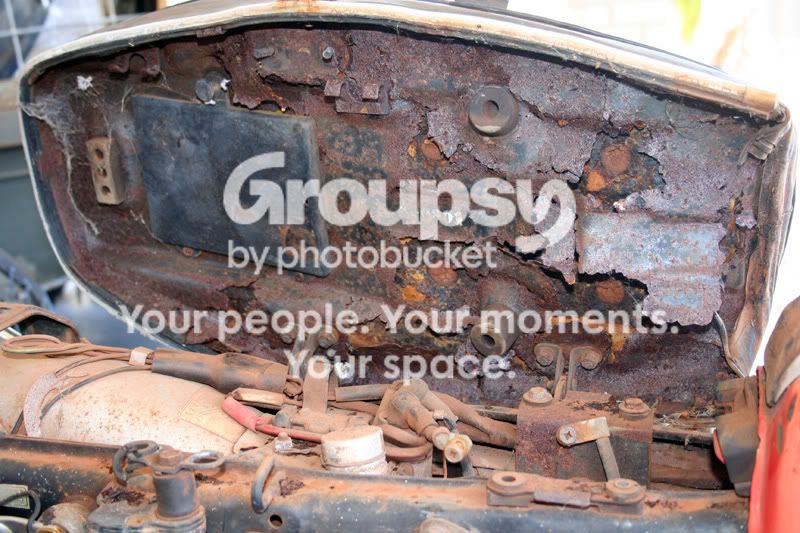

The seat base looks like it was constructed from fallen leaves:

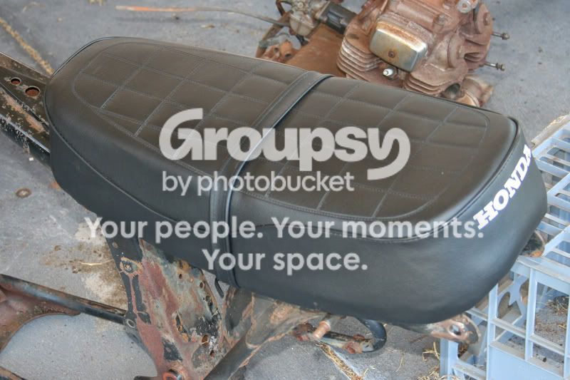

The new seat has arrived from Thailand. I took a gamble but I really shouldn't be surprised that the CB175 seat fits the 200 frame. The rear rubber doesn't rest on the frame support so it's not perfect but at AU$48 I'm very happy. I was worried it would come with a fibreglass base but it's steel too.
That's an awfully nice hinge for that seat! :D
