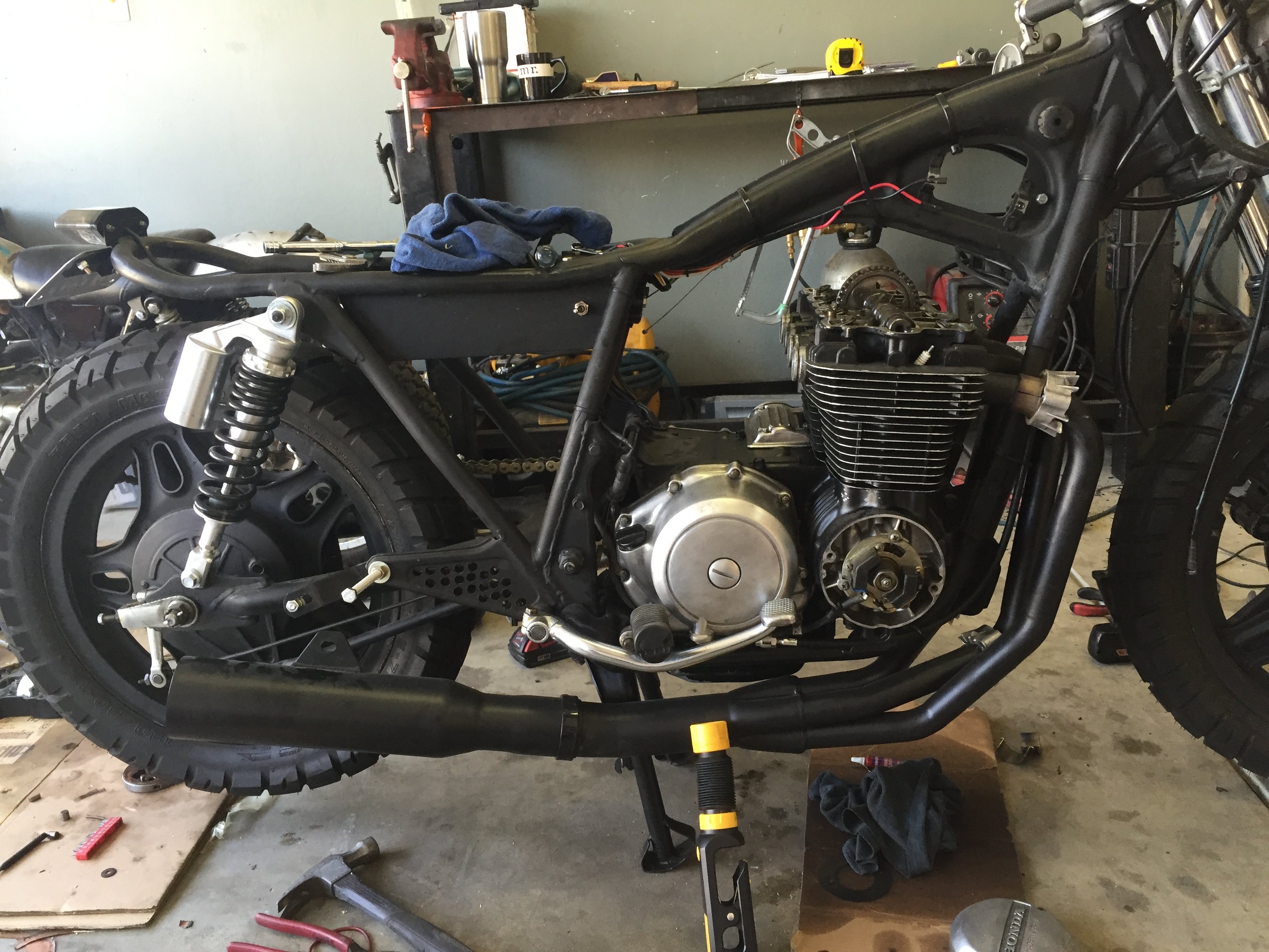

Can I cut my Mac 4-1 town to where my flashlight is pointed, then slip the muffler on at that point? Or will that cause back pressure issues?

I know enough to know I am not a guru. I think it will run " less good" . You have to decide if you want form over function. I personally would not shorten it. And I think that is one of the better looking Mac pipes I have seen. Cut firewood instead?

Where are you getting this from? If he was whacking the head pipes to collector maybe that would not be good, the only reason Mack has 10 inches of mid pipe is to fit the stock layout of some sort... He might want to do some research when shortening the can but a seriously doubt the best dyno in the land would detect this whack job :eek:

OK, so let's start with what we know and what we don't know.
Are any of us experts on that pipe and have any of us done any serious R&D on that particular pipe? That's probably a solid NO. So wer are dealing with what we believe to be a probable outcome and that's OK too. We know that typically a collector needs a merge section or mid pipe to stabilize flow and pulses, so chopping off all or most of a mid pipe is likely to hurt performance in some way.
Replacing a can is a simpler issue. The probability that the stock MAC can is dyno tuned and perfect for all engine applications is about the same as my odds of winning the lottery when I don't buy a ticket, but the probability of our new can being any more suited is about the same. We might get lucky. And then again, we might not.
Few of us use all the stock performance and even fewer of us can tell an actual improvement from a hole in the road or in a powerband, so if you like what you want to try, go ahead and give it a go. That pipe is steel and easy to weld bits back on if we don't like the results of our experiments.
Many pipe experiments result in more noise or a dip before it comes on the pipe and both can make a bike feel more powerful even when it's making less power than before. We call it character. :)
You could measure all the header lengths and work out what length you want them to be and then fabricate a suitable merge collector and transition and appropriate mid and tail pipes and so on, but you may end up having to make a few to test before you get one that really improves performance. For a street bike, go for it, just try to keep it quiet please.
Really I just don't like the up and out jog in the mid pipe. So Taking into account all you guys have said, I think I will cut it just past the bend and leave around 6" of mid pipe. I'm not ditching the muffler, I'm not that guy (nothing against those guys, I just like a low growl not a loud bang), I plan on welding a cone onto the end of the muffler though.....

Generally if you shorten the exhaust you lose mid range power, it won't make a massive difference to the top end power.
I know squiddly diddly about Mac exhausts but I doubt if it's been any where near a dyno.

It will go straight out though because you will be cutting out the kicked up part of the mid pipe and will probably look daft as well as hang out / scrape on something.
Now that is useful feedback... gonna have to cut the thing twice to save the kink and weld or have it welded back in. I would cut it so the weld will be all the way up to the collector just back a 1/4in... crank the welder up on high with fast wire feed, practice the weld several times on the scrap so you can weld half or more of a 360 without stopping, I have to hold the gun upright and use my thumb on the trigger... Or if you have a tig welder, then hell take all the time you want ::)

Damn, I didn't think about that. I cant take the muffler off and see if it will fit till I get the top end back together later this week. Maybe the plan should be cut off and reduce the angle of the kink a bit, then cut off some mid pipe and re-weld the kink back on and the most upright angle I can get without hitting anything.
