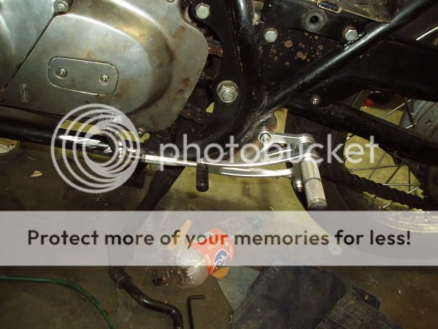

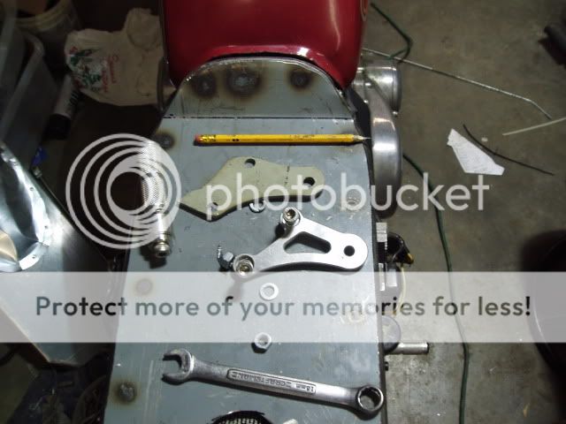

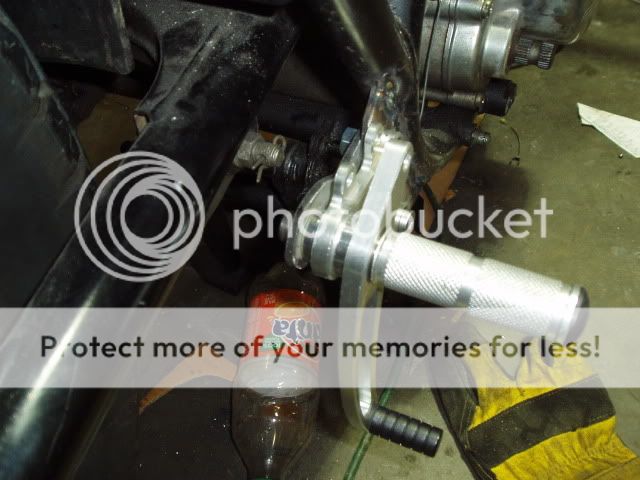

Some progress and and a major catastrophe narrowly avoided tonight at bike night. I got the linkage set up for the shifter and was getting ready to move on to figuring the brake side when I asked my buddy Dave to hop on the bike to try the shifter for a second opinion. He weighs probably 30 lbs more than myself and when he was bouncing on the pegs checking the feel of the placement he tweeked the aluminum rearset brackets. I'd somewhat questioned the strength of them before but they'd held up to my weight although somewhat bouncy.  Since the mounting plates for the aluminum brackets  were already cut drilled and welded to the frame I was shitting twinkies. I decided to cut another plate to bolt through on the back of the welded plates that matched the profile of the aluminum brackets so I could have a 3 point mount instead of just the front bolts to eliminate any twisting in the aluminum brackets. I needed spacers for the foot peg bolt which is now the 3rd mounting point but it is solid as a rock now. Here's some pics to make some sense of my ramblings...
New plate.
Brake side plate mounted.
And a pic of my earlier success in completing the shift linkage which still counts since I just needed to add the new plate to strengthen the existing work. ;)
I know there are a couple of other members here who have bought the same cheap universal rearsets as me on Ebay so I'd like to warn them to make the mounting plates big enough to bolt in all three places to avoid twisting. I'll try and search for who they were but hopefully they're following along and read this. I'm sure I've deleted the old pm's like a dummy. :-[
