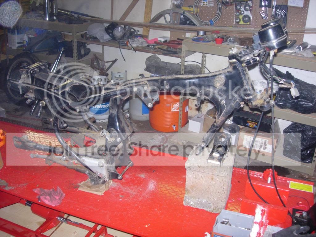

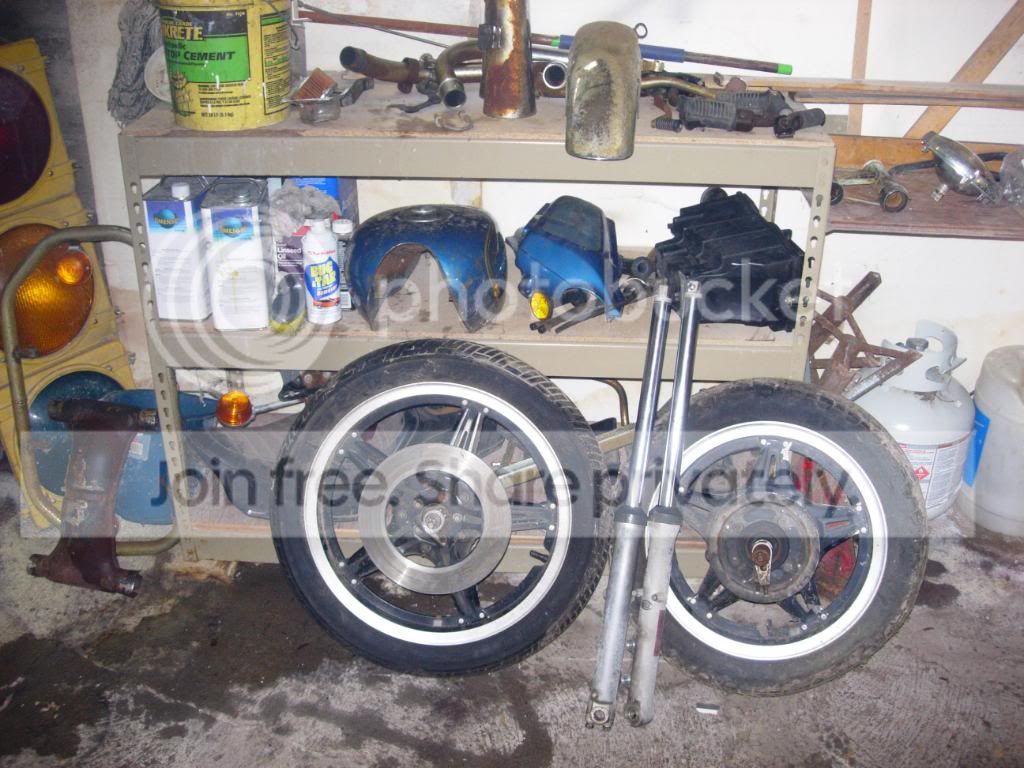

Started what remained of dis-assembly and here's what was left..
Everything removed from the frame

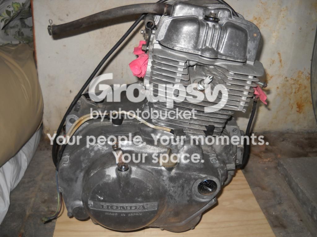

Motor out
Wiring Harness
Parts Pile

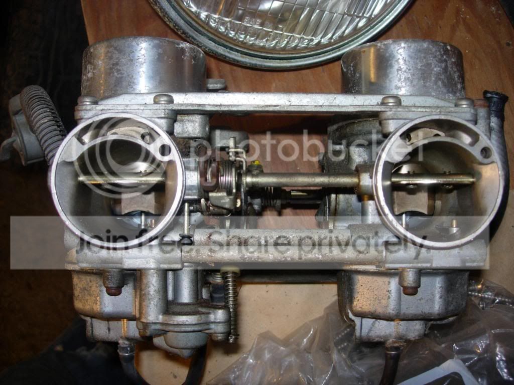

Carbs off.. Seem to be pretty clean too

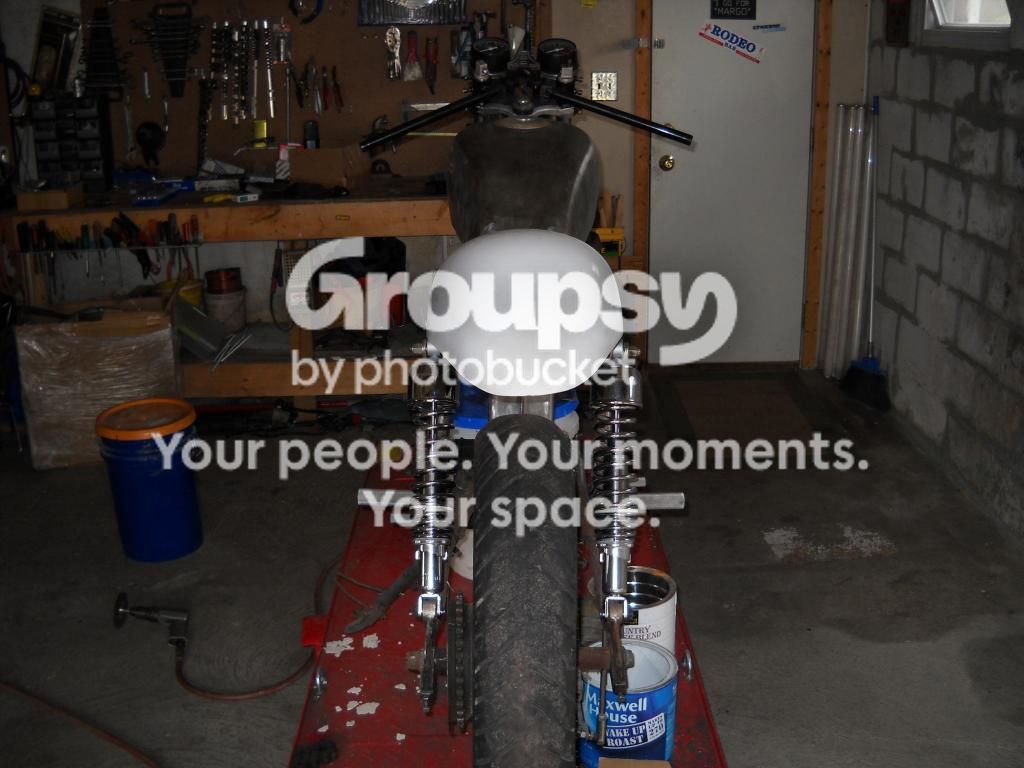

I've just started the modification process after receiving a few parts.. Clip-ons, seat cowl, rear-sets and rear shocks..
Here's where the bike stands as of now..
After stripping most of the frame, lowering the trees approx. 1.5in on the forks and 1in longer rear shocks.

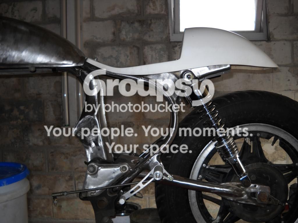

Stripped the tank and threw on the rear sets in the passenger peg location.. I'm not sure if this will be the final location for them, but its a starting point
Cut down the rear tank mount to create a better transition from the tank to the seat.. Still needs welded but this is still in rolling chasis/mock up stage
Had to grind out a section of the front of the seat so it sat properly on the frame.
Now a roller

Also, finished chopping off the rear top shock mounts.. Wasn't happy with the look at all.. Got them remounted and just tacked into place.. Not sure if I'm going to keep it this way or cut out the rear hoops of the frame and construct a new rear section.. Thoughts??
Re: 1981 Honda CM400T - Freebie!!
Have you thought about just doing a whole rear subframe? That seems to be the best solution to cruiser frames like this and the nighthawk, viragos, etc. These bikes do have a lot going for them though, great twins and the tank shape is really nice too IMO. Great job so far.

That's what I'm trying to decide currently.. I'm a novice welder at best and that's what concerns me. The geometry, etc are not the issue, very good with math, etc but I want it to be safe structurally and look good at the same time.

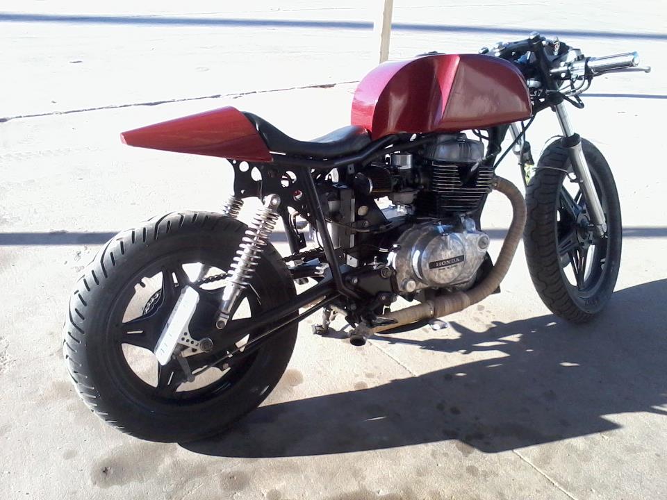

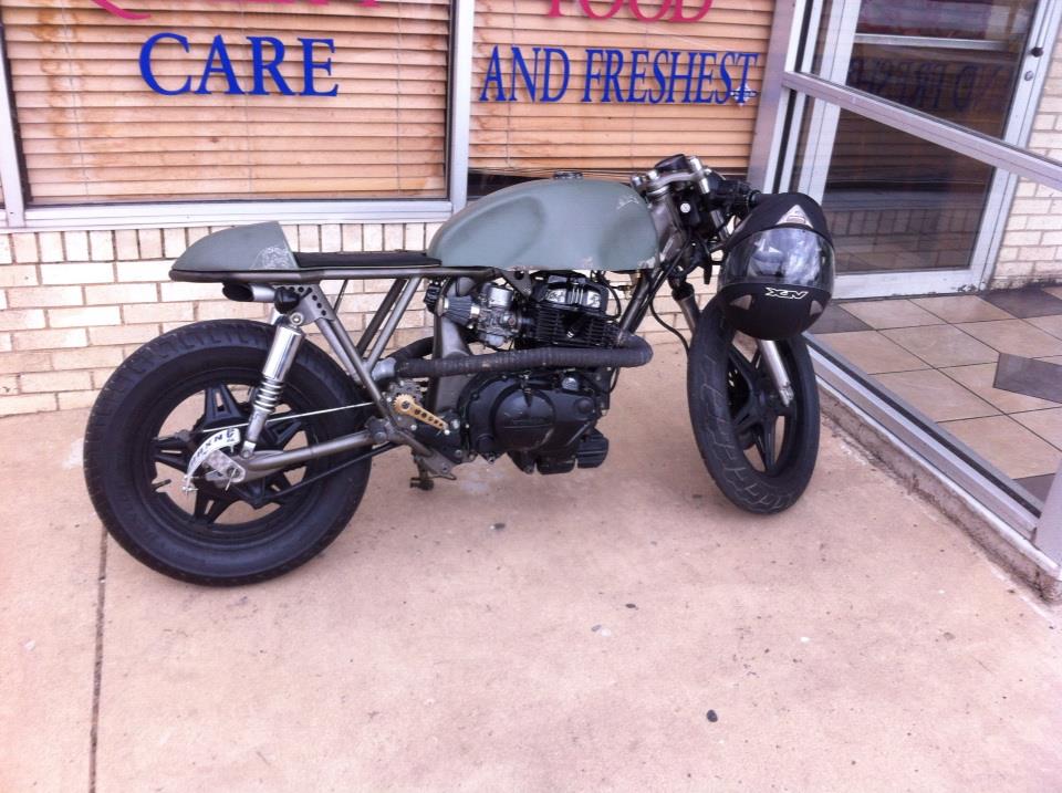

yeah I rebuilt the subframes on both bikes with the stock swingarms. I like to reuse/rebuild as many stock pieces as possible. Here are the CM's i built. you don't have to raise the rear that much. When you rebuild the subframe bring the line higher in the rear and it will look raised .On your welding,get you some scrap pieces and weld til its strong and consistent. When you feel comfortable start chopping and rebuilding. Trust me it will be totally worth it in the end.

Both look great!! I think I would have to take the direction of the red one more so because of the dip in my seat. Any idea how far past parallel you are on the swing arm on either? If you look at some of.my earlier mockups, notice the longer shocks on the factory mounts. The swingarm is pushed down to far for the chain to clear..
they make chain idlers that a spring loaded that you can weld or bolt on that will keep the chain from rubbing and they look pretty cool. I think I'll be using one on my build. I know what you're talking about with the chain hitting the swingarm.
