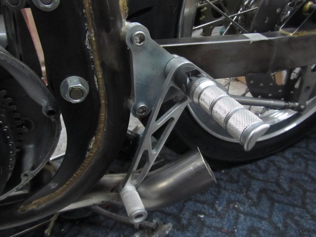

The new rear set brackets are done (still need to make the brackets for the silencers), and polish them later..

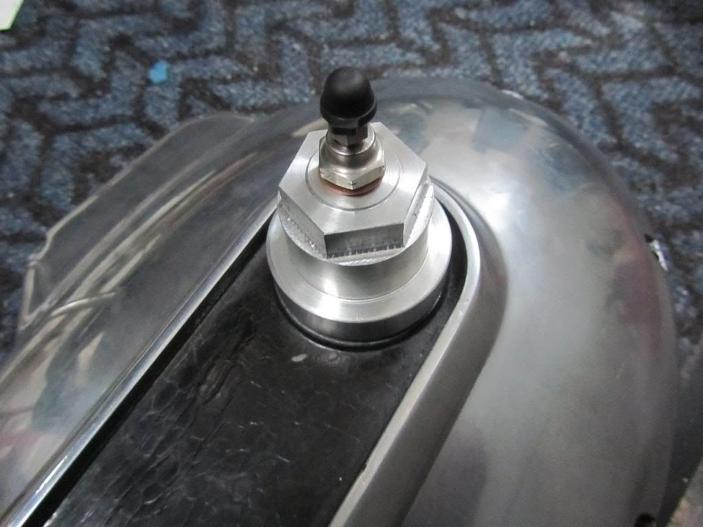

Machined a hex on the clutch slave cylinder, to fit a 30mm socket, as otherwise it needed a strap wrench to tighten it.. looks more interesting too

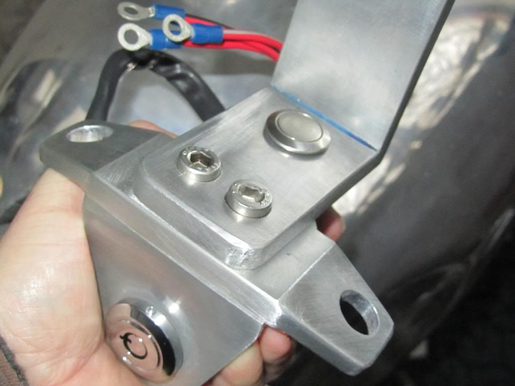

Starter button is fitted in the top motor mount..
