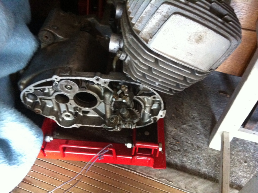

Hey guys!
So i ran into this offer.a guy is offering me a Mach III 750 engine with trans and all for 400 euros....plus carbs he asks 600.
This might sound like a huge amount of money but keep in mind that this bike is really really rare in austria....i've never seen one on the streets of vienna.
Though about taking this as a long term project....getting all the parts will be a long oddissey.
What you guys say is this 2 stroker a good one or was it just kawa flexing their muscles?
I ride a RD 250 daily and i love the feel and power of the little stroker....
Here are some pics.
Is it just a waste of money or will it pay off :)

The Kawa 750 2-strokes can be fire breathing monsters if set up right. Price wise €450-500 for the engine and carbs would be okay, but make sure all the bits are there, you don't want to get stuck on an engine with an empty button end.

Sounds good :) dunno how the part situation is here in austria.
Guess trueing a crank like that would cost more than the motor...
the crank wont need to be trued unless the rods are bad and you replace them.
you may have to bore it out and install new pistons.
its just a guess but i don't think there are many parts in austria for those.

Those things are getting pretty scarce regardless of where you live. At one time that was the absolutely fastest store bought motorcycle in the universe. Legendary! Pretty much 3 times the power of what you have now and only a bit more weight. Actually a smaller physical package (except for width) than your 250! Like anything else, if it holds interest for you, it is worth the money. You will find it pretty much the same as your 250 from a mechanical/working on it perspective. Being completely apart like that is a bit worrisome, but if you spend enough time inspecting and collating the parts you should be ok.
Mobius do yoh think the price is reasonable?
I would see this as a long term project,i hope the EU wont ban these filthy 2 strokes the next years.
Important for me is that i cam as much as possible with my own hands,so i can save up money for the expensive stock parts.
A dream would be to plant that thing into a new frame and suspension of a modern bike,but it will be a PIA with the registration in austria.
Is it a MachIII or is it a 750, can't be both, unless someone put a big bore kit on a 500. The 500 was a MachIII, the 750 was a MachIV
When the Mach IV came out it was not only the fastest motorcycle , but the fastest production vehicle sold to the public. It was known for it's handling, or lack thereof, and gained the moniker "Widow Maker". If it's been sitting for a period it will most likely need new crank seals, which would require splitting the cases. If you have a better frame to start with you have the beginnings of a fast ride. Instead of a modern frame, I have a MachIV stuffed into a 59 Norton Manx chassis, one of the best handling bikes at the time.

01marc is quite correct about the Mach III vs. Mach IV questions. Make absolutely sure you are getting what you think you're getting. ???
That said, if it's a 750, the value will only go up in time. Parts will be a tad expensive and hard to find, but they're a unique beast. :D If you can't locate an actual 750 h2 frame, finding a frame to fit won't be a huge issue. They've been slotted into some very unusual packages. :D
