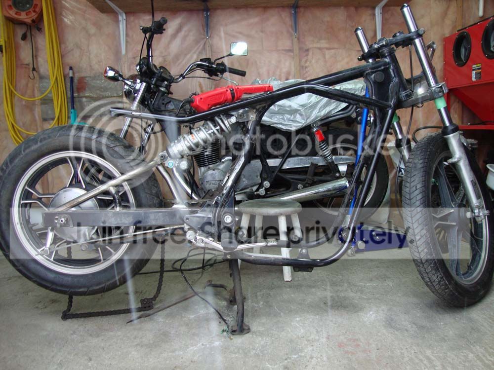

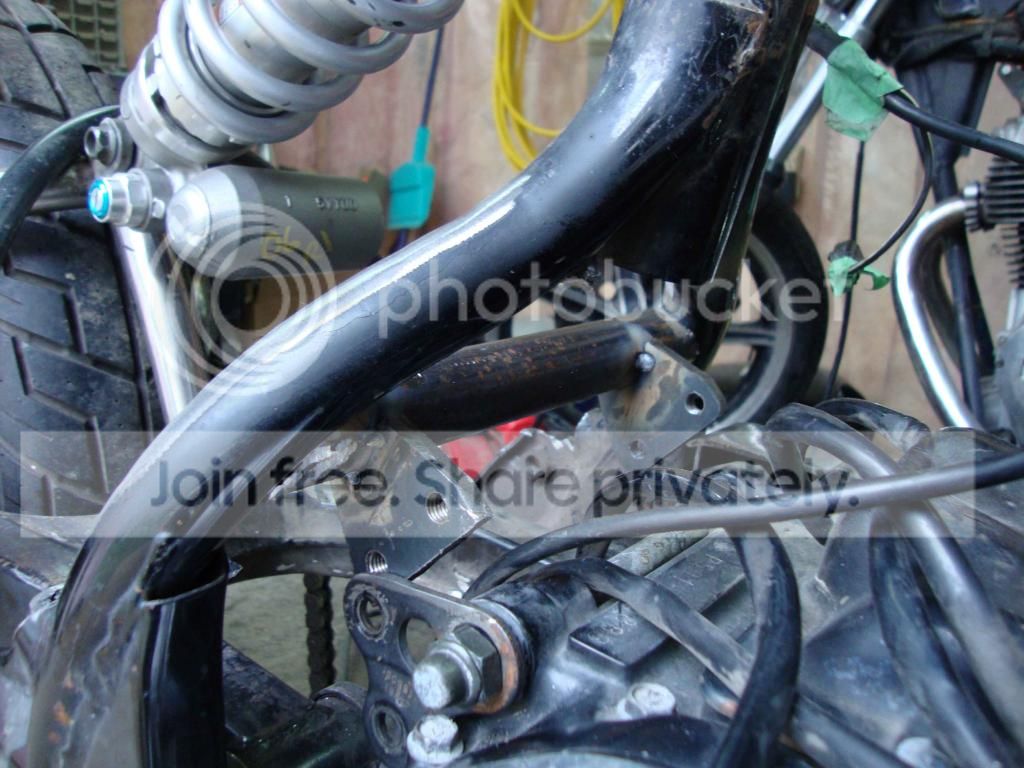

Decided to start on the swingarm first. Keeping it monoshock with a slight change. I tacked on the test piece I made and liked it so bent up some 1" tubing. Cut off the old mounts and cleaned up old welds. Then cut a brace for the middle and I will be using 2 of the bends from the stock subframe tubing as supports for added structural support.
Yesterday I started on some mounts out of 1/4" flat plate for the new rear shock (from an 06 R1) and lined the shock up with the swingarm and main frame. Today I finished up the main frame mounts.
That's where I'm at so far. Almost done with the swingarm then will fully weld it all.

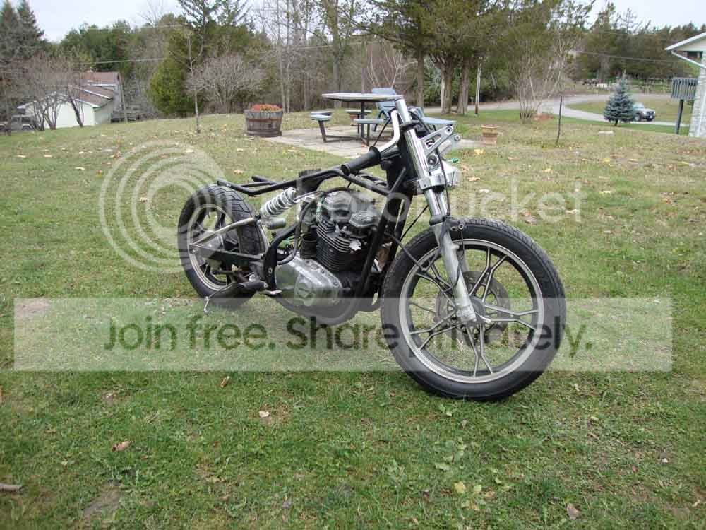

Lowered the forks through the trees to see how much I want to lower it. Might go just a little higher than in the pics so they don't bottom out. Will cut the springs and go with a heavier oil.

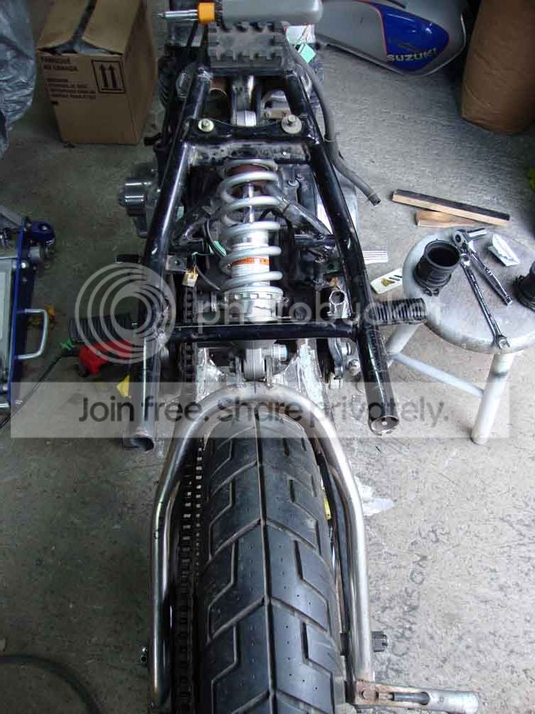

In the mean time I made some rear engine mounts since they were originally bolted to the old monoshock bracket. Also cut a brace to hold the rear engine mounts that will also hold the fake tank to hide to the electronics and battery in.

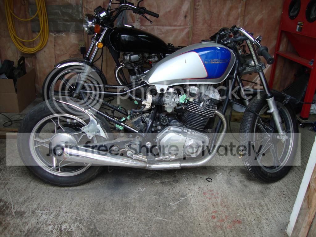

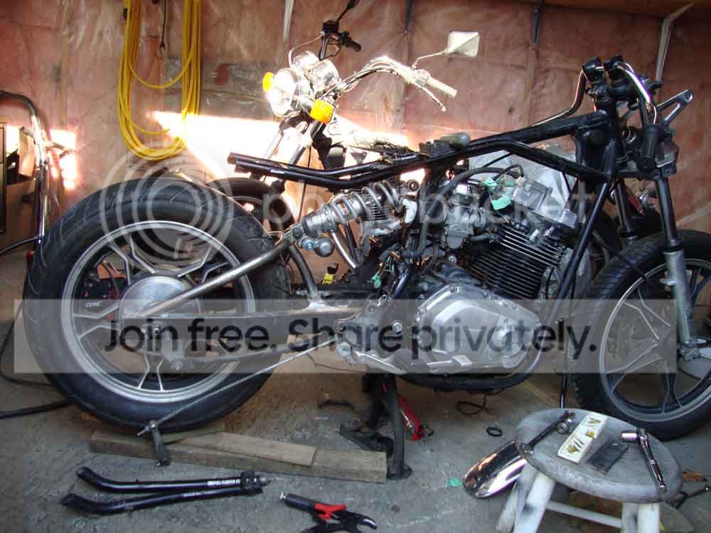

Engine removed. Going to lower the shock mounts on the frame a little so I can lower the seat and also cause it looks off right now.
To fit the tank I had to cut the 2 sides off the triple backbone. So I added a little structural brace between the neck gusset. The tank mounts and coils will go on that as well. I'm thinking I may need to add 2 short braces that will fit with the tank and run from the front downtubes to the main backbone to help stiffen it since I've cut the stock ones out. All the stock tubing is 1/16" thick so it's got me nervous. What are your opinions on the strength of the single thin wall backbone? Will adding the 2 braces really help if they only run to the new brace I added from neck gusset to back bone? I'm not an engineer so I've no idea.

Had some time today so made some front tank mounts for the Rebel tank I picked up on ebay. It was in a flood and is full of rust. Going to try the electrolysis method to clean it out. Tomorrow will have the coil mounts done as well which are going on that same bar under the tank.
Need to find some 1-5/8" tubing locally so I can finish the rear tank mount and have something to bolt a seat to.

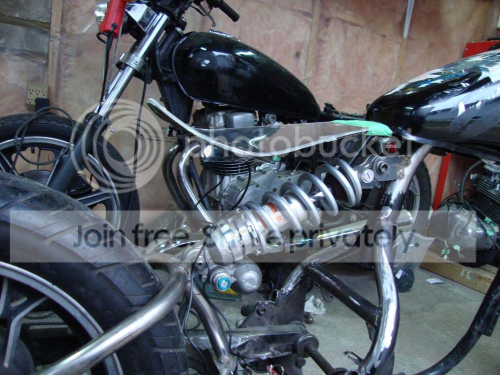

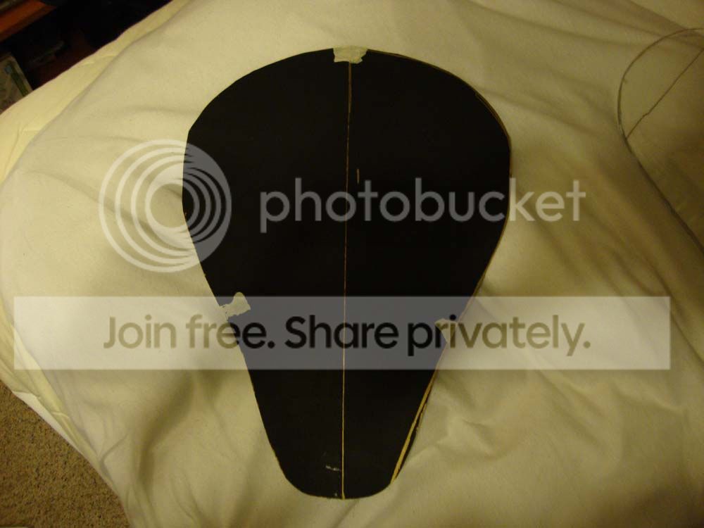

Made a seat pan as well. May leave it bare for now and stitch some leathers together for it later. Not quite sure yet. Haven't saw a clear seat before, may look nice with the monoshock showing below it.

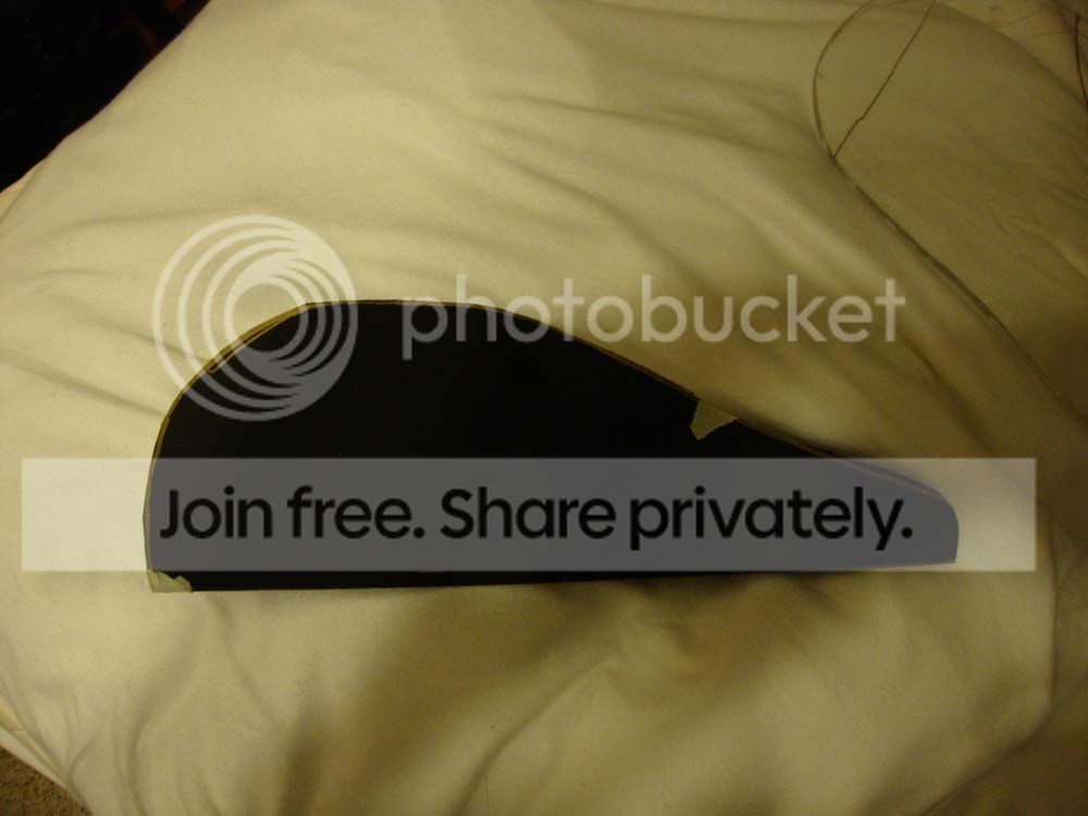

First roughed out a sketch of the shape with the dimensions I wanted. Then folded in half and cut it out to make it symmetrical.

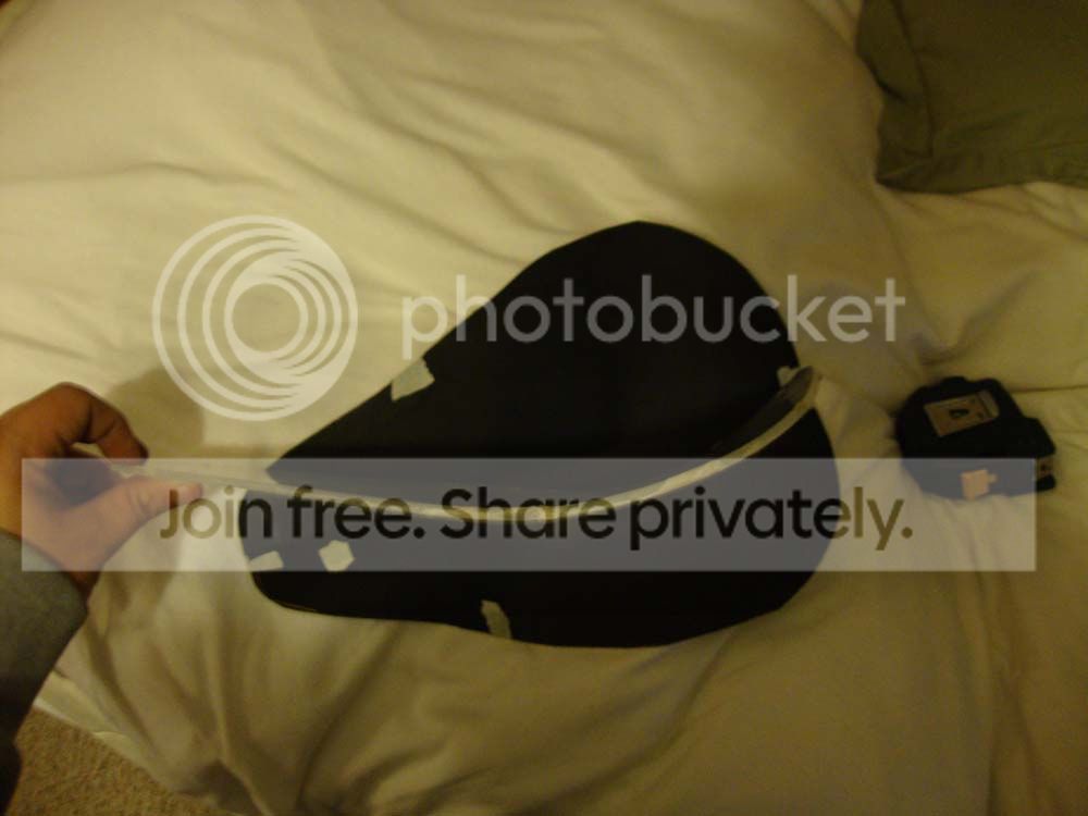

Then taped that to a piece of plexiglass I had laying around and cut it out. I may remake it out of thicker plexi but this seems pretty sturdy.
Then put the heat gun to it and bent it around a paint can to get the rise in the back I wanted.

I'm no engineer either, but I would definitely have somebody look into those frame modifications. I know my grandparents (right Von?) over built the frame and suspension components because they were groundbreaking at the time. So it's tough to say if you removed "too much". Just don't want you munching asphalt, that's all.
But if there are some parts you're looking for or questions I can answer, just let me know. Oh yeah - check your rake and trail when dropping the front that much, and remember how low the engine hangs down too. Lowering the suspension gets aluminum close to the ground quickly with the GR.
With the tank it's going to be very difficult to run some tubes from the engine downtubes to even the brace I added between the neck gusset and backbone. I'm going to have to keep thinking on how to stiffen it up.
I was already planning on making a skid plate because of how far the oil pan sits below the frame.

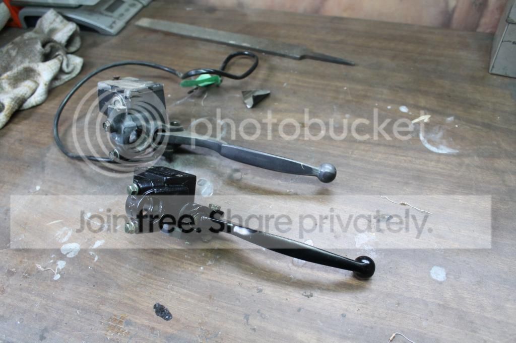

Haven't made much progress lately. New smaller master came in, really tiny and clean looking.
