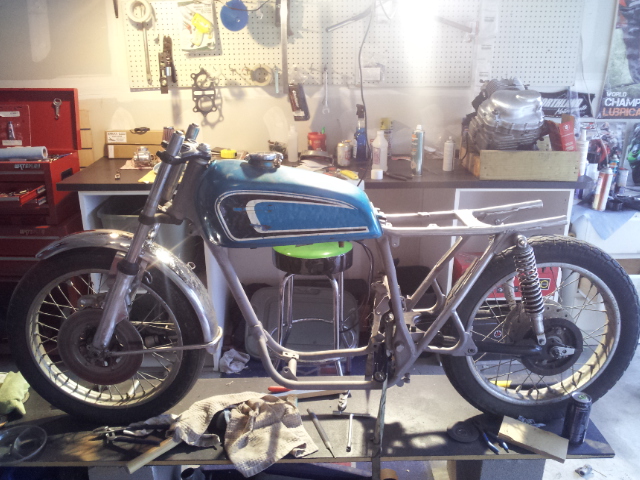

So currently I have a blasted frame, motor with a fresh top-end, ported polished head,
ceramic-coated internals and outer surface's from the jug up, a rusted out tank(which i'll get into)....Also I have a fresh set of mikunis and pods.

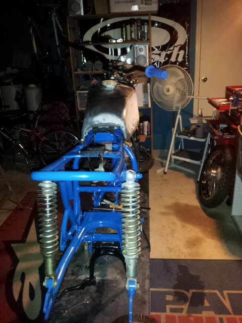

So what I have accompished today.
1. Finished chopping/smoothing the subframe.
2. Dented the sides of my rusty tank. I decided that I would do some experimenting with it and if it didnt work out, Screw it....but I really like the way its looking so I'm going to try to seal it up.

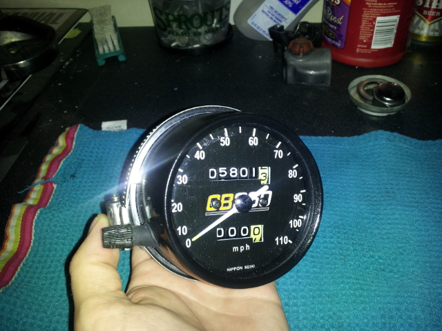

3. Reassembled my speedo with a new decal from sonreir.(kinda lost on how to get the ring to stay?)I'll post some pics of this tommorow.
Here are some pics........

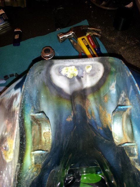

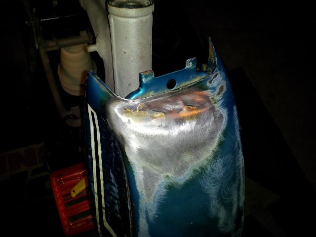

Pics of the holes in the tank......

So does anybody have any suggestions as far as patching these holes from the outside?
Would jb weld suffice, Or should do real welds before lining the tank?
Input is appreciated.........
I'm still a noob at welding but it seems those small holes would be easy to hit with a small spot weld. JB Weld might be good but not as good as a metal on metal repair.
If the metal has rusted from the inside out to the point of holes popping thru, then the inside will be much worse.
My process for cleaning tank is too start with a couple gallons of 50-50 milkstone remover and water. Milkstone remover is a weak acid that turns rust to black metal (iron oxide into iron phosphate). You can find it a tractor supply. It is phosphoric acid (70%). It flash rusts after exposure, so rinse with water and blow dry. Then coat right away.
Have someone with a mig hit it for you. You're going to have to turn it down pretty low to keep from blowing holes in it. JB weld is a bad idea, and might work for a little while but fuel WILL eat through it. I've seen it happen on a few different tanks.

The new decals turned out well(thanks sonreir) I probably shouldve been more anal about putting them back together?....But screw it they look better than they did.

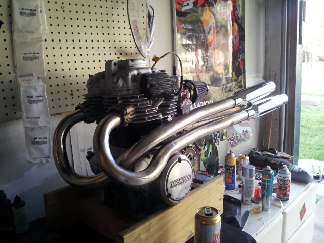

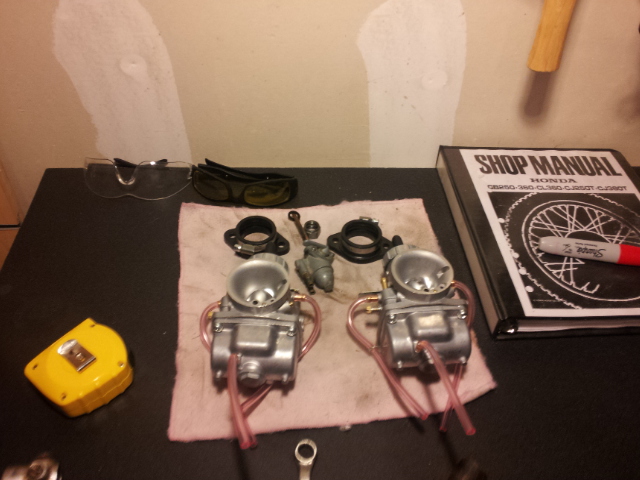

Some pics of the motor with the carbs mocked up.
Which leads me to yet another question, What are you all doing as far as mounts for the mikuni carbs?do the boots hold tight enough or are you fashioning some sort of mount??
They seem pretty tight but I'm not sure if its tight enough?

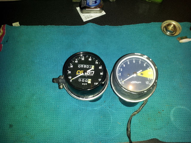

heres my gauges...speedo after new decal and old tach.

TANK- The problem with pinhole rust like that is that it will continue to rust until there is no tank left unless you can find a way to stop it.
Sealing the inside of the tank will not help forever because the tank will continue to rust from the outside in.
What I do with stuff like that, because I'm a cheap ass, is try to fix the outside first. You can weld it or w/e but I happen to like just plain old soldering. Duct tape the holes shut, plug the petcock hole, Fill the tank with WATER, helps to keep the heat down and keeps the tank from exploding. The take a wire brush or a wire wheel on a grinder and pick a pin hole and brush the paint and the RUST off, be gentle about it as it will eat all the thin rusted metal out as well making Swiss cheese out of the tank. IF you make a bunch of holes by cleaning things up then just go find another tank. Keep working on the holes one set at a time till you have them all clean and bare metal.
The rest of the process involves getting out the soldering equipment and going to town. If need be I can write that up but I'm betting you find that tank gets pretty holey and will prolly need to be replaced anyway.
CARBS- the boots that go with the Mikuni's should do well enough to hold them in place, just make sure they are fully seated in them

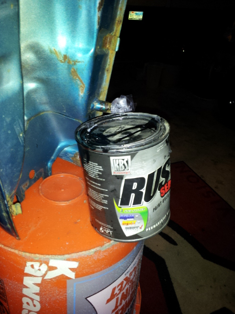

Also braised the tank, filed/sanded the welds and started lining it. I included a couple of pics of what we use at my work to line tanks and have had good luck with it.
thanks again for looking.

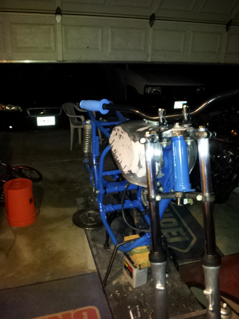

Couple of pics
