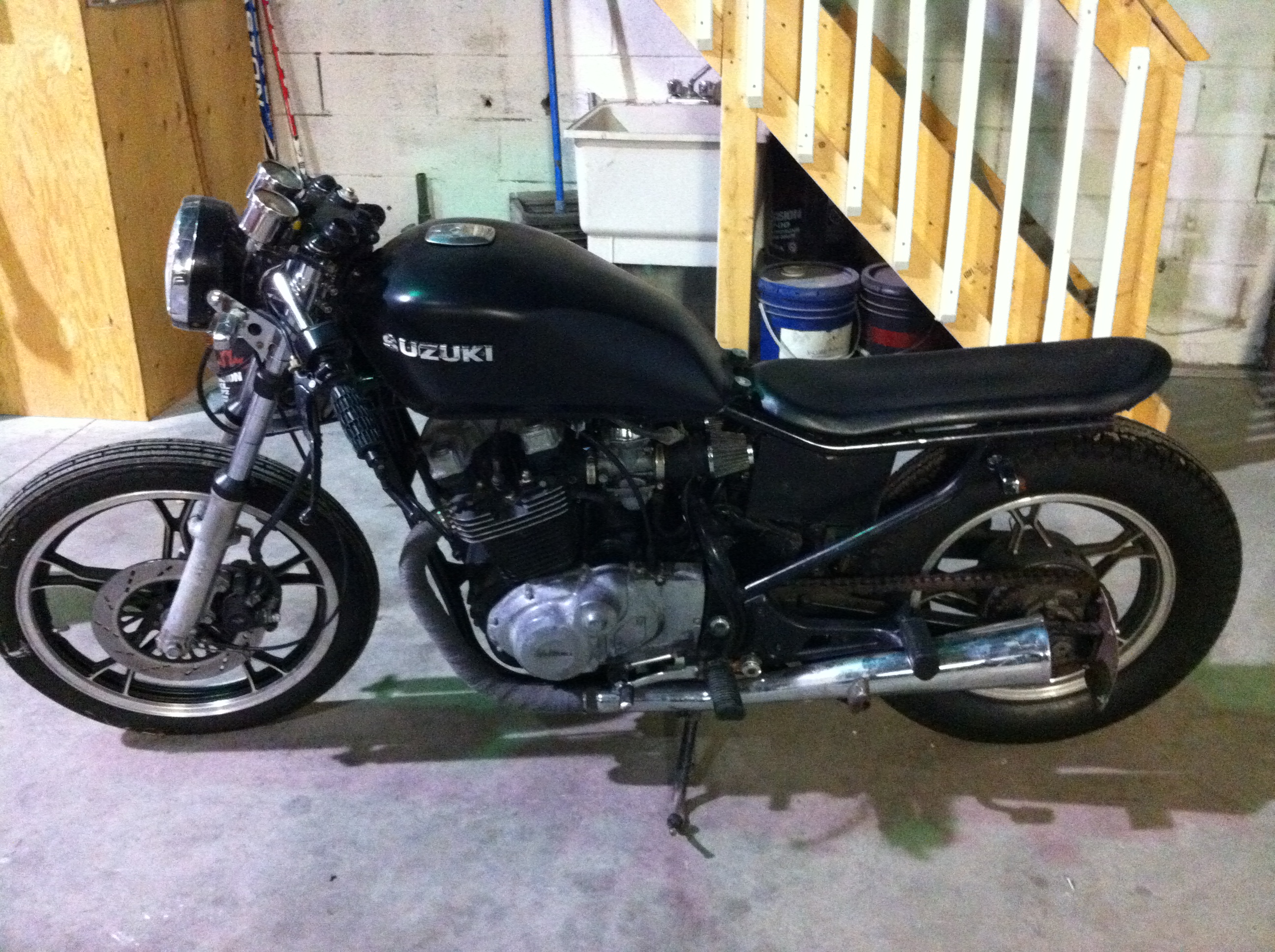

WIthout getting into a huge debate over fashion vs function I would like to get some opinions on running a balloon tire setup with a 16" rim on the front. I have heard arguments for both sides and I am looking for more insight before i take the step of purchasing a new front end
I am building a 1984 GR650 brat/cafe/bobber/blah blah blah and I want to have the balloon tire effect.. here is a pic of my bike as of last season ( im doing a full ground up rebuild this winter) and the pic that has inspired me to run the small front rim. Basically my concern is safety.. I understand that its not gonna handle like im running performance tires but i also dont want to be tossed into the ditch the first time i try to bite into a corner.. In the pic it looks like they are running a 16" Avon Speedmaster rear tire up front on a small rim, is it dangerous to run a rear tire up front or are modern tires pretty universal??.. and since i already have a 16" speedmaster on the rear if it is possible to run one up front that would be the most economic rout to take.. also the front end is shot on my bike so replacing the whole front end to accommodate a smaller hoop is totally an option.. which brings me to my next question, for those who think its not a bad idea to run the 16 up front is there a fork/ rim setup which would fit on the gr that you might recomend??
thanks for the opinions whatever they may be

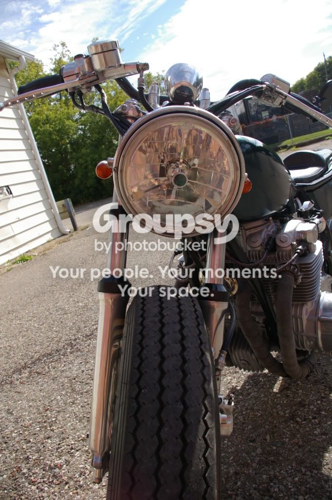

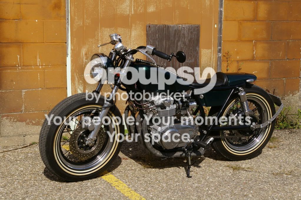

Looks like the tire rubs the fork tube...and no fork brace. :eek:
As long as it is art, it looks nice...but the mechanical engineer in me says OMG.
I guess I don't understand why someone would go through all that work, and not get a wider set of triple clamps and forks, so the tires fit properly.
Not so much fashion over function, but fashion without function. If the bike can't be ridden safely and reliably, is their a point, other then the art of it?
Looks are deceiving. There's 5mm on each side and yes we build bikes to ride! The mechanical engineer in me wanted to build this bike by using as many stock parts as I can. Isn't that the point! Some "engineers" can visualize and solve problems using what is there! I did have to design a new caliper mounting bracket but it uses the stock caliper mounting point with the stock caliper on the stock rotor on the stock wheel on the stock fork leg using the stock triple. The bike has been ridden since to last years Mods and Rockers event in Toronto and guess what no rub! Fashion and function mydlyfkryzis !

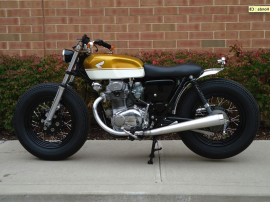

550 looks pretty neat but the tyre IS too wide for forks.
Even in picture you can see the polished area on sidewall where it has been rubbing.
I've ridden over 100,000 miles on CB550 and know very well the limitations of stock forks, wider/heavier tyre will make things worse.
A fork brace would help as forks will twist even if lowered/shortened.
You may have helped the stanchions to remain in place but the axle is the only thing holding the sliders
As an 'engineer' it should be obvious that the front axle diameter is too small to tie both sides together without twisting
I've posted multiple times how to test for twisting so I'm not repeating it again
Dude I can assure you that it doesn't rub! That's THE reflection of the Sun on the polished fork tube on the Armour All sidewall. Nice and shiny! Then for fun we put some on the treads and do burnouts! Whoohoo!
I did a search for your post crazypj but I couldn't find anything relating to testing. If you could send it along it would be much appreciated.
I respect your opinion but given the parameters I'm dealing with the twisting effect is negligible.
Stand in front of bike and grab front wheel/tyre between your knees and ankles, grab bars then just turn bars left and right while holding wheel centered.
You will be able to move bars at least 1/2" possibly a lot more (depends how strong you are overall)
The forces acting on front end are much stronger when you have at least 450 lbs of motorcycle causing the movement
You seriously didn't 'Armour All' the tyres? (I can see it wasn't all the way across sidewall)
The shiny bit I'm refering to is about 1/2" wide above second white line
You can choose to believe what you want but the tire doesn't rub because wouldn't you get a rub mark on the fork leg? Guess what? No rub!!! Oddly enough even though I'm a 200lbs weakling it doesn't flex. No I didn't use Armour All....just No Touch Tire Care! ;D
They ALWAYS flex a little, maybe you didn't do it right?
