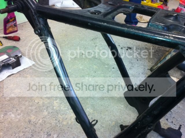

Started on the frame ;D

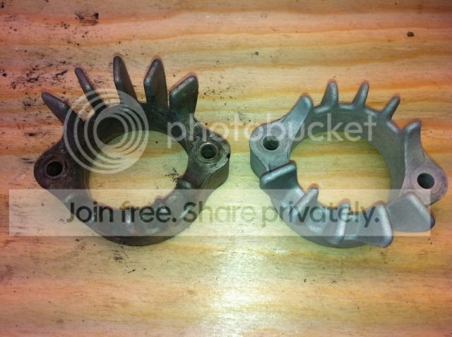

Removed a few unnecessary lugs, about 5 in total, before:
After:
Tried out the sand blaster kit on my old compressor, works ok in small blasts. My compressor aint that big so i have to wait for the pressure to build and then I get a god ten second blast. So its only really any good for small parts like this.
Thats it for now, its amazing how long it all takes. you think ahh i'll do that in a few hours... 6hrs later your about half way there!
That looks to be a grinding wheel your using... If its, I would suggest a cut-off wheel. They work so much faster, with much less pressure required for cutting.
If it's not... Then ignore the above post...
Hi Swapmeet, It's a plasma cutting disc, really slim. It was really, really fast like a knife through butter! I also used a flexible sanding disc after to smooth it all off including the lug removal, that was also very useful and recommended.
Yeah pictures can be deceiving there is a lot of loose, peeling paint.
I've been inquiring about powder coating but it always involves a full strip down which ive seen another guy on here just undertake and it looked crazy with all those parts led out everywhere! :eek:
So i think im going to sand it back myself, take my time and make sure it's spotless then prime and paint myself. I want the whole thing matt black.
