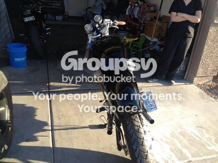

How it looks now after a fresh washing

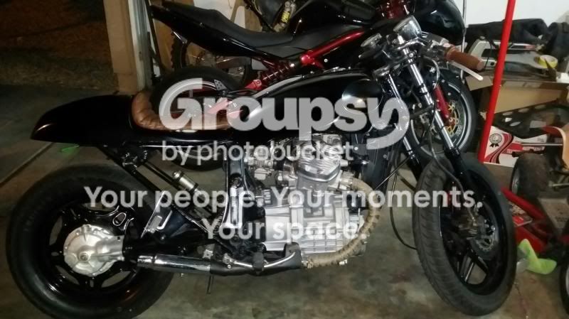

New tail. also, you can see how i "fixed" the air cleaner problem

I then began routing all of the electronics through the new seatpan and under the bubble.
Another shot. It was at this point that i removed the front fender and decided i like the bike better with it on. It also gives a little more protection to the radiator
LED tail light from DCC fits so nicely in there. It was also very easily installed <5min
side shot. im really impressed with the outcome of this light!
Painted the frame, fenders, and did some general tidying up and heres where we are at today
I rejetted the carbs to a 90/120 and added some universal shorty mufflers. The sound is not too loud, but super mean! Im really digging the way this is coming along, but i really wish i would have started in on the internals first before the looks. Eh oh well!
