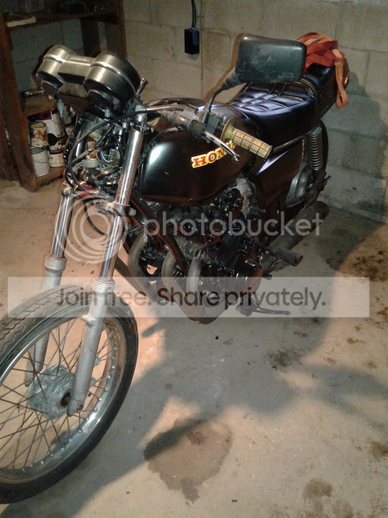

As the title might suggest, I'm new here! I've ridden quite a few motorcycles in my life but I've never owned one until now! About a month ago I picked up a 79 Honda CB750k for $500 on craigslist. The guy who owned it before me put it together in his kitchen after painting it (badly) with no intention of ever riding it. it was about 3/4 of the way put together, the few things that were obvious right off (and the PO was honest about the whole thing,) no speedo cable, no receiver gear for the speedo cable, no headlight or blinkers, 1 of 2 throttle cables and not the important one ;), choke cable housing was cracked, and no front caliper, rotor or brake hose at all.
Before I bought it
