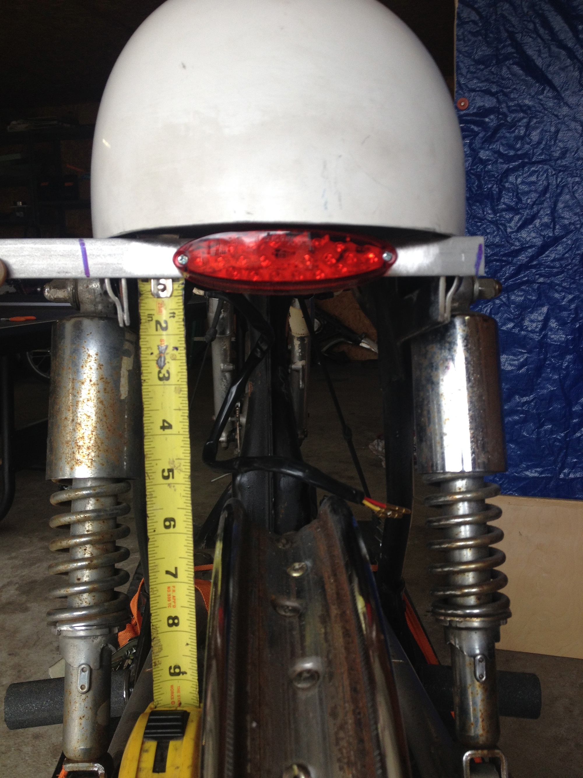

First photo shows amount of clearance from rear rim to bottom of seat pan to rim. (roughly 5 3/4" from top of rim)
will be running 110/80 or 100/90 rear tire. Do i have enough clearance for travel of stock length rear shocks????
nothing sits below top of frame at the rear.
second photo shows how I wanted to mount the tail light. but it will sit another inch below.
any input is greatly appreciated. thanks.

no ,start over
fer chrisakes it is not rocket science
this is a very common bewilderingly frequent mistake people make when they have absolutely no clue what they are doing
sandman28 said:
Ok thanks, not much to "start over" except putting bigger spacer between seat and frame.
put tire on rim
take off one shock
set the other shock preload to soft
with a ratchet strap attached to upper frame and axle on the side with a shock,pull the swingarm up hard against the bump stop of the shock
leave at least an inch clearance to any seat pan,loop or frame cross pieces
