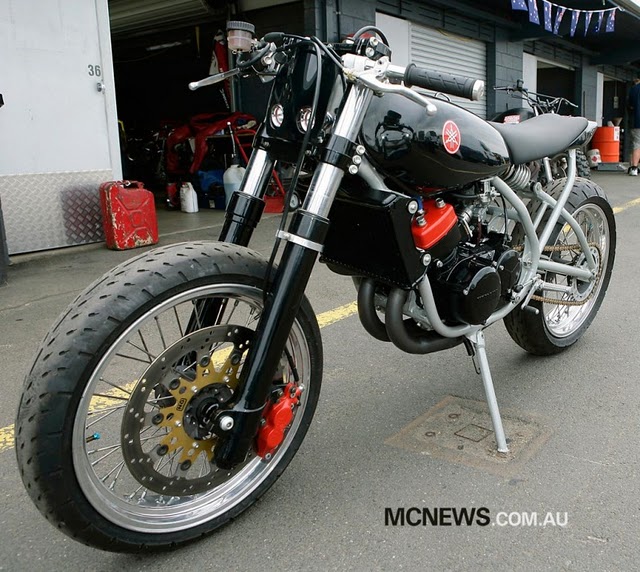

Hey Guys,
I'm toying with the idea of doing an rd350/ninja 250 swingarm conversion, but I'd really like to fit supermoto-esk rims and wheels on it. I am wondering if you all have recommendations for fitting/finding 16", 3.5 spoke rims for a 250 swingarm, or 17" for a 250r swingarm. Any insight would be helpful
Here is an inspiration, but I know nothing about the specs of the bike:
I love the Chapelle show username. I'm also in search of some spoked wheels for my RD250 conversion. I have an EX250 swingarm that I've cut to fit the RD frame.
From the pics you've posted, those sumo wheels look lime they came off of a Husky SMR510 or 610.
