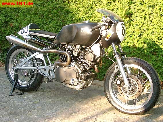

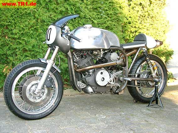

Absolutely agree with you, there's a guy in Germany by the name of Sepp Koch, who is racing his highly tuned TR1-Engine in a modified featherbed frame against some old Z1000s, GS1000s, BMW R100S in a racing series called grab the flag and let's just put it this way, it's not a hopeless fight after all...

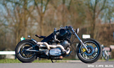

Would have never seen a bike this cool out of a Virago. Any more info on any of these bikes? Really diggin the first one. I'll definetly be following your build.
miob said:
Re: TR1 /XV Traditional Cafe Racer
You can find a lot more info if you google 'Sepp Koch'.
One 'word of warning' though: Right behind the back cylinder there is supposed to be a piece of bolt on frame connecting the rear swingarm to the frame on top of the engine and to the engine. IN all these bikes it has been left out. Personally I think it will make the bike unsafe, though I have to admit it's a gut feeling and not a proven fact.
It does make the bikes look a LOT cooler though, since it is a very ugly frame piece.
I've pondered this for quite some time and will go ahead with the chop. Koch is just using the engine as a stressed member.
