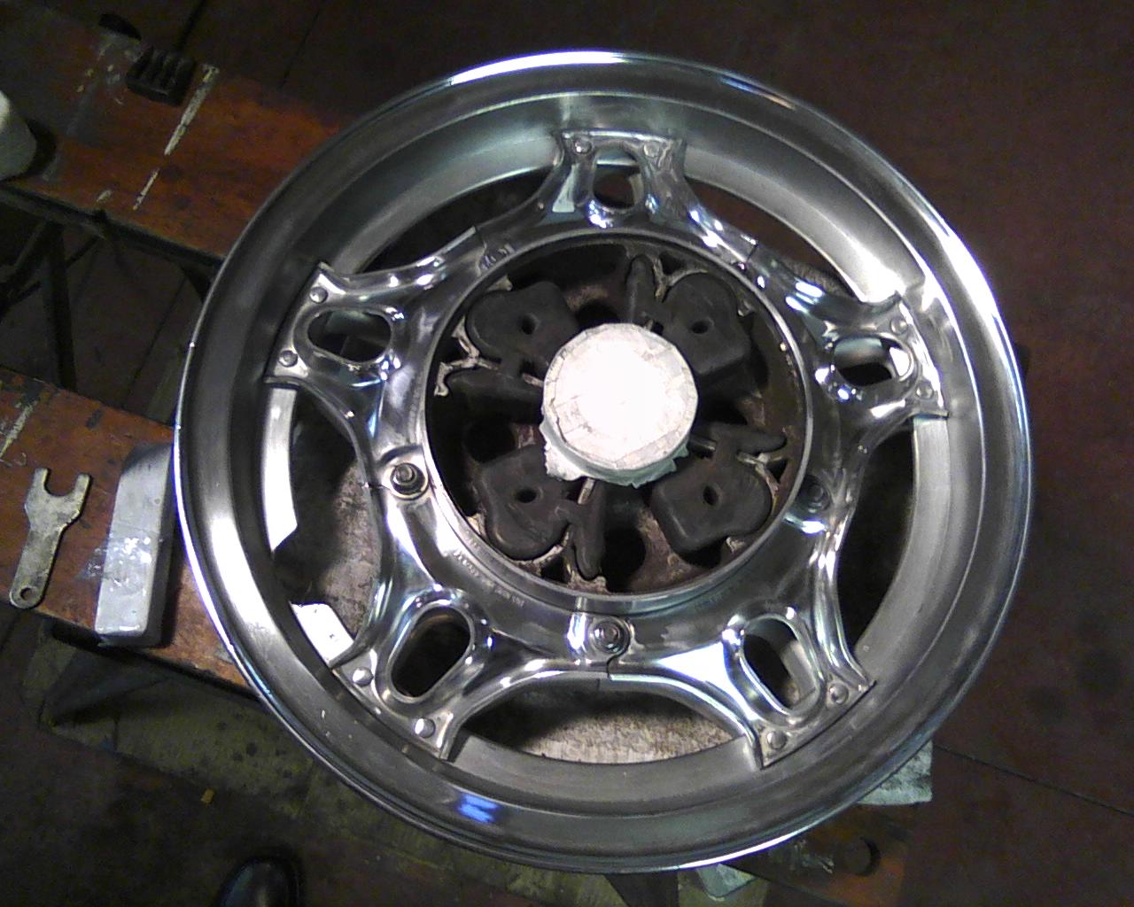

And as far as the OP question, I vote "Neither".
They're rather pretty under that fatory coating.

Hoosier Daddy said:
Retainer is staked along the threads and you should drill that punch mark out before turning... Like crazypj said, it's in the manual.
I wish I had your patients HD
