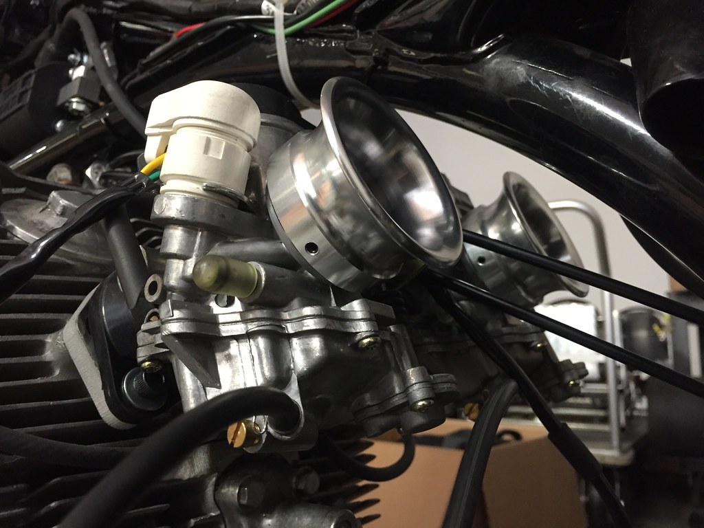

A while back I decided to attempt something really stupid and do an EFI conversion on a 1962 CB77 Superhawk. I failed miserably. After a couple years of trying to get the antiquated ECU and poor quality components to work, I finally gave up, and the bike sat in the corner of a shop with barely any sunlight to keep it company. Recently, however, I decided I would trying something slightly less foolish, but still not conventional, and install modern CV carbs on the bike.
It started up and ran, one cylinder at a time thanks to a cracked spark plug insulator, a couple weeks ago before I had to leave on a work trip. I came back a day ago, installed a couple new plugs, bettered my gasoline IV system to run without the tank (more on that later), and got it running on both cylinders. With some rough tuning plugged in, the bike idles and revs phenomenally! The modern carbs offer significantly better response than the old round slides, and allow me the ability to tune many more patches of running conditions to smooth it out. The Elekronik-Sachse crank-fire ignition module is fantastic, and works like a mini-ECU, rev limiter and adjustable advance curves included. I made some throttle cables, wired up the autochoke systems, set the timing, and I couldn't be happier with how it runs right now. It is so much closer to a rideable bike than it has been in the last half decade that I felt I had to start a thread about it!

Stay tuned! As I said, I'll try and document my solutions for all these issues. Perhaps other people will come across them or have come across them, already. Until then, enjoy the few photos and videos I've taken since I pulled all the Ecotrons ECU stuff off the bike and installed these OKO CVK 26mm carbs and Elektronik-Sachse igntion.

Nice one. Interesting carbs and gorgeous bell mouths. CV carbs typically flow around 85% or so of the same sized slide carbs because of the flow disruption from the shaft and butterfly, but those seem to be working fine so far. Race kit seat is a nice touch.
A carb that works well on a CB77 is the CB750 SOHC which has the same 26mm slide diameter as a CB77 but taller oval bore that equates to a 28mm round when fully open.
Yeah, Bob Guynes was trying to push me that way. I am a huge fan of CV's and generally anything with enough tunability to weed out any lean spots. The old stock carbs were terrible and constantly needed adjustment to be right. In the northern Peninsula here in the Bay Area, I was struggling with the 20-30 degree temperature swings we see from morning to late afternoon. Running with the choke partially closed seemed less efficient than a CV carb running with the slide 90% open. Regardless, I couldn't be happier with how this thing fired up and chugged along after sitting for 5 years, and not running for 3.
I have a NOS CYB racing cam, piston set, and valve and spring set that I may build into a spare head I have knocking around. I'd love the tunability of these carbs, still for road use. I may, at that point, go up to a 30mm CVK which appears to use the same manifold fitting I.D. I might port up to 28mm, lose or modify my step down rings I had made, and get it a bit better at higher RPM. That is for a year or so down the road. I want to ride this thing NOW, as is!
Sounds like a plan. Race kit cam will work on the street. The timing and lift are quite mild and the ones I have done cam lift plots of have nice gentle silencing ramps.
30 CVKs might be just what the doctor ordered and with those velocity stacks, they look like sand cast CRs from a CR77.
