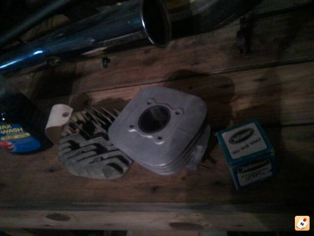

I finally have it running but, not as good as it could.
http://www.youtube.com/watch?v=TKLgNeg3ZOA
It has a tight bottom end with all new rotary valve parts.
Yesterday I pulled the top end and found a poor looking cylinder with signs of a previous dropped ring. I cleaned it up and put new rings and starting searching for new parts.
I found some vintage single ring wiseco ts100 pistons. Got on the phone with the guy that use to do my moto bikes when I raced and he said he would fix me up.
I ordered the pistons and a cylinder with a head. I will be dropping them off to him as soon as I get them.8)
My plan for this bike is leave it as original I can with a radical motor.
