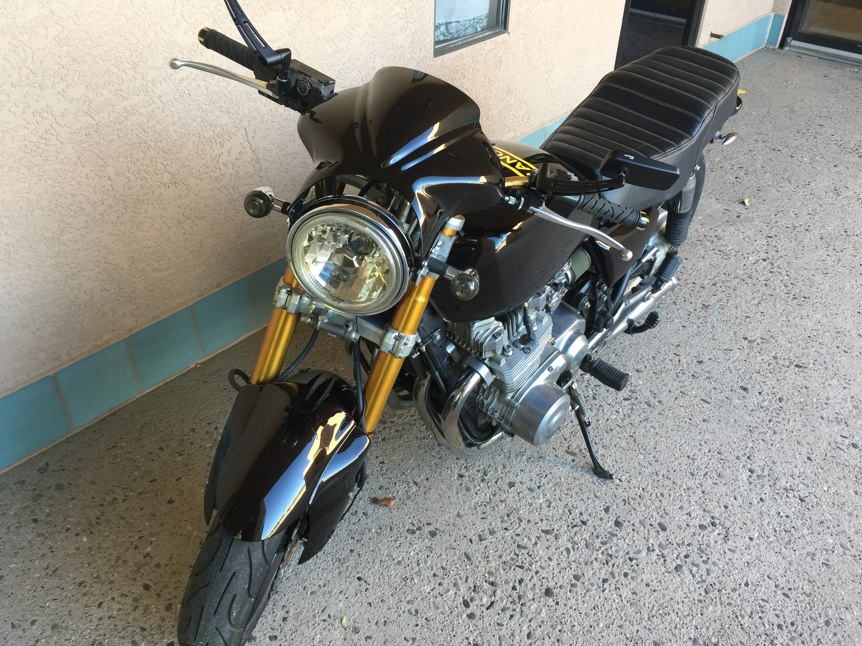

I put the front end all together and have been riding the bike for a few weeks now. All in all it was definitely worth doing the swap. I have on order a koso all in one gauge. and am planning to add a cafe racer style tail to the bike Which will include removing the dip in the frame. Here is the bike how it is currently. I recovered my stock seat for the time being.
