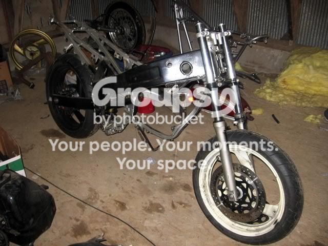

A couple of guys on here seemed interested in a build thread for my current build, so I thought I would start one here also. Although this build has been going on for over a year now, there is still plenty to do. Here are some of the starter pictures and current pictures of the build.
Beginning:
Current:

Quick list of parts:
- 1989 Yamaha FZR600 Frame
- 1977 Yamaha XS650 engine
- 2005 Kawasaki 636 forks, triple trees and front calipers
- 1998 Honda CBR600 F3 front wheel and front calipers
- Custom front axle
- 1994 Honda CBR600 F2 swingarm, rear wheel and rear brake setup
- Custom swingarm pivot bolt
- Honda Interceptor VF500F cush drive
- 2009 Kawasaki ER-6n rear shock
- 2001 Buell X1 Lightning subframe
- 2005 Suzuki SV650 taillight
- Custom fiberglass undertail
- 2001 Harley Davidson FXDWG2 Headlight Fairing (will probably not be used though)
There is a lot more custom work that will be going into it when I get there.
