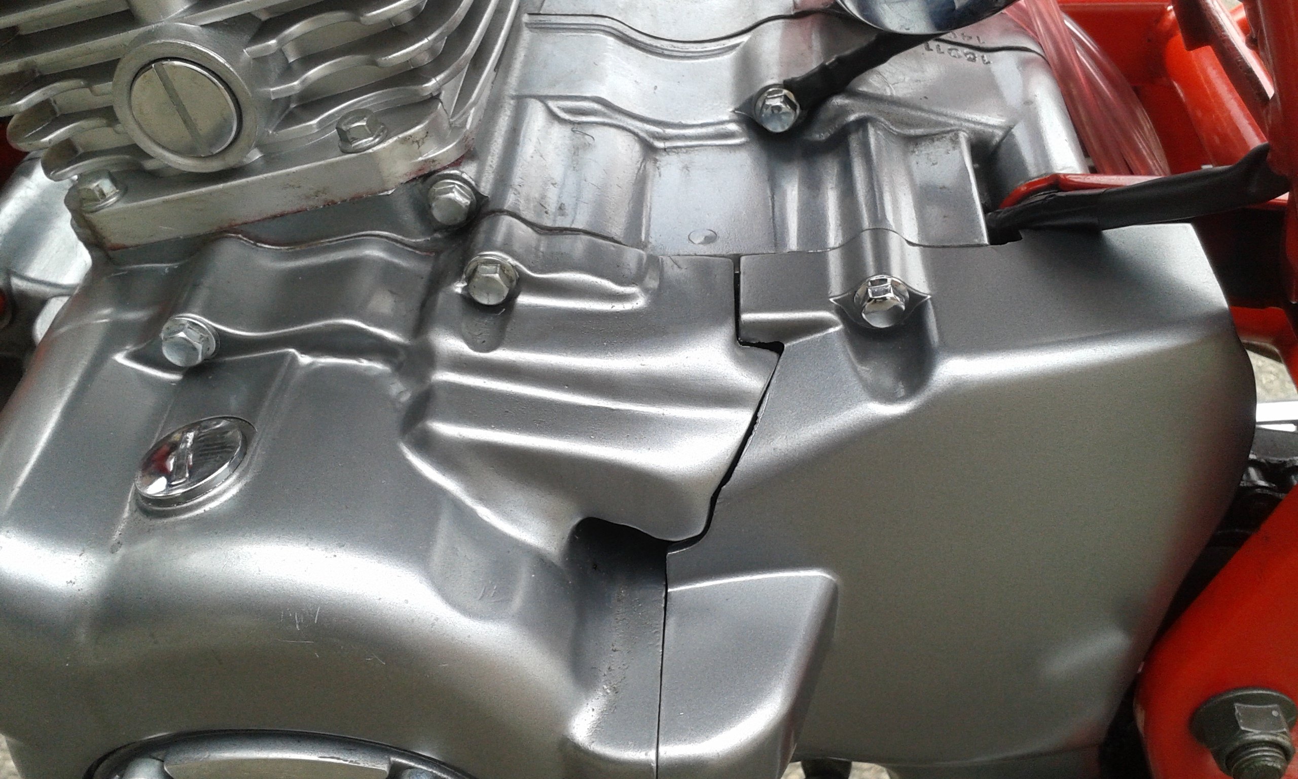

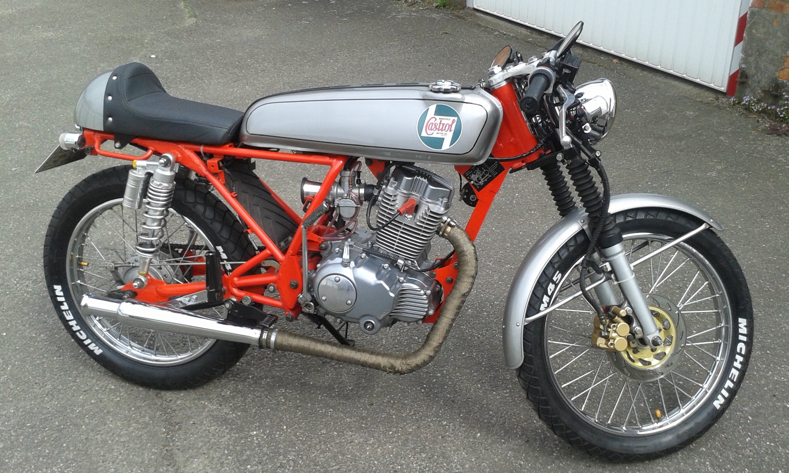

I've been pretty busy this past winter. I got a few things done with some help from a friend. We got some better compression with the big valve head ( I was driving the big bore kit with the 125head) , the porting is done, got some new valves in and removed every trace of the electric starter engine.
Now I would like to try a better camshaft. I've been looking at some Brazilian sites. I would like to try the wgk 1010851.
From wich website did you order this cam, because most of them seem to send their parts only to Brazilian adresses
thanks guys
Ruben
