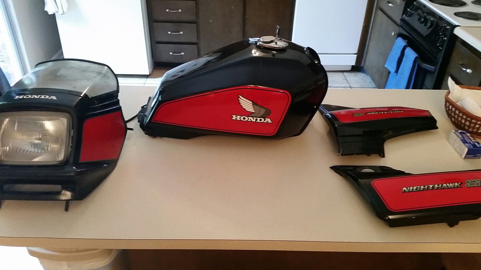

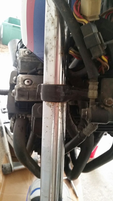

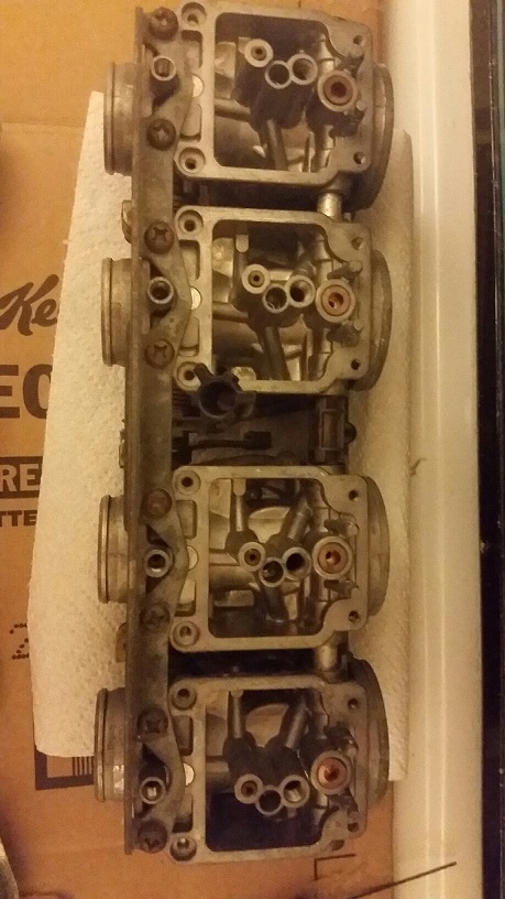

First on the list of course is a good old carb cleaning. Little bit of pine sol and elbow grease got those going, and first start up revealed a tick from a tappet (video) and a cracked oil pan. At this point I think I'm going to pull the engine since I have to remove the cam. I'll inspect the rings and cylinders. I don't want to make the same mistake I made with my cb350 (view thread in sig) by doing a patch job. Other than the tick the bike sounds great. Also used some aluminum foil and marvel mystery oil on the forks to get rid of some rust...works pretty well. Now to build a small workbench and find a friend to lift this beast of an engine. Don't think I can do it alone like the 350. And also a special thanks to dreadrock for helping me complete my body part collection for this project. Looks a lot better then the rusty red white and blue murica tank.

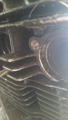

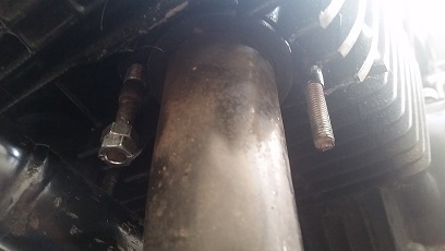

Well, I am hopeful I found the issue causing the tick heard in the video above. My oil pan had a small crack leaking oil everywhere so I started removing the exhaust to get to it today. Upon removal the cylinder nearest the noise had some interesting work done on the studs. As you can see one didn't even have threads an inch or so away from the head. Hopefully that's the issue. Also there wasn't a single copper crush gasket present. I got extra lucky and removed the questionable stud by hand.

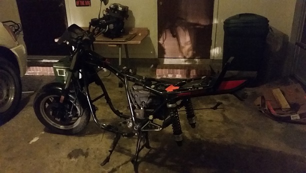

Progress...I guess this picture signifies the point at which the "mild" in the title no longer makes sense, and is just mocking me for assuming it just "needed the carbs cleaned".

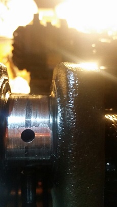

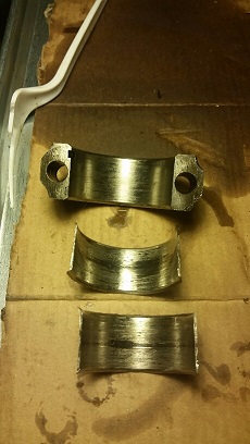

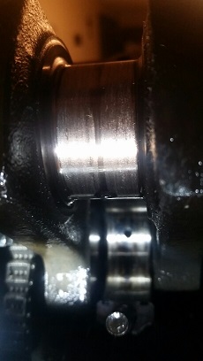

Got the engine split and started assessing the damage. I have learned a lot about inspecting bearings and digging into the engine. Unfortunately I don't think new bearings are going to cut it. Bearings had spun/ were moving all around while I was disassembling the connecting rod, they actually were overlapping each other a lot. I'm fairly certain the connecting rod and crank are toast from the looks of it. If anyone more experienced could verify by looking at the pictures I would greatly appreciate it. D*** this nighthawk.
To be honest it really doesn't look that bad, mostly bearing material. Measure the rod journals to see if they have lost or gained material. Measure the i.d. of the big end of the assembled rod to see if it has lost or gained material. If they are within spec, clean em up and get some plastigauge results to see if there is a bearing option that is the right size.
Or, it's a 700 nighthawk. Just burn it.
Hmm, What is a good method to remove the bearing material? I didn't consider some of that could be left over from the bearings. Ill have to borrow some calipers from work I only have plastigauge at the moment...plus im drinking now...I am starting to understand the general hatred of nighthawks lol.
