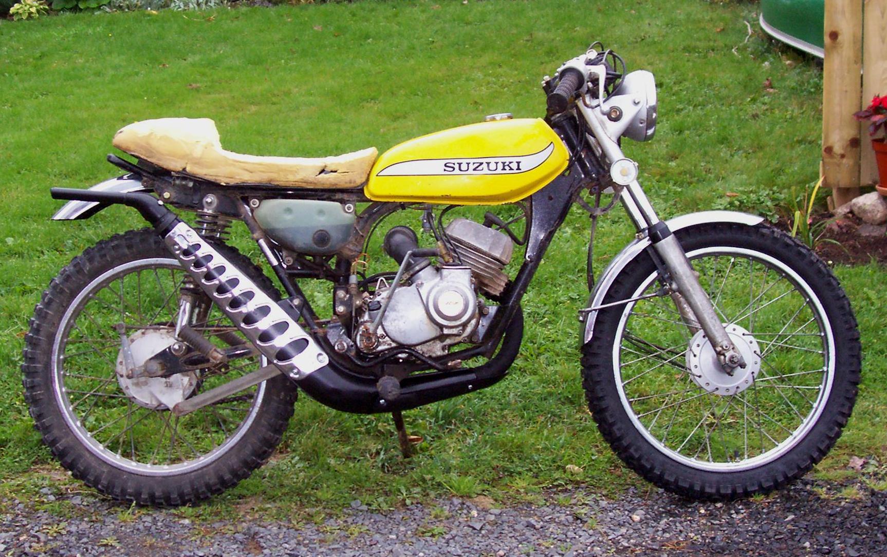

Anyhow the machine had progressed quite far beyond the photo, but this was what I was looking at in the early stages of the job.

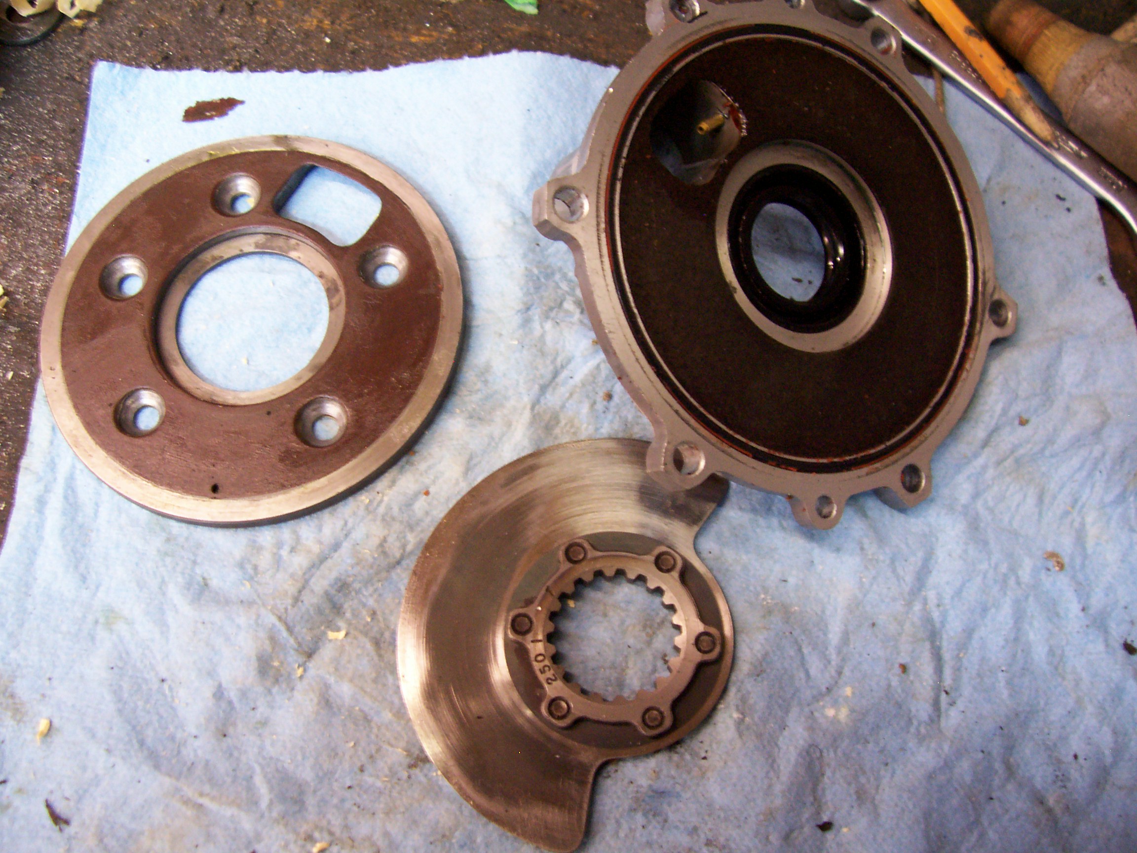

On to the engine...it had been running, but not particularly well. Upon removing the little unit, it was off with her head and I discovered that at some time in a former life, it had been subject to some sort of catastrophic failure. The combustion chamber was all banged up particularly in the area of the squish band. I mounted the little head in the lathe and machined away most of the beat up metal, then machined away about 0.010" from the head gasket mating surface to account for the loss of compression that cleaning up the combustion chamber would cause. The piston was new and 1.00mm oversize, so some previous owner must have had it bored. New rings were fitted even though the ones I removed had only very minimal wear. Everything received a good cleaning and the top end was reassembled. I noticed the clutch cover had been removed and decided to investigate...upon removing the cover I also noticed that someone had had the cover off the rotary valve and so the clutch was removed in order to check out that unit. Turned out that the rotary valve had been installed backward and there was some damage to the bakelite surface on the inner valve cover...the outer one was in perfect condition. I removed the old cracked bakelite and after bonding a piece of phenolic resin to the inner cover, machined it to specs, but having done some further research discovered that the sealing surface on the inner cover was dropped from production and plain steed was used in its stead. I didn't want to chance the new repair coming apart and causing more problems, so I opted to go shopping on Ebay and buy a new replacement. The frame has been cleaned and painted while waiting for this part to come and that is about where the project sits at this time.
Rotary valve and covers after repairs:

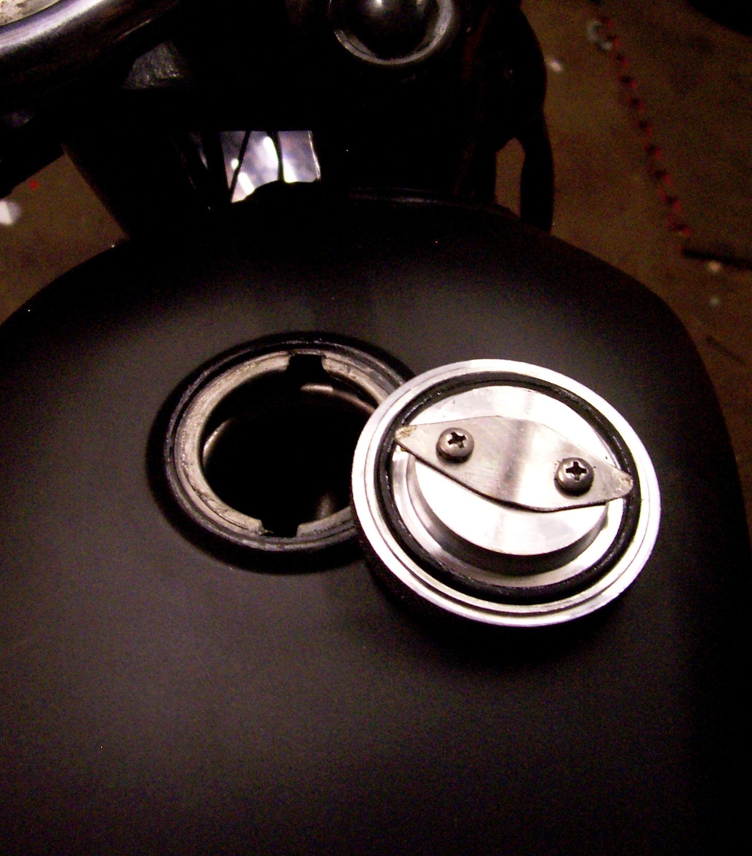

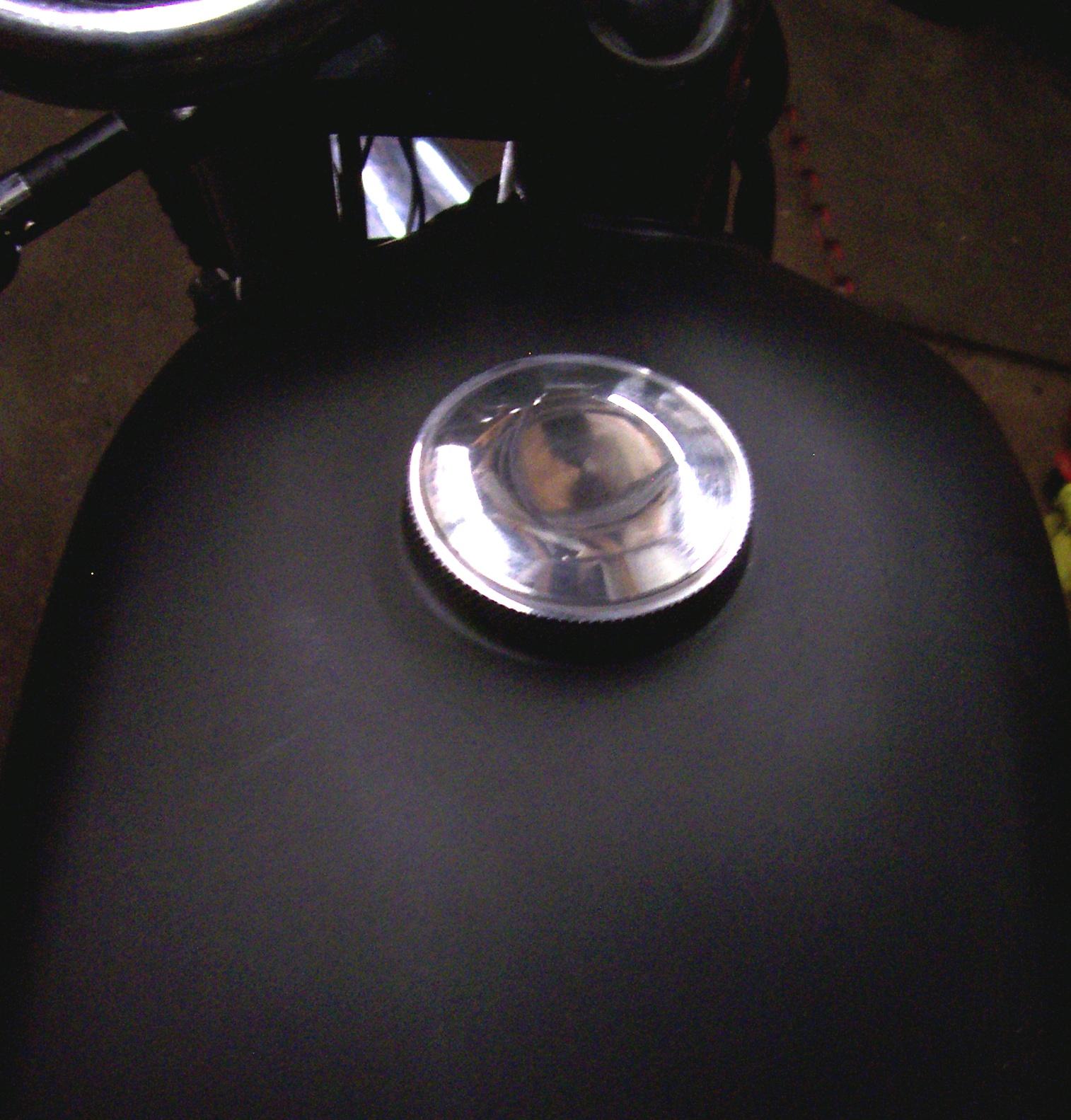

The seat is still at the upholsterer's shop, but I hope to get it back soon. With all the visiting, eating and other running around that comes with the Holiday Season, I was beginning to experience symptoms of 'shop withdrawal', so I warmed up the shop yesterday, chucked up a hunk of 3" aluminum rod stock and machined up a new gas cap for the new tank...yeah....I know you can buy them, but where's the fun in that? The bike will go on the lift today, or Monday at the latest to have the back tire changed along with new sprocket, drive buffers and chain.

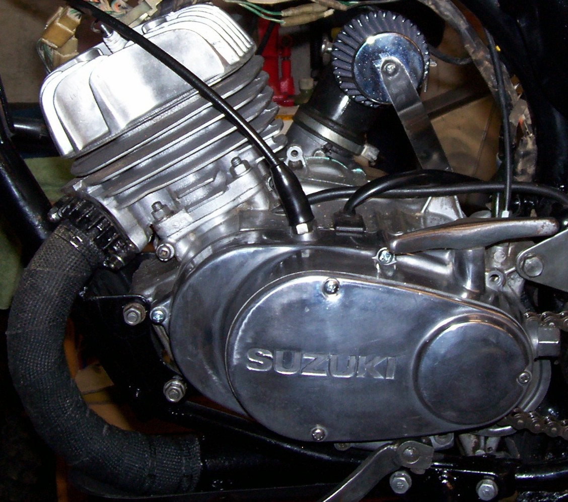

Made some pretty decent progress this week....in spite of the bitterly cold daytime temperatures, I managed to heat the shop up to a reasonably comfortable degree. Got the engine mounts in place, got the carb rebuilt with the help of a "parts carb" I purchased a few months ago. Checked all the electrical equipment, charging diode, ballast resistor etc and everything tested out properly. New chain cut to length and fitted. Oil tank is now in place and pump bled and adjusted. Found the time to repair a couple of bad cracks in the side covers...the mat black is primer, but since the bike will be black anyhow, it is probably the best choice. Even stuck the exhaust back on...another week like this and I should be just about done. Still no seat!

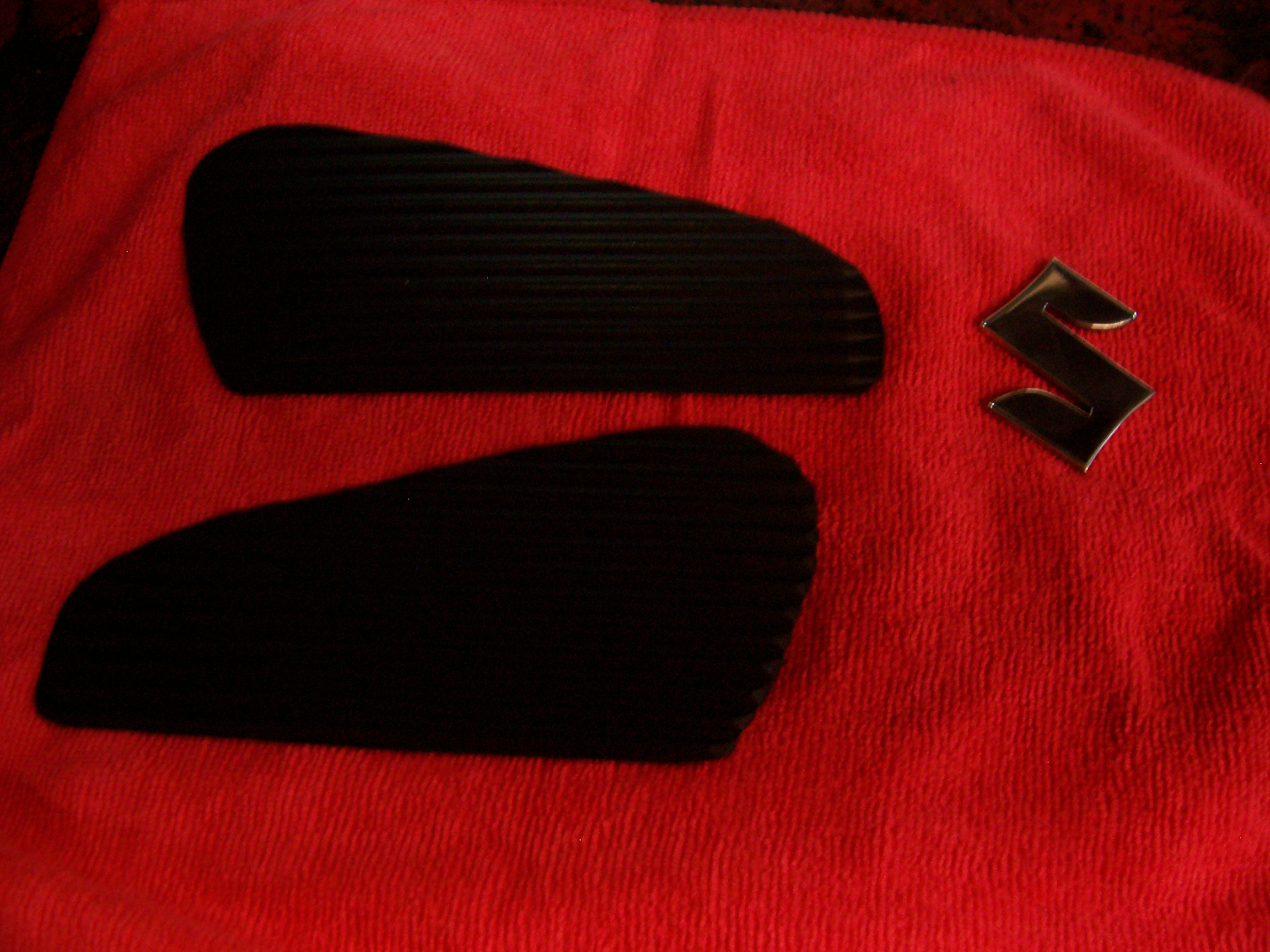

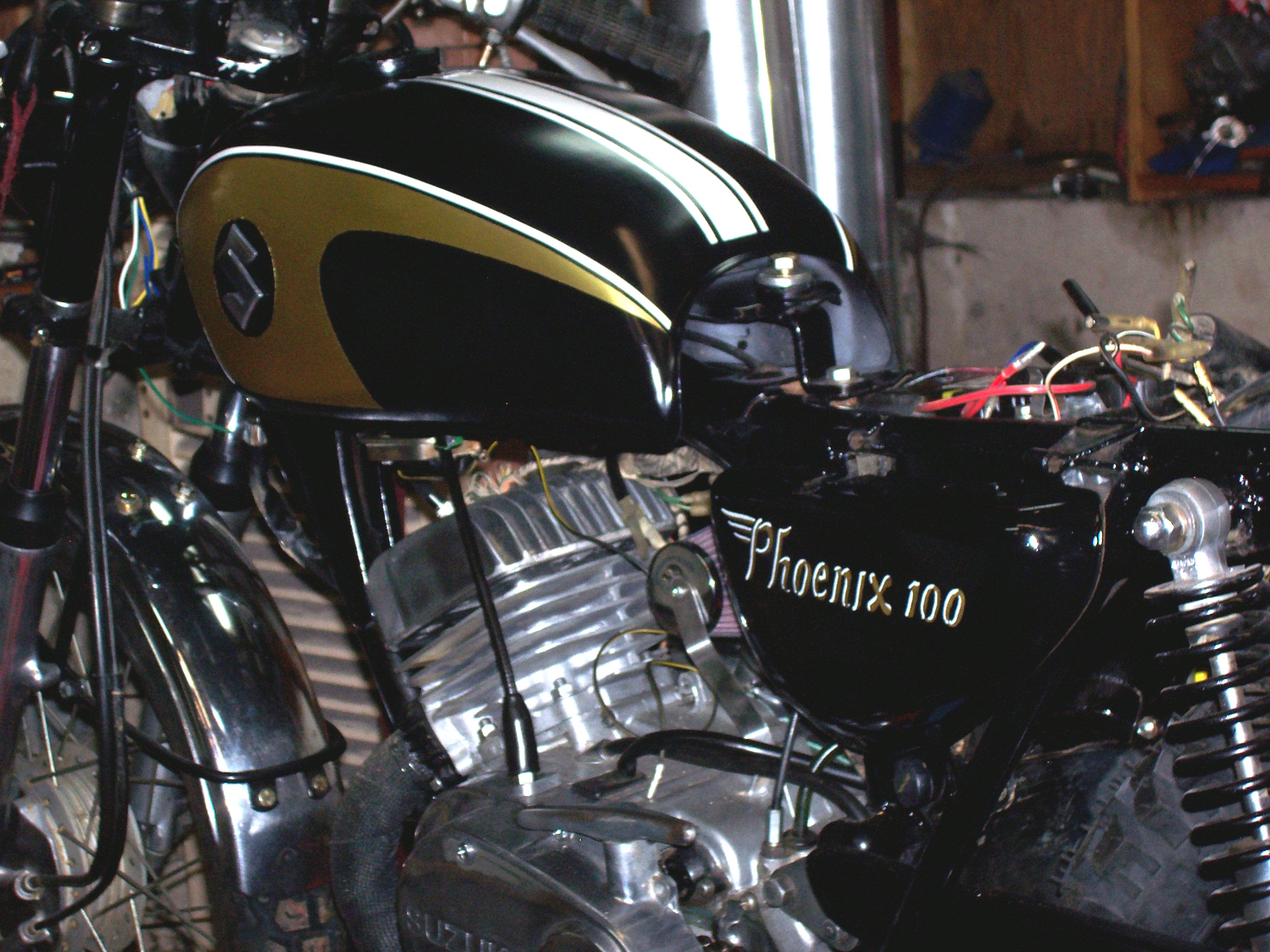

Got most of the paintwork on the tank and side covers, made up a couple of polished aluminum Suzuki symbols and cut out some rubber knee grips to add once the clear coat is applied...now to finish off the electrical system. Still no seat!
i'm not a big fan on the side cover lettering...I think I'll just repaint them in plain black.

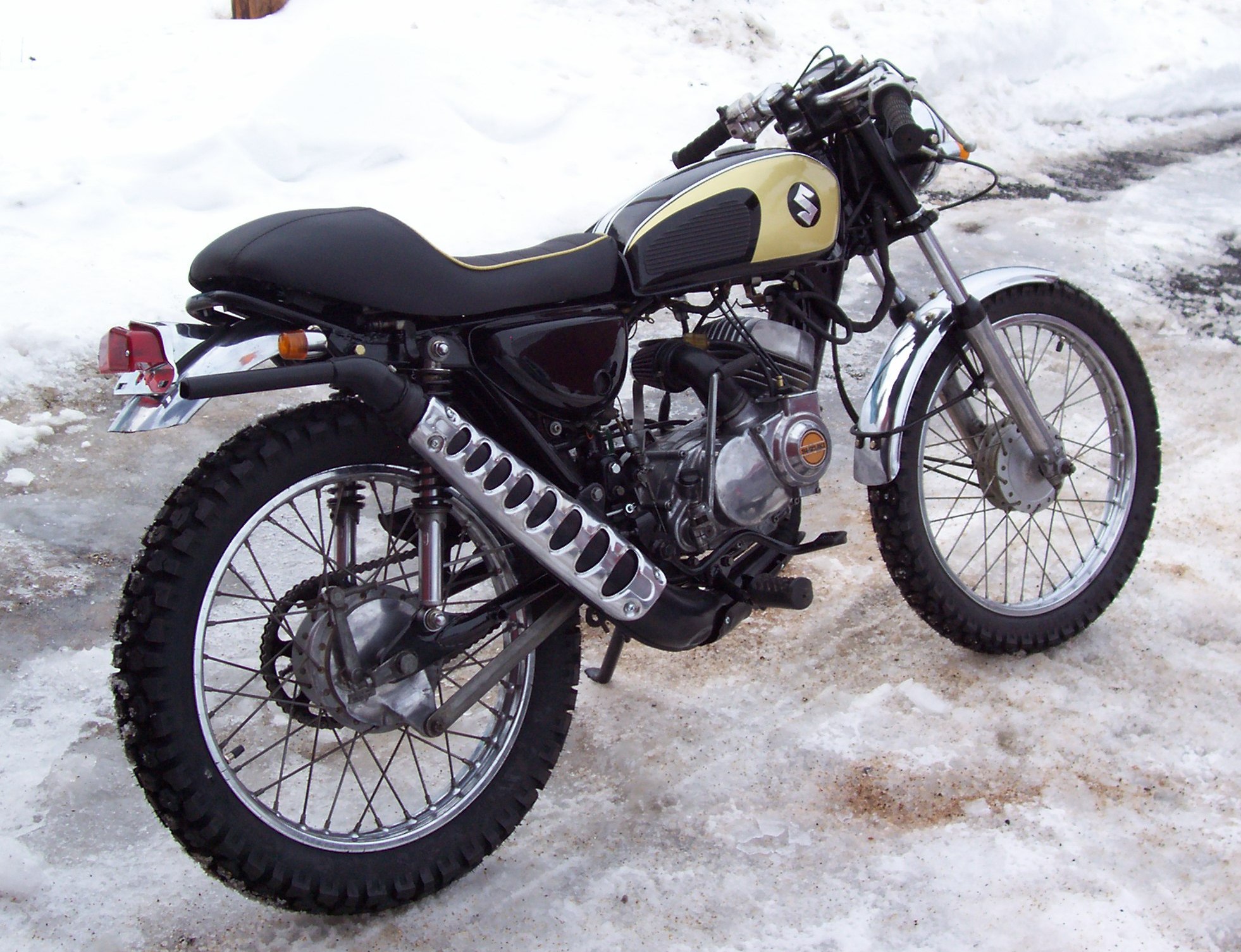

Good progress again this week. Repainted the side covers and applied three coats of two part clear urethane to the paint work. Electrical system all sorted out. Today I fired-up the engine for the first time since it has been back together, everything seems to be doing just what it is supposed to do. Stunk myself out of the shop in about three minutes flat. Now if only winter would bugger off just long enough for a little test ride...if it does it'll be a rough ride; no seat YET! Damn it Jody, where's that seat???!!!!
Yahoo....seat is finally done! Now if it would only stop snowing long enough for me to go get it. :p

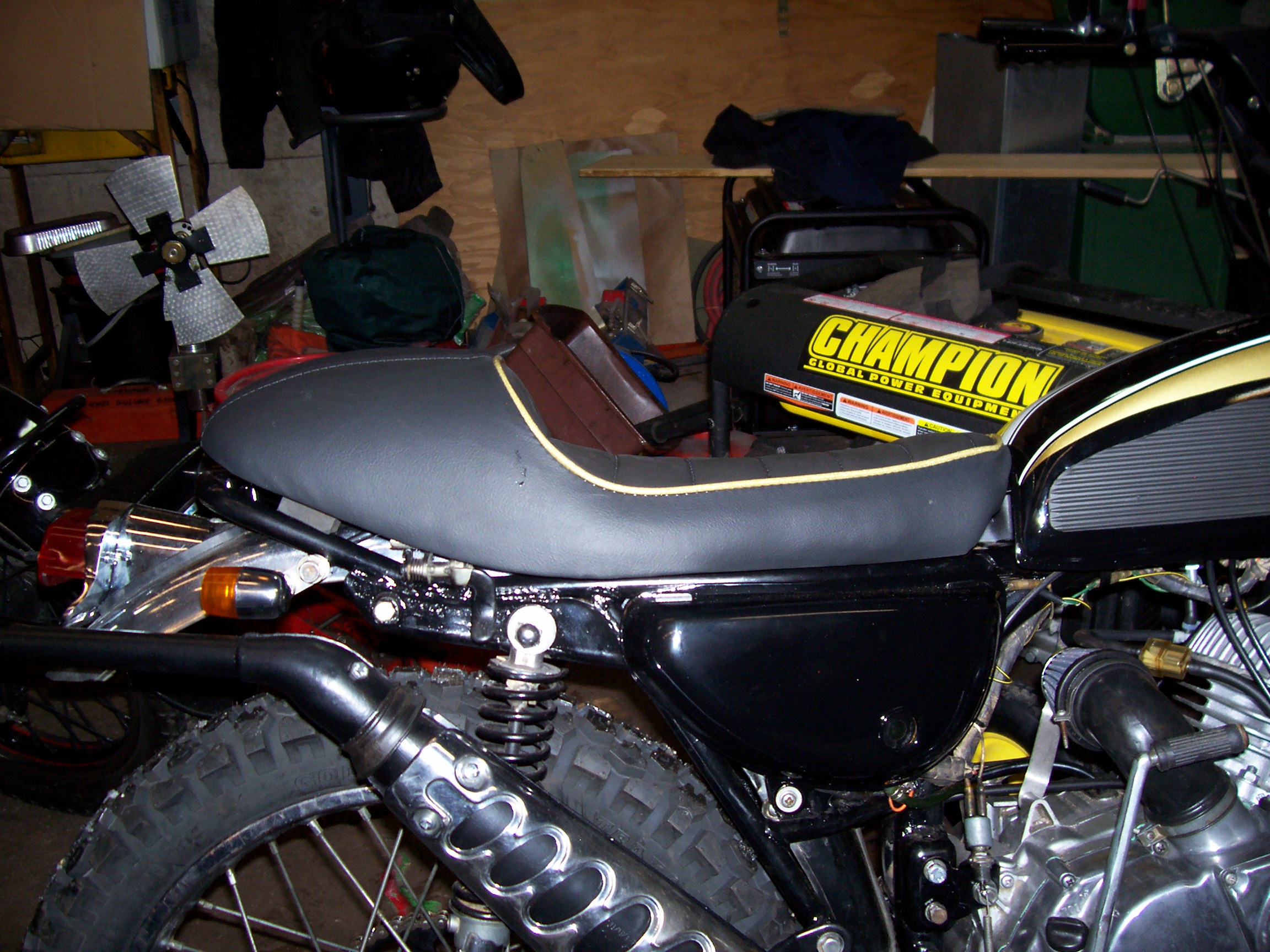

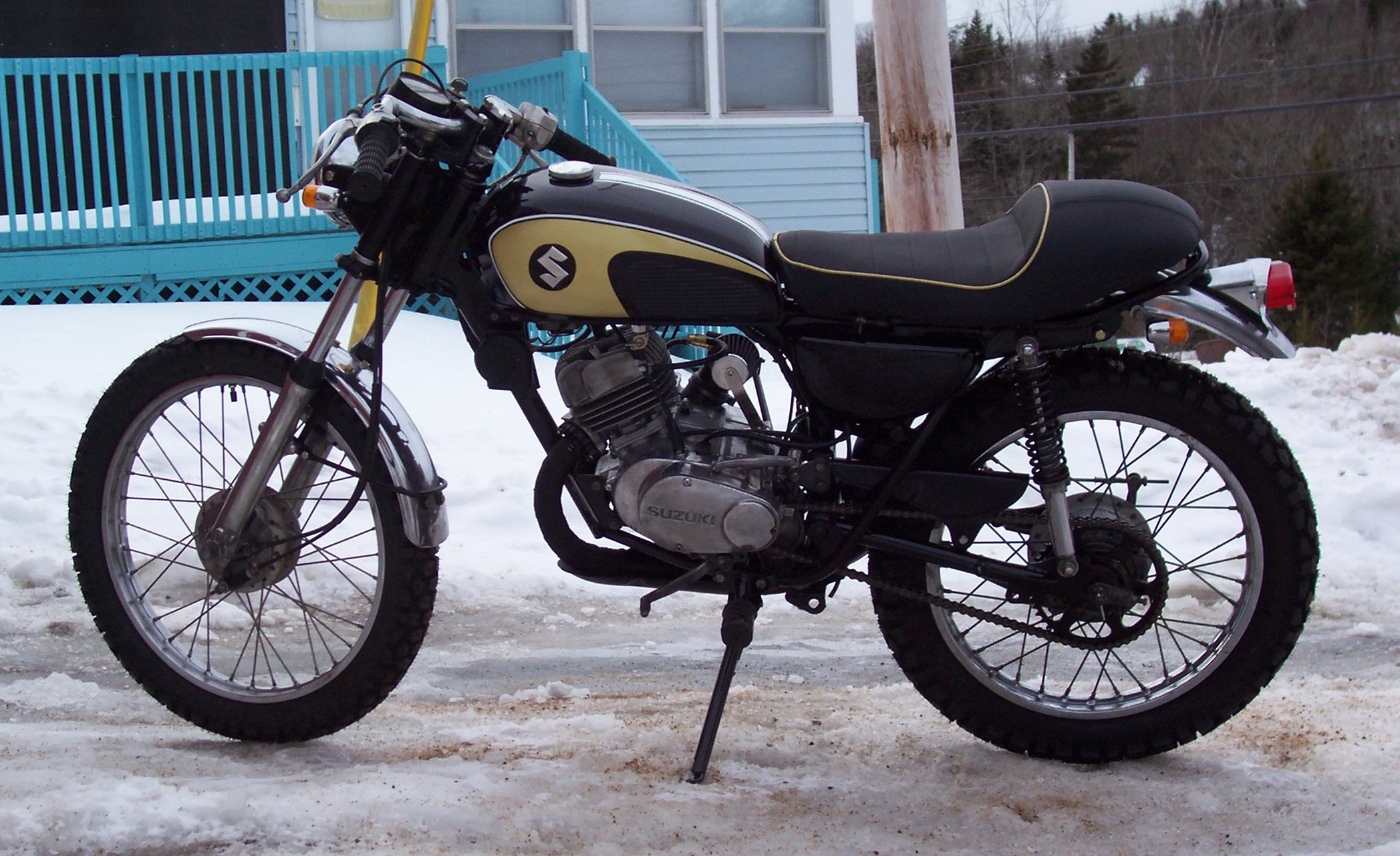

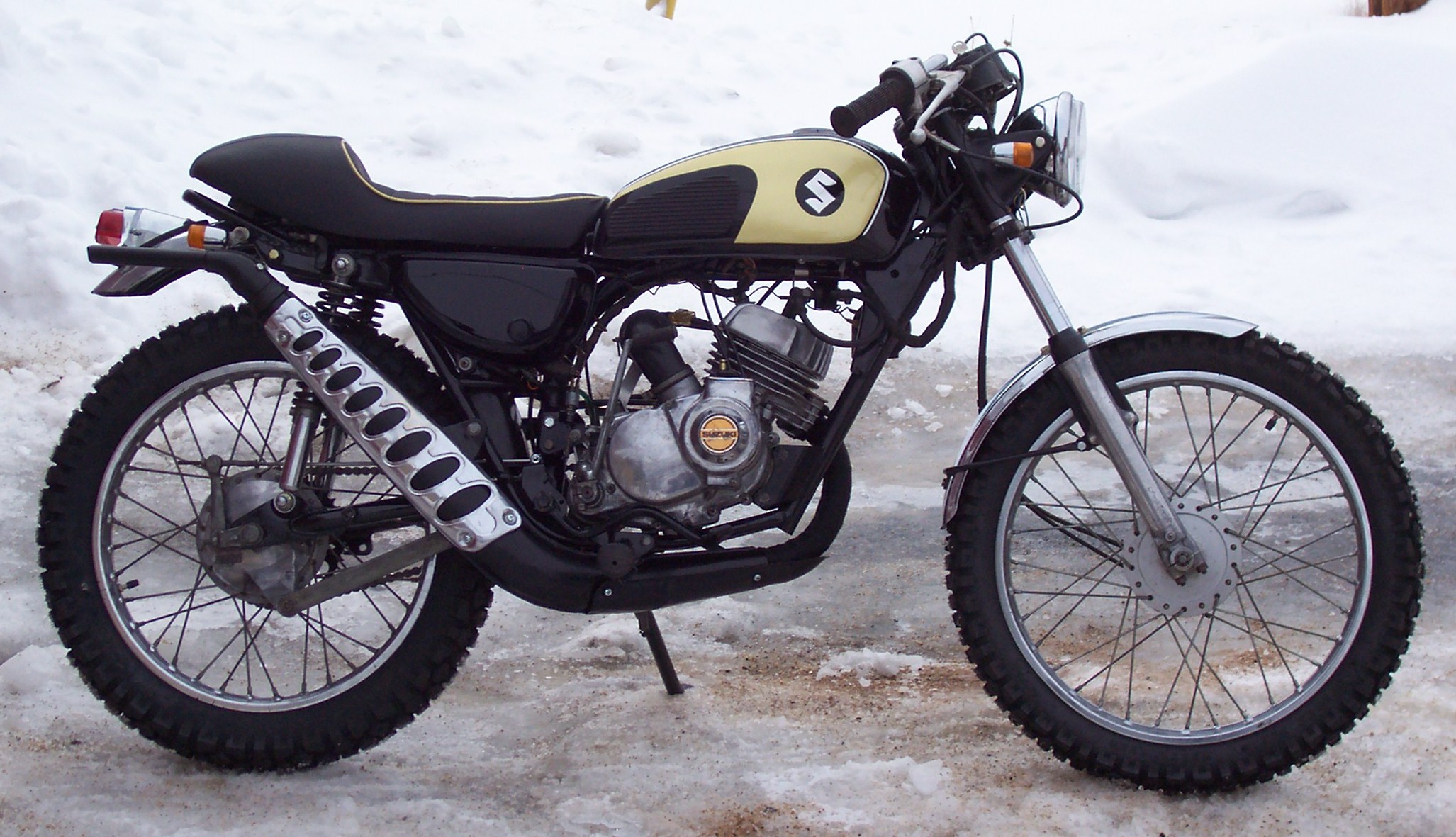

Finally got the seat...excellent work and exactly what I had asked him to do.
Anyhow, it wasn't in my hands five minutes before we stuck it on the bike and stood back for a look. After that I took it outside for some snowy pictures...I guess that's about it for this build, just needs a mirror and a road test, but that will have to wait until warmer weather comes our way.
