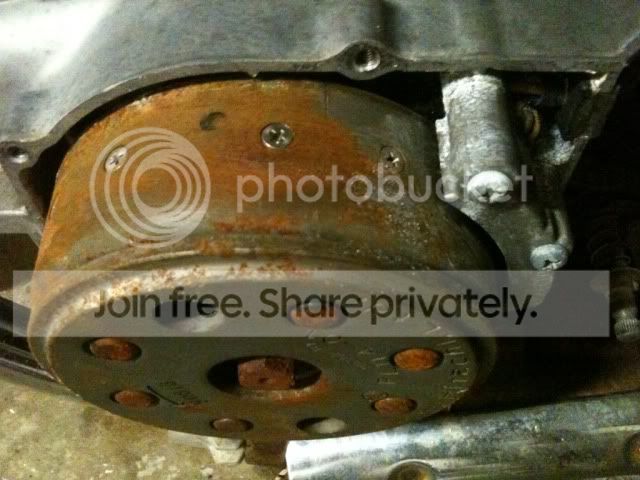

I ohmed the stator and it is fine. Soaked one carb in simple green, the primary main jet was stuck. Ended up stripping out the head of the jet so I had to drill it out. I'm soaking the primary jet on the second carb in PB Blaster before I bath it in simple green.

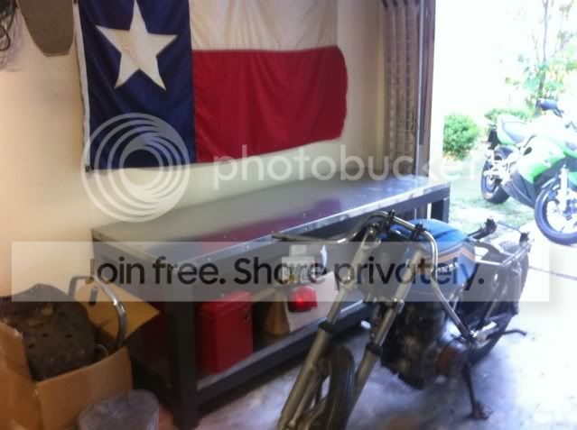

Here is the ol' girl for now. Just made a work bench/table.

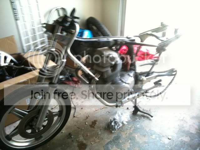

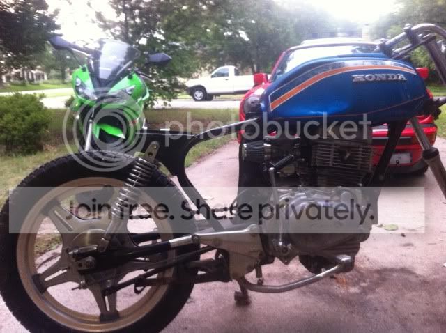

Cut some of the frame off. Mostly pictures. A lot of man hours going into polishing the carb parts right now...
