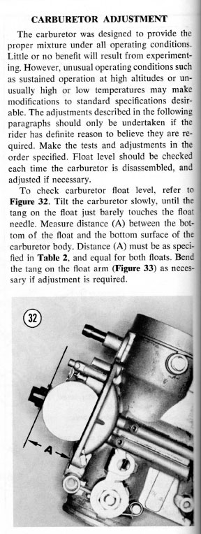

Also, I have the carb section of the Clymer manual scanned that actually documents setting the float height pretty good, along with a nice picture. PM me your email address if you'd like it.
Here is the section for the float height

Good question. Actually float level is more or less the corollary of Fuel level. The "higher" a float is, the further it is from the gasket surface and the LOWER the fuel will be in the bowl.
What we are trying to do is to change fuel level but on most carbs, it's hard to do because it requires a modified float bowl with a clear tube attached. Most riders don't have a spare float bowl to modify, so carb manufacturers came up with a way for us simple folks to adjust the floats instead. What we want is for the fuel level to be around 3mm below the gasket surface in most cases.
The key to doing a float level check is to carefully and slowly tilt the carb as described above.

I checked the float height and theres no way that it could be 21mm which is the height im finding everywhere – or at least if im supposed to measure the way the clymer manual says (see p.1 of this thread). I didnt have a guage or ruler but A = 18mm +/- as set. I made a jerry rigged guage that sat on the gasket surface and capped at 21mm and brought it with me to the garage to set the height, If A = 21 they would be all the way down. which I assume is incorrect. what am I doing wrong here?
