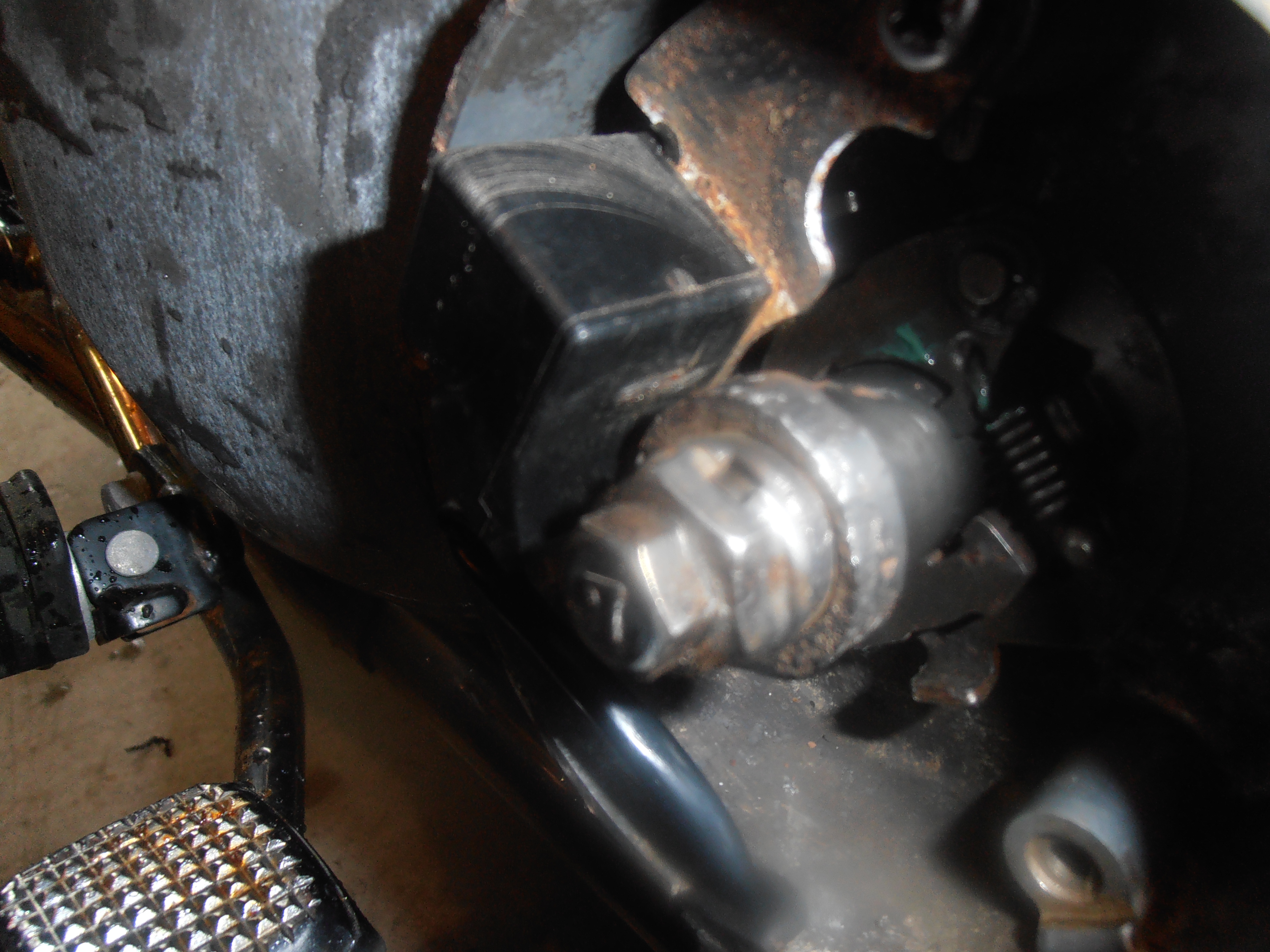

hey guys, glad to be back on the site. Spent the last little while with my mid 90's sportbikes but now have a 440 ltd destined to be a rat/ cafe. I have a question about pic 1 that I have cleaned up to look like like pic 2. Essentially is it usable even with all its pitting?
The bike turns over, has spark, has compression, will run for few seconds with carb cleaner sprayed in carb.

If it fires, you should be good to go. Keep the advancer oiled (maybe a light coat on the rust pits too) so it doesn't freeze up. Later on you might discover that the coil may need replacing (seems like lots of '80s bikes' coils are now needing replacement). If so, replace all the ignition stuff (coil, wires, caps). Now on to the carbs!
started on the carb 1 today and the main and pilot jets (think thats thier names) are plugged solid. No wonder it wouldn't run. Off to work next week. Will post some pics and progress next week. Good to know those ignition parts may be salvagable. All the ebay stuff looks as bad as mine.
