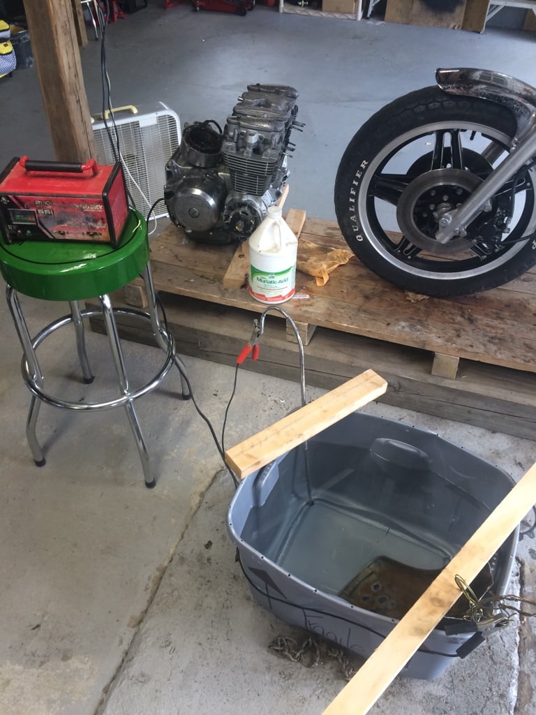

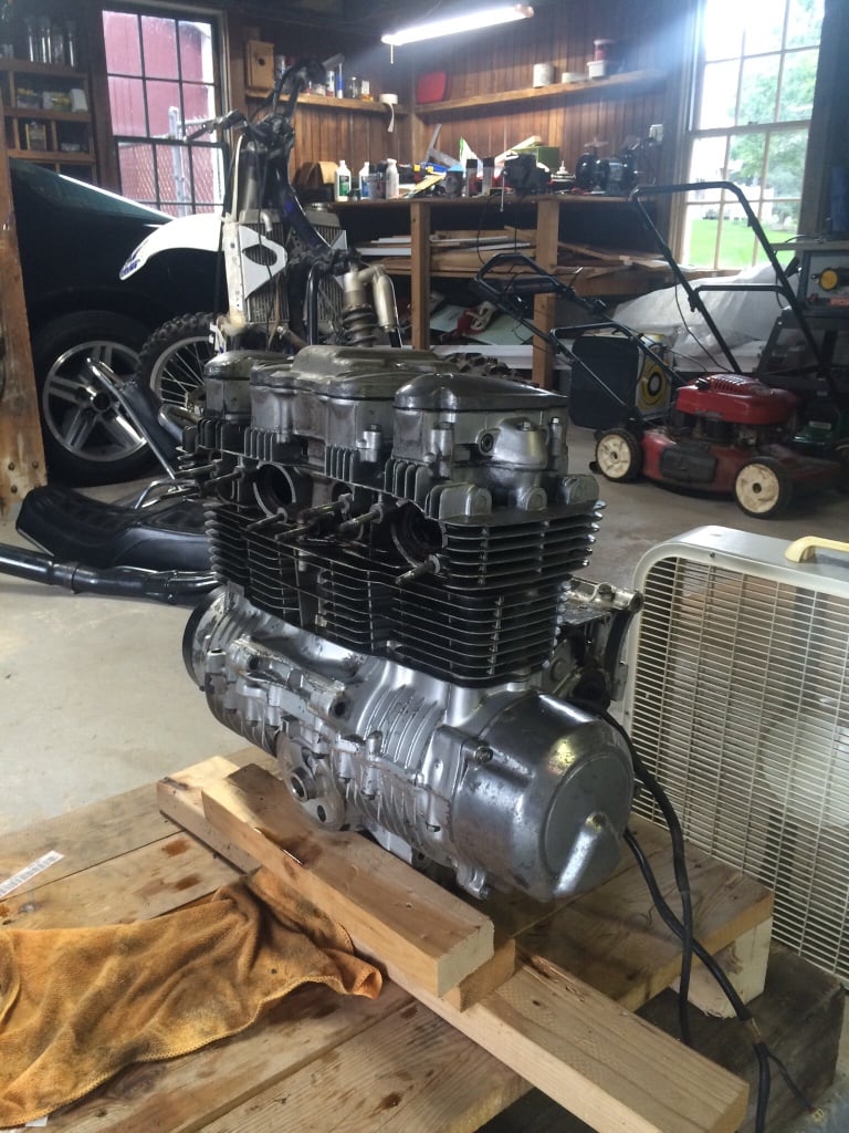

Welp the engine is out...
At least now this will give me an opportunity to paint the frame. Also was able to get the grips and handlebar installed.
I ordered a gasket set and piston rings so until they get here I am just taking apart the engine, then cleaning and painting all the covers. Put a breaker bar on the bolt in the middle of the alternator and still no luck. Which wouldn't be a big deal since I already have the engine out and planned on replacing the rings, but because of the engine being seized I wasn't able to rotate the camshaft to get the second bolt off of the cam sprocket. So unfortunately I had to cut the chain. So if anyone knows where I can get a replacement chain it would be greatly appreciated!
Also made my first attempt at an electrolysis tub :)
It worked decently on the rear fender, although I didn't add any washing soda, but it still worked well enough that it probably saved me hours of cleaning and sanding.
