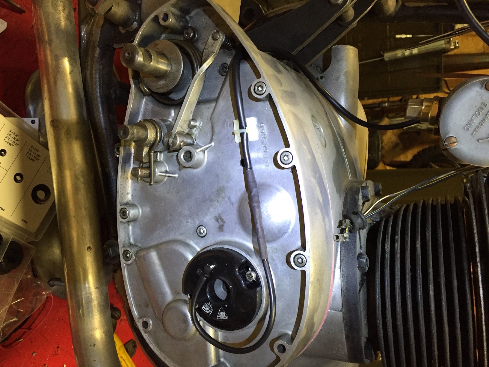

Getting the trigger wired up and looking to replace the sump filter with an SRM unit next, need to mount the coils but still struggling with where.

Okay so the BSA 12v ignition uses 2 YUUGE 6v coils, I have a Wassel Vape e ignition and it says it will run with the 2 6v coils or 1 12v 2 wire coil ie cb750 coil the points setup is the same we all know that... I have used 2 5 ohm 12v coils in series or was it parallel?
Anyway i want to run a set of 12v 4.5 ohm coils totaling 5.2 oms when wired parallel or series, once i remember which I ran this on a flat tracker with a battery but no charging system just total loss way a while back. The question IS will the coils or ignition burn up if ran longer than a heat or say 25 miles with an alternator charging system and or can I prevent it with resistor caps or ballast resistor or condenser ???
I really just want small coils that tuck under the tank ::)

I would think that you would be better to run one double ended coil firing every revolution with a wasted spark. Assuming you don't have any plans to go to 180 or 90 or 270 or other crank configuration that is.
1 coil to hide in place of two. Won't that alternator work as 12V or is the stator the wrong type? I am sure that I ran my last T100 (57 variety) with 12v from an alternator but I don't recall how many wires it had. I ran a cap and zener diode regulator and simple rectifier IIRC and mine had a K2F magneto for sparks, so that was a minimalist lighting circuit. I never had any issues with mine that way.
Its a 3 wire 12v PG charging system I'm just working the ignition for now, I have a set of RD coils with the studs that make for a neat package but I think its best to get the dyna and just make a bracket for that up under the rear of the tank... pushing water up hill when I could be done again!
