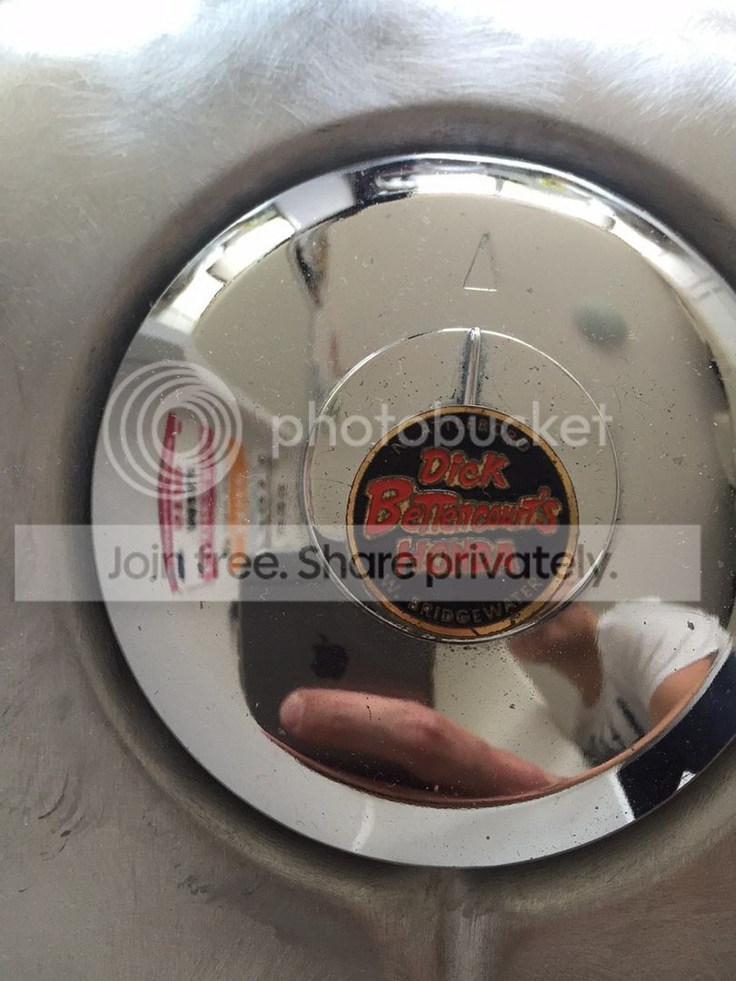

Keeping the original sticker from Dick Bettencourt's Honda

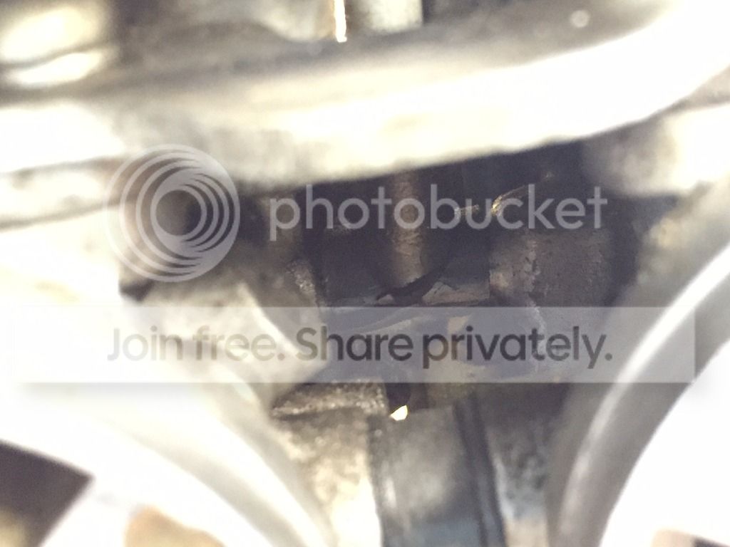

Some of the T hoses in my carbs cracked while removing the carbs. I replaced both T's with original ones ($$$ :() but I'm having trouble assembling the carbs again.
The carb issue is fixed and working fine right know.

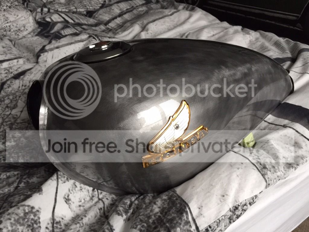

Tank will get a clear coat this week.

Got my tank back, came out great with the clear coat!

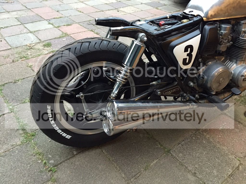

The weather was good so I took some pictures today. I also replaced the stock shocks today with some longer black ones.
