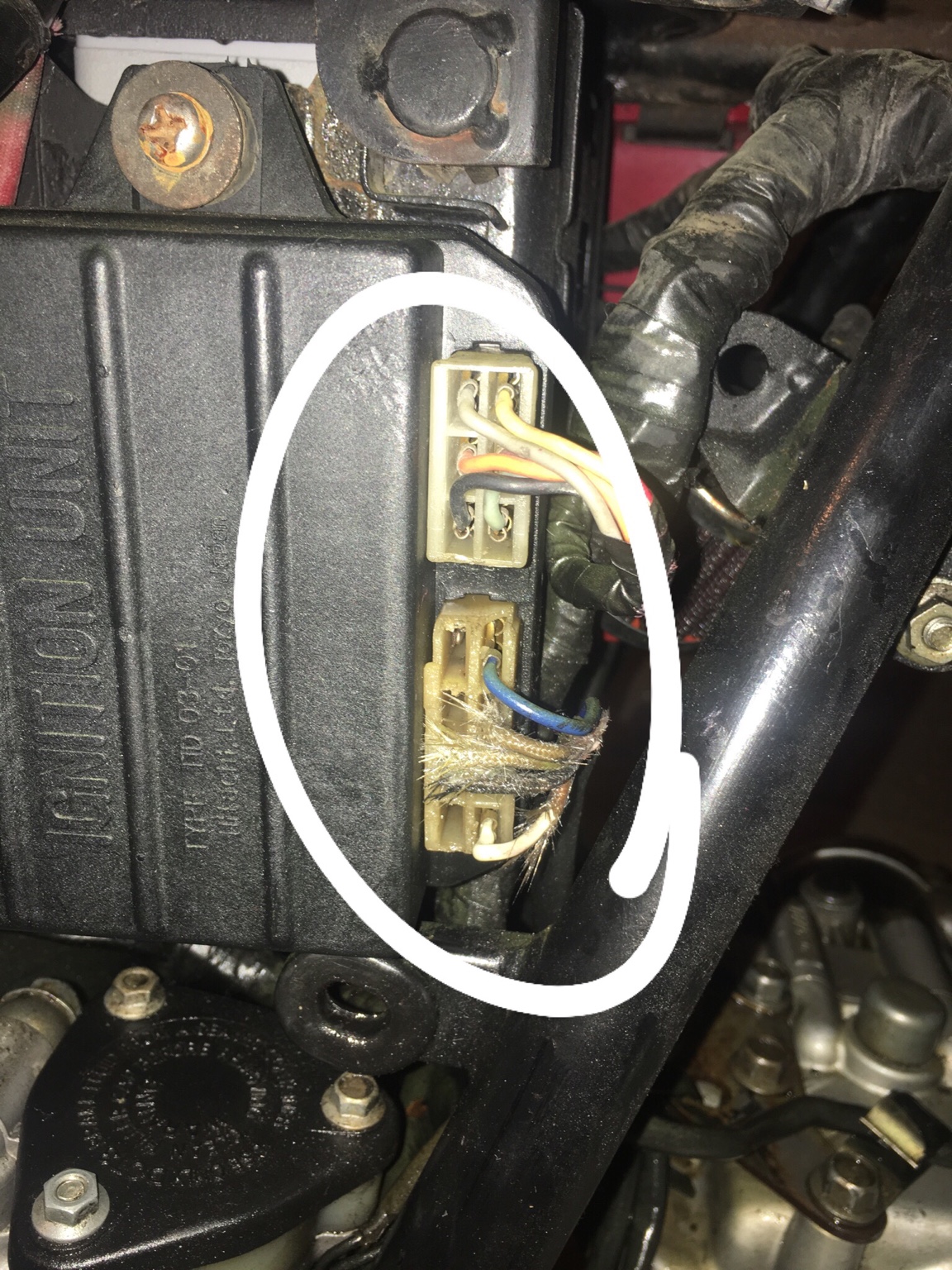

All the left hand side connectors look okay. Should I buy electrical cleaner spray and spray the connectors?

Though the circled section doesn't look too good, either.
