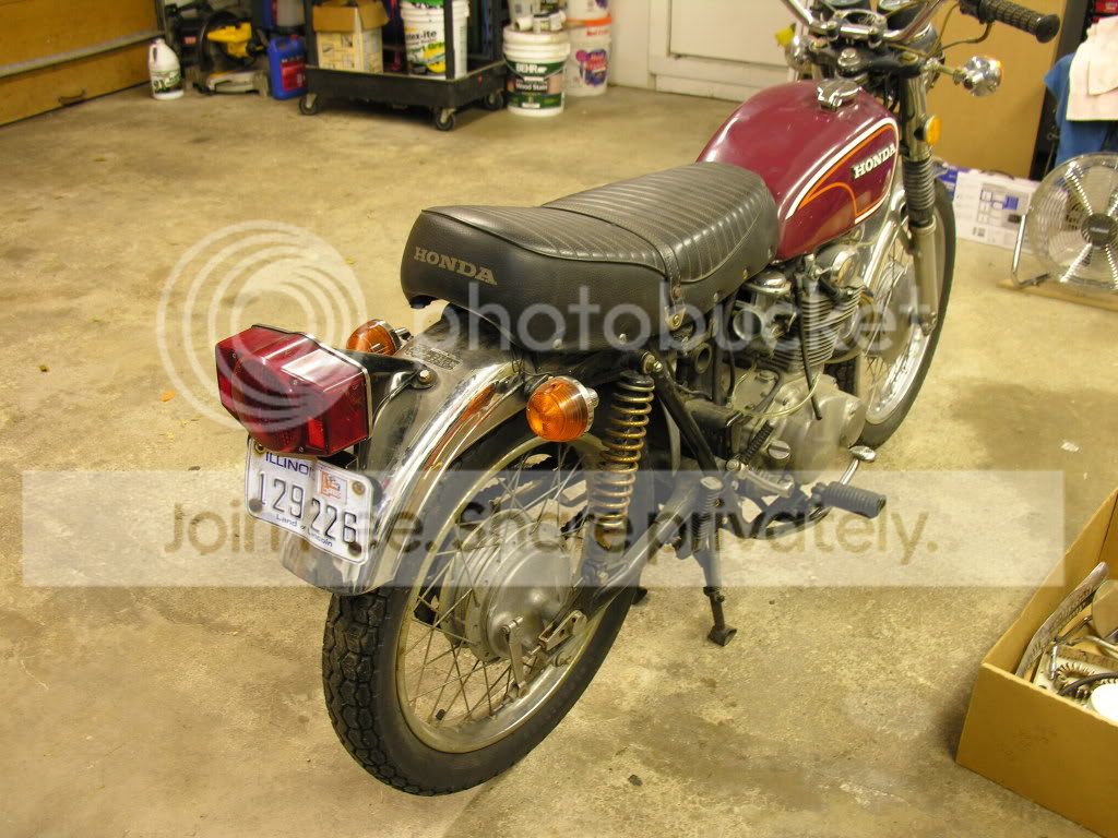

So I thought I would start my first postings with my build. I have been eyeing the cafe style for a while now and decided it was time. I started looking around Craigslist and found a decent one. When I inquired about it, the women that posted it was the original owner. I know what your thinking, yeah right! Well, I cannot tell a lie. It was true. She was the origninal owner and even provided me with the original sales reciept. The title is also from '72. I couldn't believe it!!! The bike is not running right now and has been sitting in her house for ever. She said it ran 5 or so years ago, but not since then. I thought $600 was a good deal considering I plan on doing everything myself. Here are some pics.
Check out the vintage IL plate!

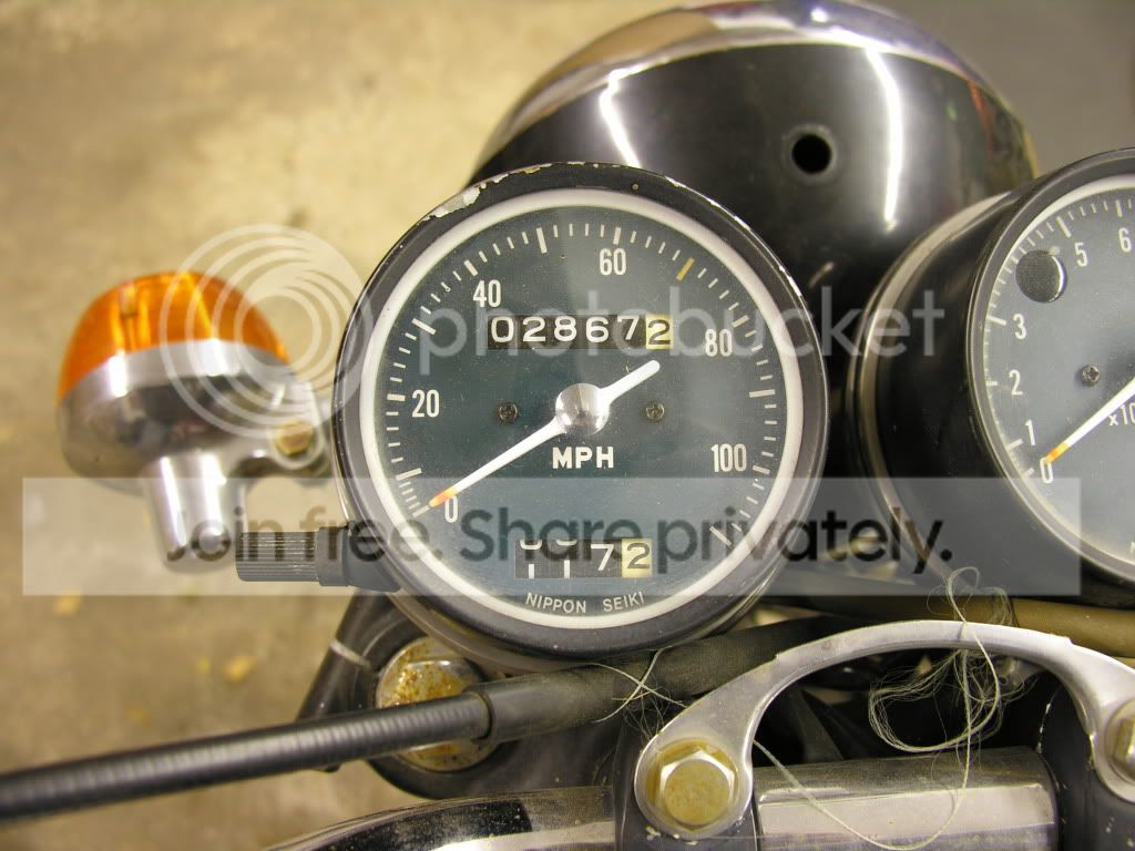

and yes those are the original miles!

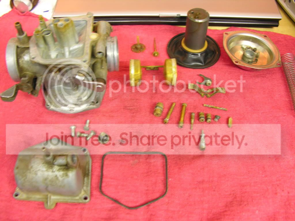

Well I started the work to get it running. I took off one of the carbs tonight and dissasembled it. Here is what I got. Not to bad.

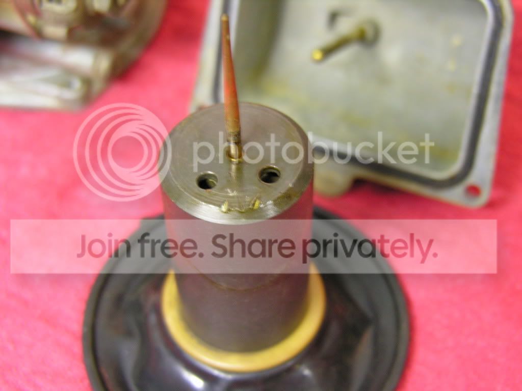

On this one. Notice the little gouges. I'm not sure if this will make a difference when I put it back together so I may just hit it with some 1000 grit to knock it down.
Completely apart
I have a few questions as I haven't rebuilt a carb in over 15 years, is can I drop the whole carb in the cleaner along with all the jets and so forth or is this not recommended? Also, check out the small, what I guess is the rubber o-ring that once graced the jet. Can I just replace it with another o-ring of it's size or do I need special ones? The only one I don't have in my kit is the smallest one pictured here:
Also, the rubber gasket that sits on the float bowl is not in great shape. Is this a part I can buy on it's own or do I have to buy a whole kit?

You can simply replace the small o-ring with one of the same size.
The carb bowl gaskets, the correct ones at least, can be a bit hard to find, but if you find the right size diameter O shaped gasket, you can just get one that is too big, cut it to size, then use gasket sealent to join the two cut ends.
If you are getting carb rebuild kits, you'll probably need to buy jets seperately as the ones in the kits seem to just be randomly tossed in the bags and can be any number of random sizes.
Re: 72 CL350 Build - This is my first so be gentle
Your compression should be at 150 - 160 psi in a perfect motor. If its below 120 psi, youre in trouble. Could be a simple fix, could be a pain in the ass. Anytime a bike sits that long, you should replace every gasket you can. Head gasket, and side covers are easy swaps. Youll need a chain breaker though for the head gasket. You can dip the entire carb, yes... JUST DONT DIP ANYTHING THATS NOT METAL. The cleaner will eat it up.
