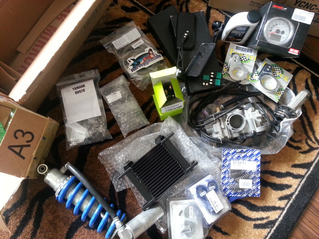

So I got it not complete, not to worried about that as I have lot of left over parts including some good after market items that I decided not to use in the first 920. I have made progress prior to posting it.
Lots of pics coming.

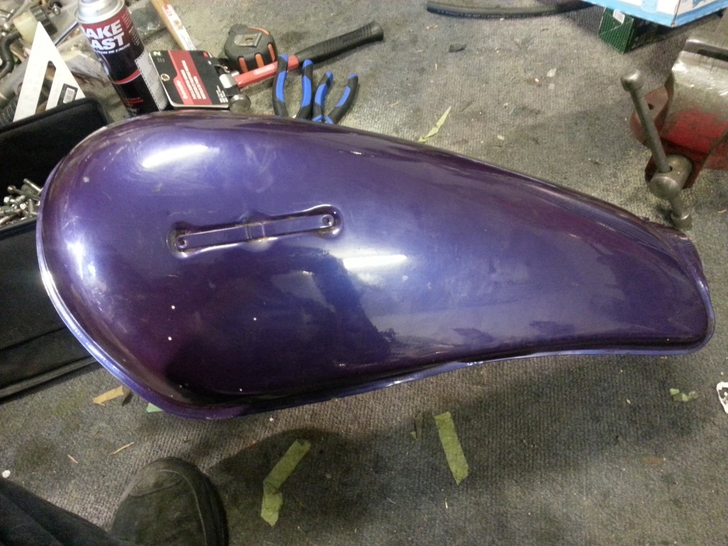

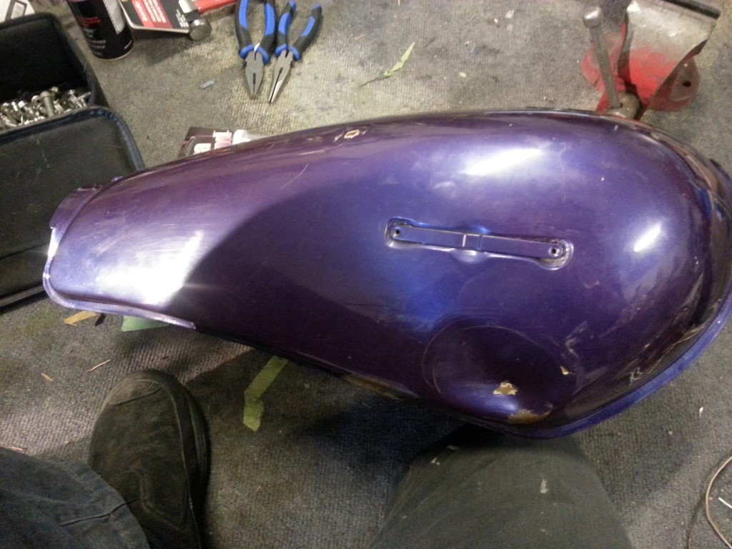

First things first I needed a tank and a seat, I tried about 10 tanks and I couldn't get the right fit or look so I got a xv750 tank and a hot wings seat.
Now the 750 tank is an easy fit but has a slight cruiser flare which will need to be addressed. It also has a big dent. I tried all the tricks and none of them worked. I took it to 3 body shops and non of them wanted to pull it. I have a plan to fix it.

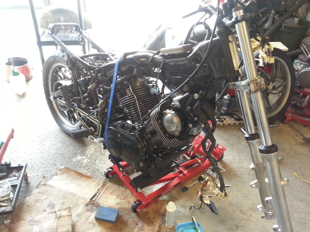

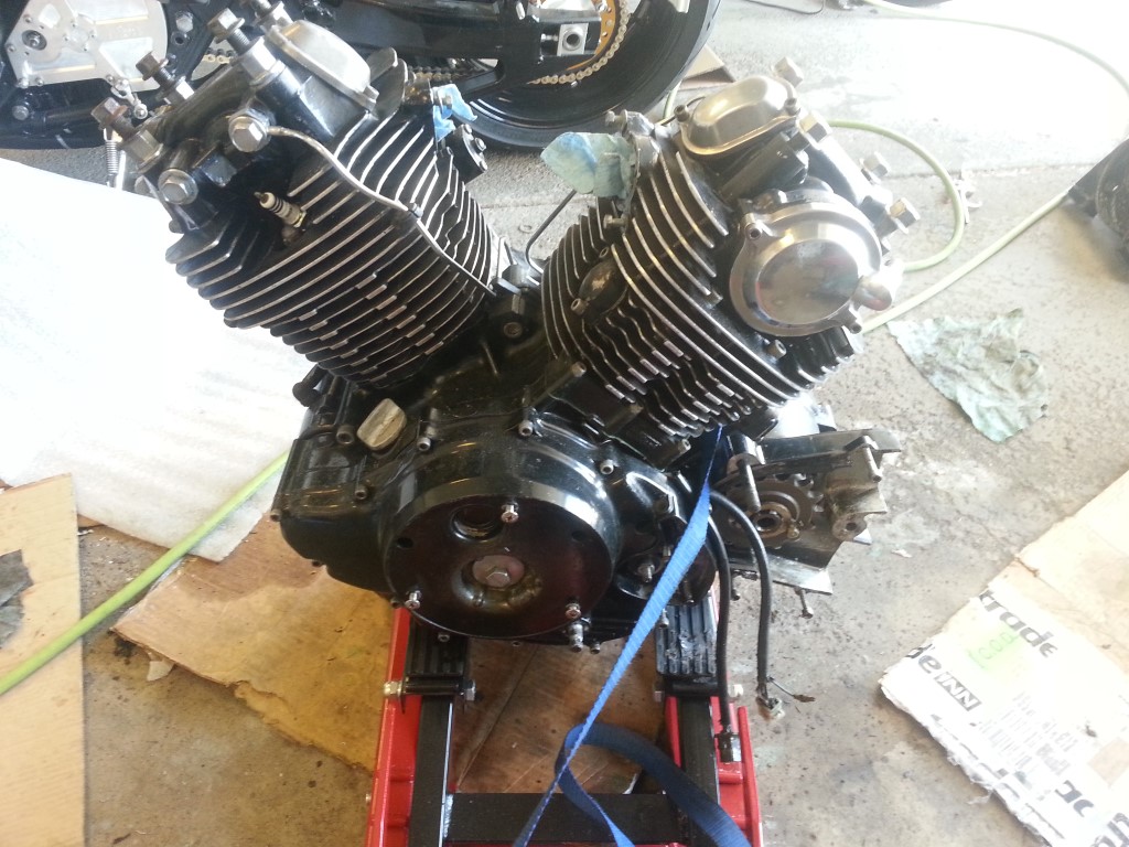

More disassembly it's like I have done this before! ;D
P.S. Removing the enclosed chain is a pita and messy affair getting rid of all that lithium grease.

Ya I had to make it look it clean though, it wasn't as clean as it is now. Here look at the before and after.

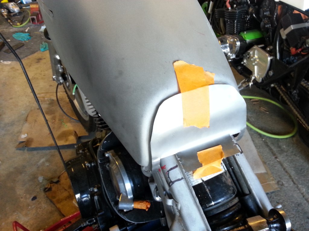

Got the tank to the right height now to start the sub frame. This is the tricky part, getting the new frame tabs aligned properly with a fiberglass seat that overhangs and you don't have access to things, with an open seat this is much easier.
