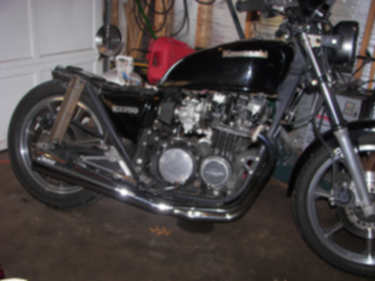

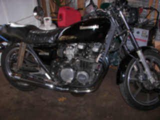

Well we picked up this '82 750 LTD last weekend for my son, he wants to do it bratstyle. Here is our start.

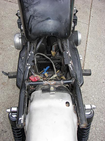

Well we had a pretty productive day today, we got the 16 inch rear wheel on, lowered the battery box, welded on new lower shock mounts and mounted the HD 48 shocks(11 inch), and mounted a yam virago rear fender. here's some pics. The good lookin kid in the pic is the proud owner, our 17 year old son.

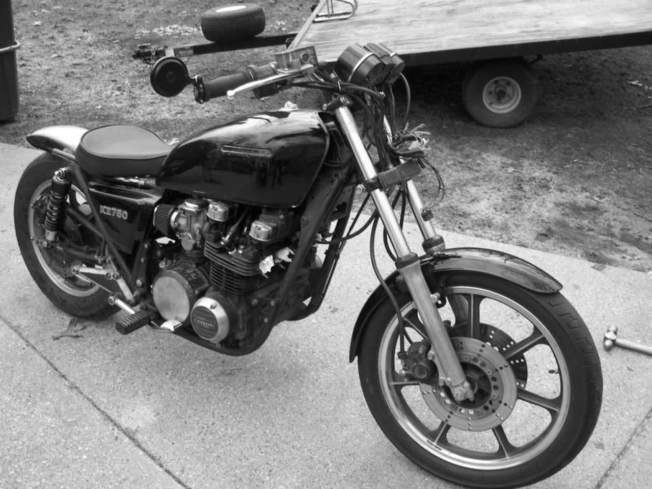

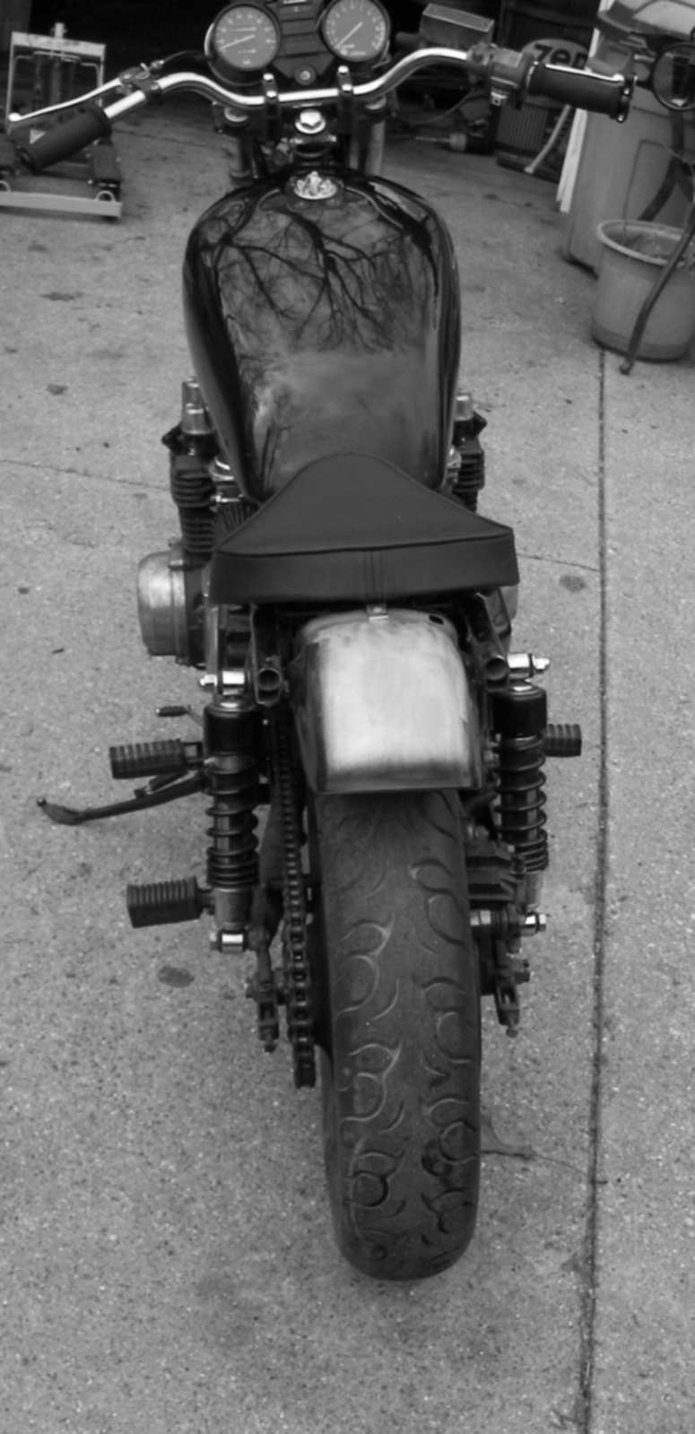

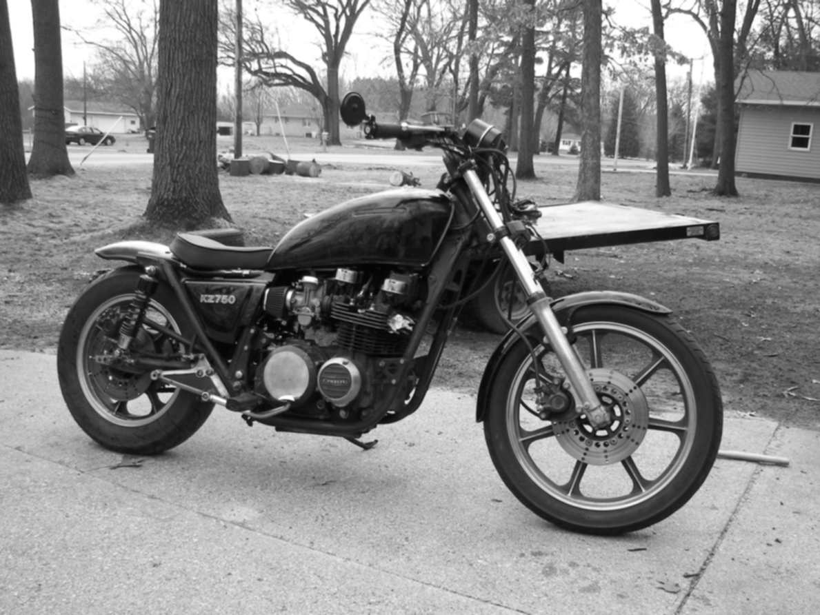

Well I got some update pics and I also need to proclaim that this bike is not an LTD duuh on my part, it is a KZ750 E3. We raked the neck as seen in the pics, we found a solo seat at the swapmeet on Sunday and got it on today. The tank is missing emblems and cap in prep for blasting and painting, paint scheme is top secret but one of the colors is a form of Kawi green. Headlight is off to paint mount brackets, seat is mounted, we should be done in time for our spring run, May 1st. Sorry about the black and white pics, don't know how the hell that happened.............LOL
